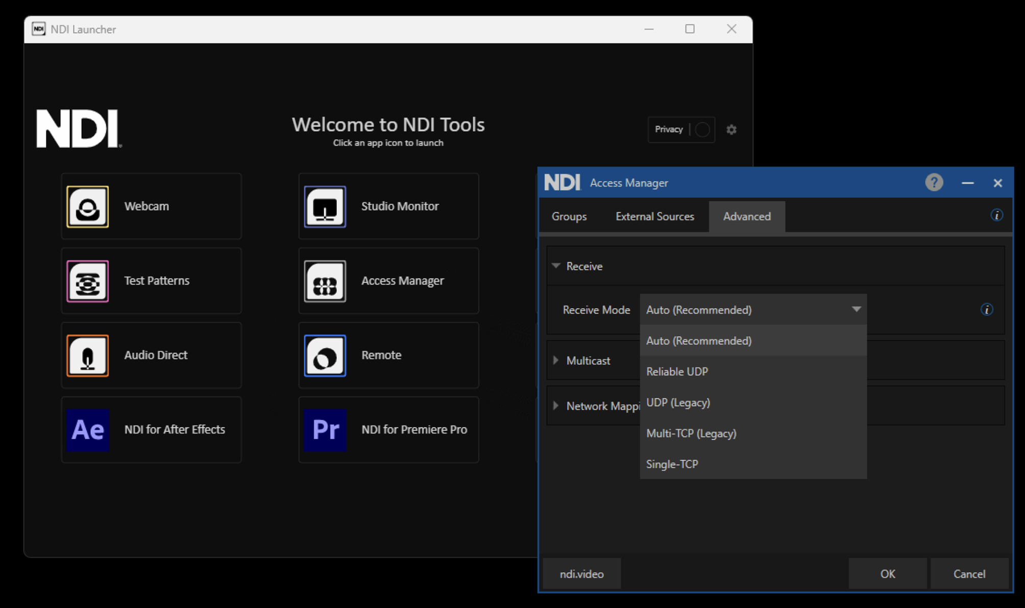

To Configure Received Mode
Configure Received Mode in the NDI Access Manager for all devices involved in the cloud live production.
IMPORTANT
Note: For seamless utilization of NDI Protocols, it is recommended to keep the configuration setting at Auto if you are not sure.
This default mode enables the NDI Protocol to automatically select the most suitable protocol based on the prevailing network conditions, such as port availability and switch configurations, ensuring optimal performance without manual intervention.
