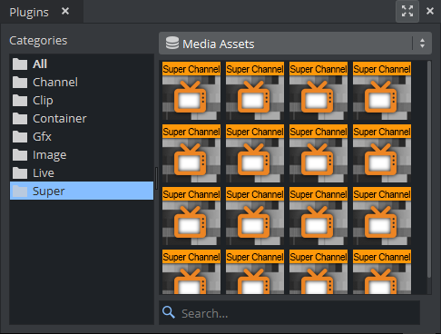

In Viz Artist, find Superchannels in the Plugins tab, under Super:
These channels should be added to the scene through the Presets plugin. The layout (size and position) of the Superchannels in the renderer can be organized manually in Viz Artist. A single set of pre-defined Superchannels layouts is called a preset. When played out, the scene arranges the Superchannels in their previously saved (preset) position.

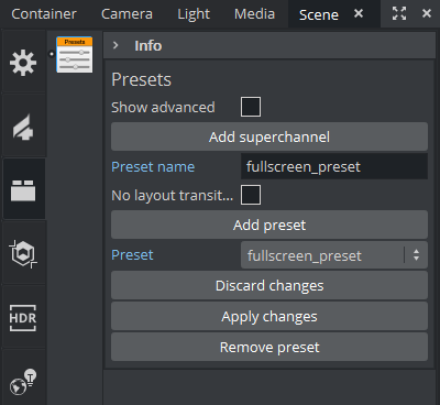

Organizing Presets with the Viz Artist Presets Plugin
Use the plugin to add and organize more presets in the same scene. To create a video wall scene in Viz Artist:
  • Create a new scene.
  • Find the Presets under Plugins > Control > Scene Plugins and drag it into the Plugin section of Scene Settings.
  • Go to the Presets plugin GUI under Scene Settings > Plugin and add, delete or manipulate presets and transitions between them. Each preset gets a name that is later visible to the Viz Multiplay operator, along with a visual representation of the preset.
  • Use the Presets plugin to add superchannels to the scene, as this auto creates content transitions between the sub channels.
The plugin automatically generates directors for:
  • The preset initial position (for a Cut to the preset).
  • Transitions to and from all presets (one director per combination, running forwards or backwards).
  • Content transitions (crossfade, dissolve) between content in each Superchannel.
In the following example, two presets called all-visible and full_screen1 have been added to the scene using the Presets plugin:

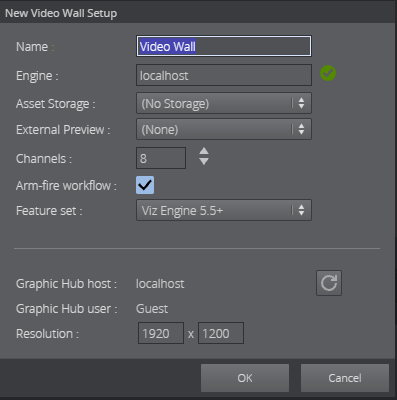

  • Go to Settings > Profiles.
  • Create a profile.
  • Click the Plus button to add a video wall under the Video Walls tab.
  • Specify the host name of the video wall Engine.
  • Select the publishing point used, if you use a Viz One media asset provider. This ensures that clips are transferred from Viz One to the playout engine.
  • Select an External Preview engine.
  • Specify the number of Channels you need.
  • Enable or disable Arm and Fire workflow. This feature is only available if both the Viz Engine and Media Sequencer support it.
  • Select a Feature set. Choose Viz Engine 5.5+ to enable content transitions. See Video Wall Setup.
When you click OK, the following happens:
  • Media Sequencer creates viz and video handlers to communicate with the engine specified.
  • A new design entry is added to the video wall with the same name as the video wall.
  • A new scene is created under Vizrt/Videowall/ in Graphic Hub.
  • A default preset is created inside the new video wall scene.
You now have a Video Wall in your profile (Big Studio Wall), a new scene (Vizrt/VideoWall/Big_Studio_Wall) in Graphic Hub with a default preset.

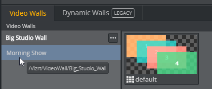

You can rename the design to something more descriptive. Although the design is renamed Morning Show in the screenshot below, it still points to the same scene in Graphic Hub. You can find the scene name and scene path to the video wall scene by hovering your cursor over the design entry in the Super Walls tab:
You can later add more designs (scenes) to this video wall (for instance, one for a morning show and one for an evening show). To do this, click the 3 dots-button to the right of the video wall and select Create new scene. This adds a new scene to Graphic Hub, belonging to this video wall.

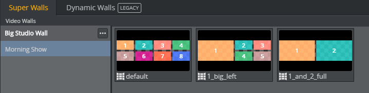

Once a video wall and a scene with a default preset have been created, you can adjust preset positions and add more presets in the Video Wall designer:
  • Click the profile with the video wall engine.
  • Click the design entry under a video wall (Morning Show in the example below).
  • The presets for the scene design are now visible.

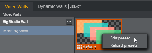

  • Right click a preset and select Edit preset.
  • Now the Video Wall Designer opens. Here, you can add, delete, duplicate and edit presets with the Designing Video Walls tools.
  • When you click Save, the scene and all presets are saved in Graphic Hub through Viz Engine. This means the video wall Viz Engine must be started and On Air. When closing the Video Wall Designer, the updated presets for the design are displayed in the video wall manager:

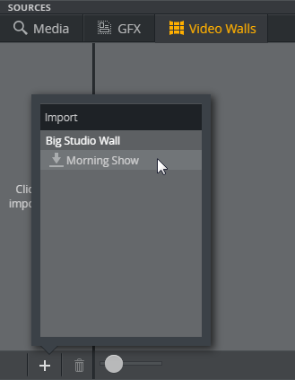

When creating a Show with content, the presets for the Video Wall you want to use in the Show must be imported into the VideoWall tab:
  • Click the Video Walls tab.
  • Click the plus button.
  • Click the video wall design to import the presets.

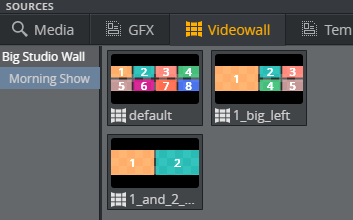

    The presets for the video wall design you imported appears in the Video Walls tab:
    To use the presets, drag them over to the Shortcuts bar.
Note: The recommended workflow is to create one Shortcuts tab per video wall design in order to group the presets belonging to each wall.
