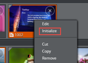

It is also possible to initialize single scenes by right-clicking the thumbnail and selecting Initialize.

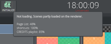

To initialize a show, click the Initialize button. The button shows the status and progress of the loading process:
Icon
Status
Action needed. No scenes are loaded on the renderer. Click the button to start the process.
Not loading. Action needed. Scenes are partly loaded on the renderer, but the loading operation is currently not active. Click the button to restart the process.
Loading. No action needed. The scenes are partly loading, and the loading process is active. Hover your cursor over the button to view detailed progress status.
No action needed. All scenes are loaded into the renderer.
Hovering your cursor over the Initialize button makes a tool tip with more detailed loading progress appear. Note that the colored progress on the Initialize button reflects the aggregated status for the page list and the playlists.

Initialize single graphic elements and filled presets in Viz Multiplay by right-clicking the graphics and selecting Initialize:
Warning: Initializing single elements will likely affect the frame rate on the renderer. Flickering or frame drops may occur.

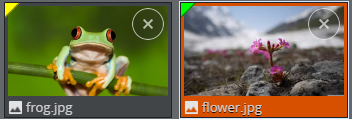

The colored symbols in the upper left corner of the elements in the Media column indicate whether the element is not loaded (gray), partially loaded (yellow) or fully loaded (green) on the renderer.
The initialized status in the Media Pane shows the loaded status for graphics. Clips may remain unavailable even if the graphics are loaded. For filled presets: although there may be a green status for the graphics, some of the clips may still be unavailable:
Clicking the red error mark, or hovering your cursor over it, displays detailed status on the availability of individual clips in the filled preset.

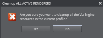

Clean up all output channels and video walls, or a particular wall or channel in a profile using the Cleanup button above. Cleaning up a wall unloads all the resources from the memory of the renderer, avoiding space issues and the inadvertent use of media from a previous session. Cleanup should be done before initializing a new show or in order to re-initialize the same show into the renderer’s memory.
Warning: Cleanup also removes media for all other operators using the Media Sequencer.
  • Clean up the renderer for all channel and walls in a profile. Click the Cleanup button to clean up the renderer for all walls for the currently-active profile.
  • Click Yes in the warning dialog that appears to clean up the renderer for all walls and channels in a profile.

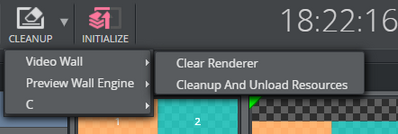

  • Clean up the renderer for a particular wall in a profile: Click the downward-facing arrow in the cleanup button to expose a menu and select the wall you want to clean up.
Note that each video wall and channel has a sub menu with two items:
  • Clear Renderer: The renderer goes black, but this does not unload resources from the Viz Engine.
  • Cleanup And Unload Resources: Unloads all resources from the Viz Engine.

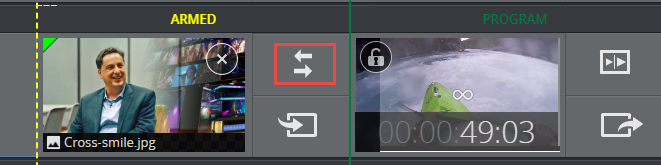

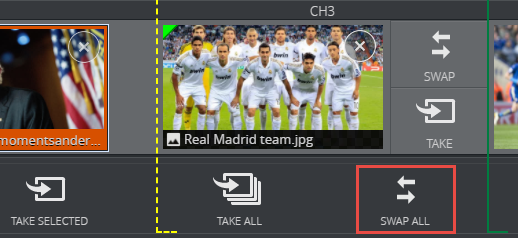

It's possible to test content that you plan to play out on the actual video wall itself.  You can do this by exchanging (swapping) the content in both columns. For instance, the Multiplay operator can prepare a set of media elements in the Armed column for playout when the wall is off air. If the Extra Armed button SWAP has been enabled, you can test the content on the wall by clicking the SWAP ALL button.
Any content currently in the Armed column is played out on the wall, while the media elements currently playing out on the wall move to the Armed column. When the operator sees that everything is okay, a new click on the SWAP ALL button toggles the content back again. The wall resumes playing out the content from a minute ago, and the Armed column contains once again, the media elements that are ready to be played on air.
In this way, the operator can test content on the actual wall.
It is also possible to swap single elements by clicking the SWAP button in the Armed column:
Info: If a channel in Armed does not contain any media elements when SWAP ALL is clicked, the existing content in the channel remains on the Program engine. This ensures that the wall will never go black when SWAP ALL is used.

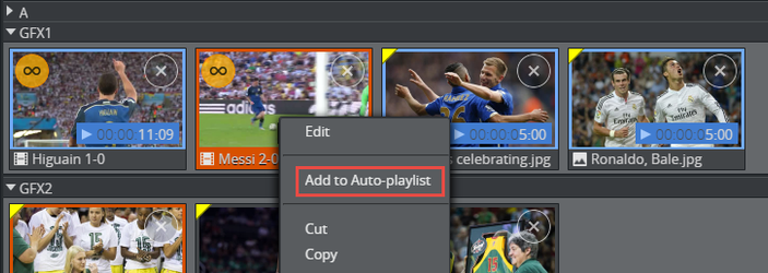

  • Create a group in a playlist where your media elements for the Auto-playlist are placed.
  • Drag media elements into this group. All media element types can be used in an Auto-playlist: Graphics, images, clips, and live sources.
  • Right click each media element (or go to Off Air mode and multi-select media elements) and select Add to Auto-playlist:
Info: Media elements added to an Auto-playlist have a blue duration field and a blue frame to differentiate them from regular media elements. The blue duration field shows how long the Auto-playlist element stays in the renderer until the next element is played. The default duration for media elements is 5 seconds where no other duration has been specified.

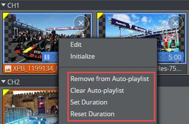

Editing and clearing items in an Auto-playlist
  • Remove an item by selecting Remove from Auto-playlist on the context menu. Note that this does not delete the playlist item, it only removes it from the Auto-playlist.
  • Remove all items by selecting Clear Auto-playlist.
  • To set a new duration for clips in auto-playlist: Edit the clip and set a new mark in and/or mark out. The new duration of the clip is used as the duration in the Auto-playlist.
  • To set a custom duration for other media elements in auto-playlist: Right click the element and select Set Duration. A dialog pops up prompting you to enter a number in seconds.
  • To reset the duration back to the default duration in auto-playlist: Right click the element and select Reset Duration. The default duration for clips is the actual clip length between Mark in and Mark out. For images with an image effect, the default duration is the image effect duration. Although graphics may have a specific duration (for instance, if the graphic is a continuously running animation), graphics with stop points do not have a specific duration. All media elements added to an auto-playlist have a 5 second default duration if no other duration is specified.

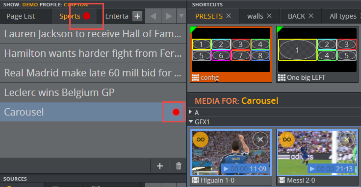

  • If a playlist contains a group with an Auto-playlist, a red blinking light at the top left indicates that it's running:
To stop an Auto-playlist, right click the Program column and select Stop Auto-playlist, or take the current element Out.
