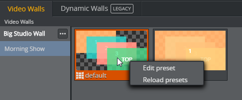

  1. Go to Settings > Profiles, and select the profile containing the video wall to edit.
  2. In the Video Wall manager, the different video walls and their associated Viz Artist scenes are now listed.
  3. Right click a preset and select Edit Preset.
If the preset scene has changed (for instance when a designer changes the scene in Viz Artist), select Reload presets to display the latest changes.

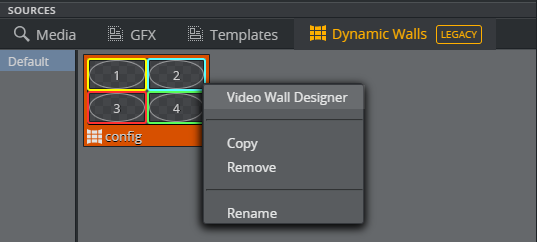

Legacy Video Walls
Right-click a preset in the Videowall Tab in the Sources area and select Video wall Designer.

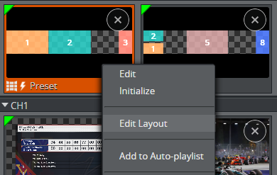

Opening the Preset Layout Editor
To edit an individual Preset element’s layout, Viz Multiplay offers a trimmed down version of the Video Wall Designer. It is available by right clicking on a Preset element in a Show and selecting Edit Layout from the context menu.
The Preset Layout Editor focuses on editing a single Preset element, therefore, some of the components from the Video Wall Designer are not available in this mode.

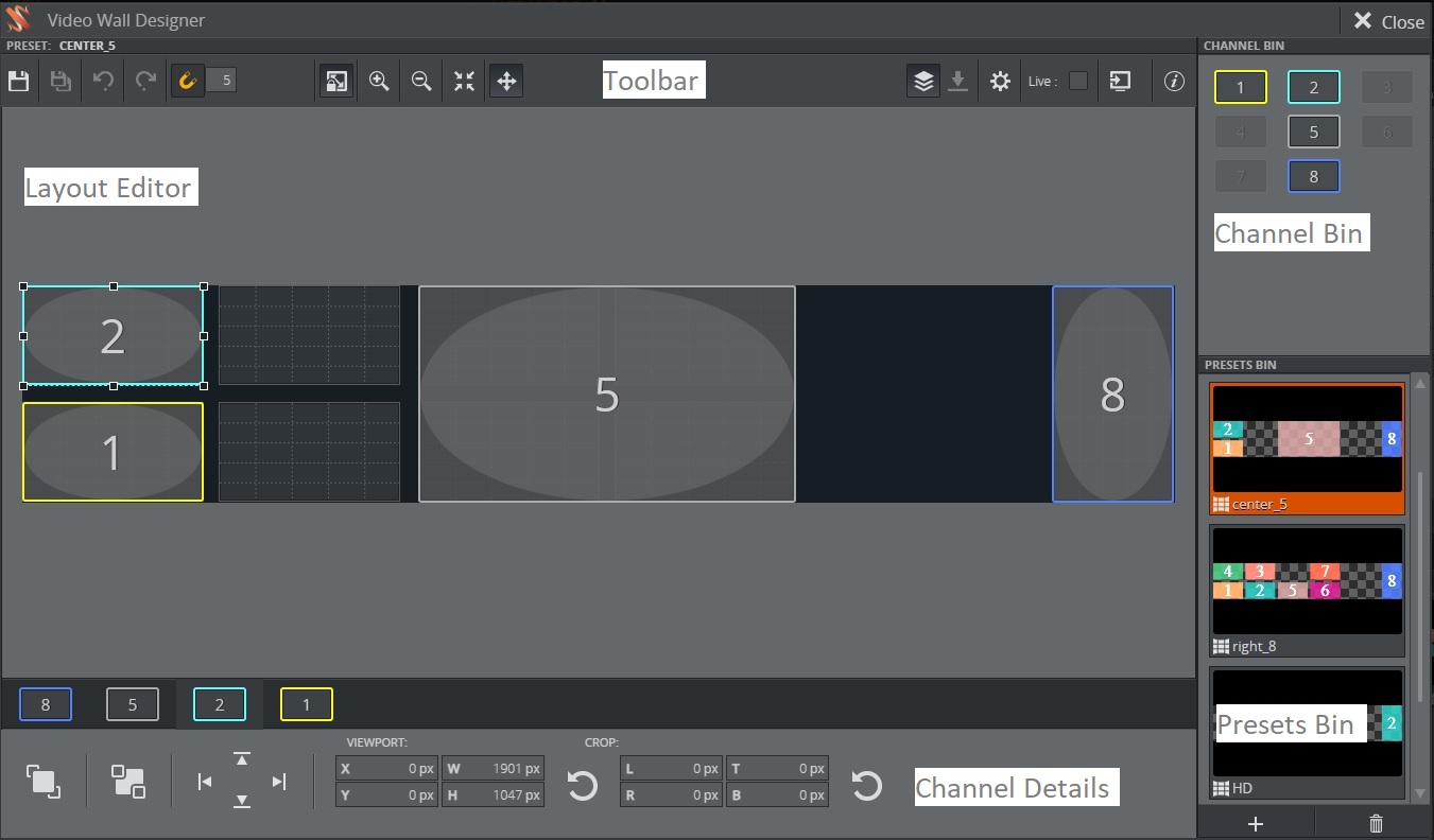

Video Wall Designer Layout
The Video Wall Designer is organized into the following areas:
The backdrop of the Video Wall Designer layout is called the Active Areas Editor.
Toolbar

Channel Bin
Click an item in the Channel Bin to turn it on or off in the Layout Editor. You can also drag channels from the Channel Bin to the video wall.

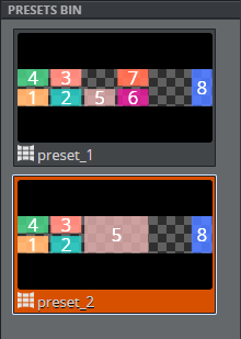

Presets Bin
The Presets Bin lists the Superchannel presets which are available in the current preset group. The Preset Bin is not enabled for Legacy Video Walls.
In the Presets Bin you can:
  • Add or delete presets.
  • Click on the preset to open it in the editor.
  • Double-click the name to rename it.
Note: If the preset or element is shown in a playlist in Viz Trio, the name given in Viz Multiplay is shown in the Description column in Viz Trio.

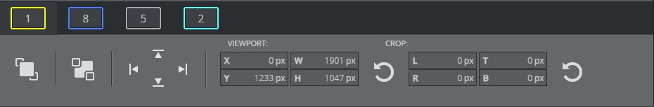

Channel Details
For each channel, you can modify the Layer Order, the position by using the Snap buttons or adjusting the Viewport, or add Crop settings.
Layer Order
  • Bring to front / Send to back: Move the selected channel to the front or back. This changes the order in which items are layered, from front to back. Each channel is drawn on its own layer, which means all channels are independent and can be moved on top of, or behind, other channels.
    A dashed line indicates that a part of the channel is behind another channel.
  • Change layer order by dragging the channels: The left most channel box appears on top. Drag the channel box to reorder the Z-order of the channels.
Snap
If Snapping is enabled, these buttons can be used to snap the selected channel to the nearest line up, down, left or right.
Viewport
Position of the channel frame relative to the video wall. Either type inside the text boxes, or drag your mouse to change the values.
  • X/Y: Position of channel’s top-left corner given in the wall coordinates specified in the Video Wall Dialog. These coordinates can be pixels.
  • W/H: Width/height of the channel’s frame given in the wall coordinates specified in the Video Wall Dialog. These coordinates can be pixels.
  • Reset: Resets the Viewport values to relocate the channel to the first Active Area of the video wall.
Tip: When a channel should not be visible - do not hide them by making them invisible. Instead, shrink the size to 0 (zero) and/or place them outside the visible video wall. The Viz Engine performance can be better when all channels are visible. All channels should be colored in the Channel Bin.

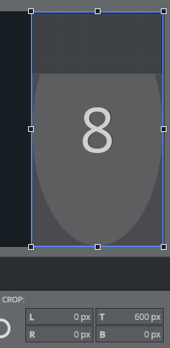

Crop
Position of the content of the channel relative to the content size. With this control you can perform cropping, shifting and zooming. Any part of the frame which is not filled with content, is transparent. Alternatively, use the Crop Editor to make these changes.
The Crop values in the channel tabs control the cropping. Either type inside the text boxes, or drag your mouse to change the values.
  • Left / Right / Top / Bottom: Number of pixels to be cropped out.
  • Reset: Resets the Crop values to (0,0,0,0), so that the content fills the frame.
Tip: Adjust the Snapping and Keep aspect ratio settings in order to achieve the precise crop you require.
Example
In this case, the user has set the crop values so the top 600px does not show.

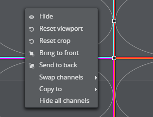

Context Menu
Right-click a channel to access the context menu:
  • Hide: Hide this channel from the video wall. To show it again, choose it in the Channel Bin, either by clicking it or dragging it from the Channel Bin onto the video wall surface.
  • Reset viewport: Reset Viewport to the first Active Area.
  • Reset crop: Reset Crop to (0, 0, 0, 0).
  • Bring to front: Put this channel in front of the other channels. See Layer Order.
  • Send to back: Send this channel behind the other channels. See Layer Order.
  • Swap channels: Select another channel with which to swap all Viewport and Crop values.
  • Copy to: Copies the size and crop values from the channel that was clicked into the channel selected on the context sub menu.
  • Hide All Channels: Hide all channels.

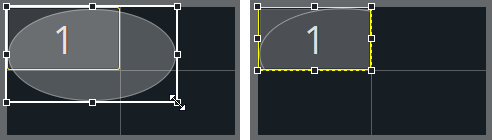

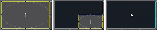

Crop Editor
Double-click a channel frame to allow dragging and resizing the channel content, relative to the frame. In this mode, aspect ratio is forced on. Press ESC, or double-click the channel, to exit this mode. Any part of the frame which is not filled with content, is transparent. Alternatively, use the Crop values in the channel tabs to make these changes.
Example
In the image below, the user has double-clicked Channel 1 to enter edit mode. They have dragged the handle (left-hand image) and then pressed ESC to see the final result (right-hand image).

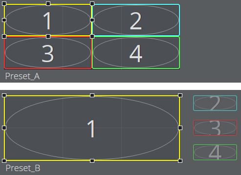

Example 1
When switching from Preset_A to Preset_B (see diagrams below), channels 2, 3 and 4 become smaller and sweep to the right, off screen, and channel 1 stretches to fill the whole video wall.

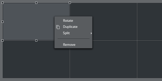

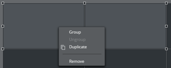

    When right-clicking an Active Area, the context menu contains:
    1. Rotate: Rotates the active area 90 degrees. Free rotation is not supported. The content on the wall is not rotated. Only the aspect is changed.
    2. Duplicate: Duplicate the active area.
    3. Split: Split the active area into 2 or 4 new areas.
    4. Remove: Removes the active area.
Tip:
  • Use the live function to play out either the existing content of the corresponding GFX channel in the Active Areas - or a fill color. This is useful when a part of the renderer output should be mapped to a physical screen.
  • Use the arrow keys to fine tune a position.
Active areas can be grouped by clicking and CTRL+ clicking areas, and right-clicking on one of the areas:
Create a group of the selected areas. The areas can be moved, resized and deleted as one unit. The group number is located at the bottom of the editor:
The highlighted numbers indicate whether a group or an individual Active Area is selected. To toggle between individual selection and group selection - click the active area. Keep an eye on the highlighted numbers and the selection markers around the active areas to see whether the selection contains a group or an Active Area.
