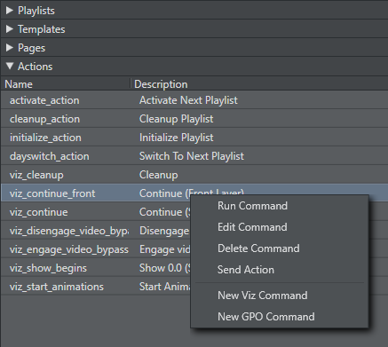

  1. Click the Actions button The list of predefined commands is displayed:
    images/download/attachments/58345740/userinterface_actions.png
  2. Right-click one of the actions and from the context menu select New Viz Command or New GPO Command
  3. In the dialog box enter:
    • Description is the descriptive term that is seen in the Actions list, as well as any drop-down list in the Rules and GPI settings panels.
    • Command is the actual command line sent.
    • Name is a pre-generated name based on type selected (for example viz_newcommand) that is verified as unique upon generation and may be changed into something more descriptive. Name is the value used for scheduling (as “page name”’).
  4. Click OK.
