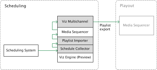

A typical installation includes one Viz Multichannel and a local Viz Engine. In addition you typically install Viz Multichannel’s Schedule Collector (SCC) and Playlist Importer (PLI) in order to collect and import playlists through mapping settings into Viz Multichannel.
Viz Engine is used for preview and is typically a VGA version without SDI out capabilities. This setup allows the Scheduling Center to prepare and preview playlists before sending them to playout by the program Viz Engine(s).
The following software components are in use:
-     Viz Multichannel client
-     Viz Multichannel’s Schedule Collector (SCC)
-     Viz Multichannel’s Playlist Importer (PLI)
-     Viz Engine (local preview)
-     Media Sequencer
Installation for Scheduling
The machine in the Scheduling must have the following software components installed:
-     Media Sequencer
-     Viz Engine (preview) IMPORTANT! Ensure that clocks on all machines in the installation are synchronized! It is also recommended to set all date formats on all machines to the same format.
