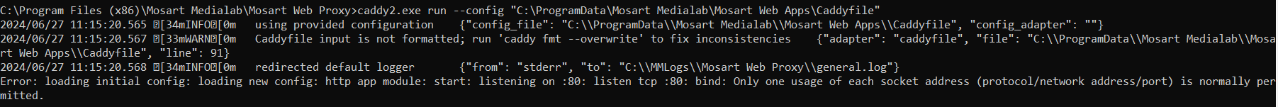

Start the Mosart Proxy Service in console
If the Mosart Web Proxy service fails to start and there is little information in either the proxy logs or the browser, you can start Caddy in the console to troubleshoot the problem using the following command. If this is running as a Windows service, stop it first.
C:\Program Files (x86)\Mosart Medialab\Mosart Web Proxy>caddy2.exe run --config "C:\ProgramData\Mosart Medialab\Mosart Web Apps\Caddyfile"
Typical situations are where Caddy fails to start because the port (default 55142 for HTTP and 55143 for HTTPS) is already in use by other applications or the certificate and/or the key files configured are not valid:

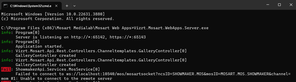

Start the Mosart Web Applications Service in console
If the Mosart Web Applications service fails to start and there is little information in either the web server logs or the browser, you can start the service in the console to troubleshoot the problem. If this is running as a Windows service, stop it first.
Typical situations are where the web server fails to start because the port (default 65142 for HTTP and 65143 for HTTPS) is already in use by other applications or the certificate and/or the key files configured for HTTPS are not valid.

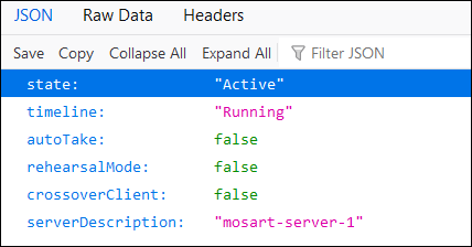

Check the status of the Viz Mosart server
In a browser, paste the URL to the Viz Mosart server status endpoint:
HTTP
http://<mosart-server-host>:55167/status for HTTP
HTTPS
https://<mosart-server-host>:55168/status for HTTPS
Using a Web proxy
http://<webproxy-url>:55142/mosart/main/status
Note: In the first two examples above, replace <mosart-server-host> with the hostname, IP address or the FQDN of your Viz Mosart server.
Info: /status needs no credential, even when the Mosart server runs with authentication enabled, so it stays usable as a health check. The versioned alias /api/v1/status does require one.
You should get a result similar with the following (serverDescription is not available in older Mosart versions):

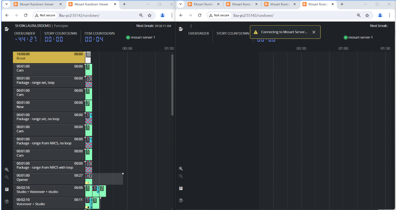

Slow loading or a client limit in the live apps
If you experience the following issues with the live apps (Rundown Viewer, Smart Panel, Prompter):
  • The content loads slowly or only partially.
  • You cannot open more than 5-6 web sessions, meaning that opening the web application in multiple browser tabs or instances fails after 5-6 clients.
These problems may indicate that HTTPS is not properly configured across all relevant components.
In the screenshot below, the 6th Rundown Viewer client displays an error connecting to the Mosart server, while the other clients are functioning correctly:
Troubleshooting Steps:
  1. Inspect Browser Logs:
    • Open the browser's Developer Tools and go to the Network tab.
    • Inspect some of the URLs. For example, you might see a request URL to the Mosart Server like http://proxy-server:55142/mosart/mosarthub/negotiate?name=MosartWebUI&negotiateVersion=1.
    • A "307 Temporary Redirect" status code indicates that the resource has been temporarily moved to a different URL. This suggests that the proxy server (Caddy) has redirected the client to use HTTPS instead of the original HTTP request.
  2. Understand the issue:
    • In this example, the client (the Rundown Viewer in the web browser) initially made a request over HTTP to the Mosart server, but the proxy server redirected it to HTTPS.
    • This indicates that HTTPS is configured for the Mosart server but not for the Mosart web server and the proxy server.
    • By default, the Mosart Web Proxy is configured to enforce HTTPS by redirecting HTTP requests to HTTPS before they reach the Mosart server, if the Mosart server is set up with HTTPS.
  3. Fix the problem:
    • To resolve this issue, enable HTTPS for the Mosart web server and the proxy server (internal or external) using the Mosart Web Apps Configuration Tool.
