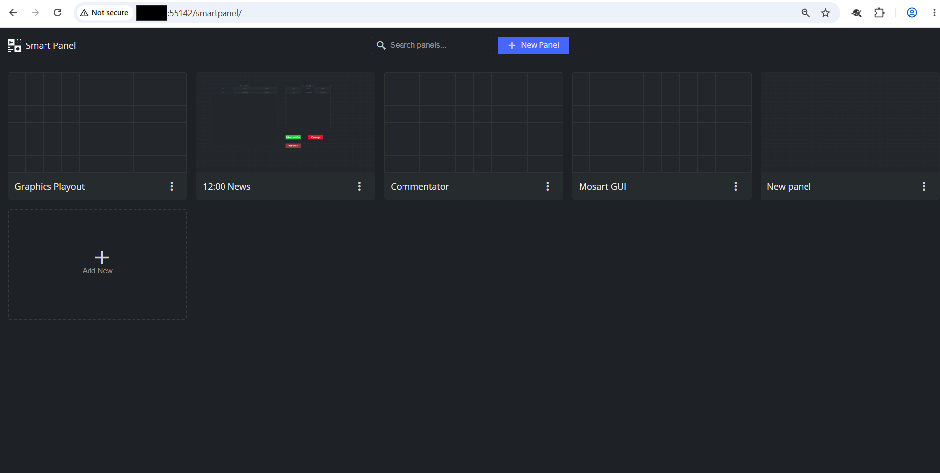

Managing Panels
All panels live on the Mosart Web Server side, so anyone who can reach the Smart Panel URL sees the same list and works on the same files.
The landing page (/smartpanel) is the entry point for panel management.
Smart Panel ships with a small library of read-only preset panels (newsroom, multiviewer, commentator, etc.). Presets are not shown on the landing page and cannot be edited in place, they are available only as starting points in the New panel picker. Anything you create or duplicate from them is a normal, editable panel owned by your team.
From the landing page you can:
  • Create a new panel. Click New panel to open the panel picker. Choose Blank panel to start from an empty canvas (pick an aspect ratio here, since there are no widgets to suggest one), or pick one of the built-in preset panels (Mosart GUI, Multiviewer, Status Dashboard, Graphics Playout, 12:00 News, Commentator, Timing Display) to begin with a ready-made layout. Give your new panel a name and click Create. Smart Panel then opens it in the Editor as a standard, editable panel. The original preset stays untouched.
  • Duplicate a panel. Use the per-panel menu on the landing page to clone one of your existing panels with a new name. To start from a preset instead, use the panel picker in New panel (see above); presets do not appear in the landing-page grid and cannot be opened or edited directly.
  • Open a panel for editing. Click the panel name/card (or the Edit action) to open it at /smartpanel/<panel>/edit.
  • Open a panel for use on air. Use the View action (or just navigate to /smartpanel/<panel> without /edit) to open it full-screen in view mode (no possibility to edit).
  • Rename a panel. Open it in the editor and click the panel name in the app bar.
  • Delete a panel. Use the per-panel menu on the landing page. Deletion is permanent and removes the panel for every operator, so confirm before deleting a panel that may be in use.

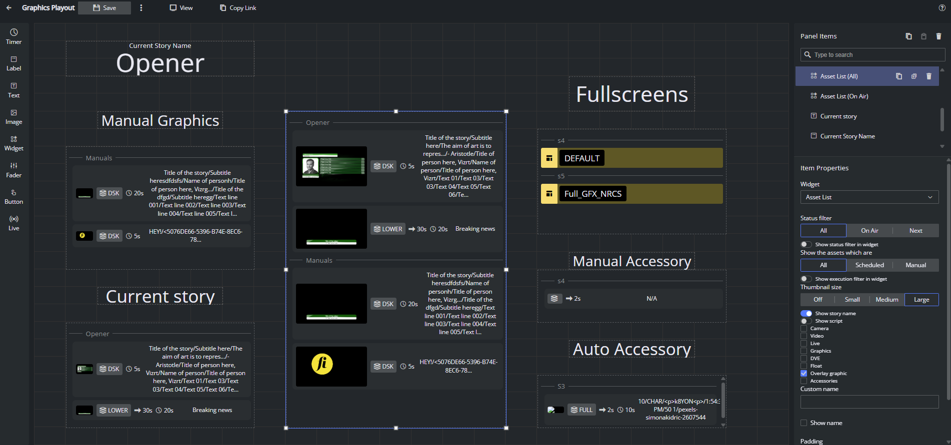

Designing the Panel

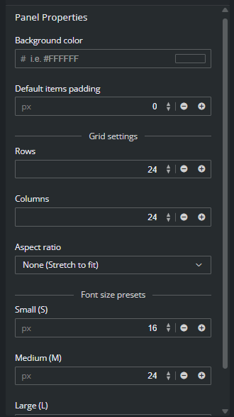

With no item selected, the right panel displays Panel Properties. These settings apply to the canvas and govern the entire panel.
Panel Properties
Property
What it controls
Aspect ratio
The shape of the canvas. Pick a preset (16:9, 9:16, 16:10, 4:3, 1:1, ultra-wide, phone variants), a Custom ratio, or pick None to stretch to fit the browser window. Match this to your target screen so that the panel looks right on air.
Grid (rows × columns)
How finely the canvas is divided. The default 24 × 24 suits most panels.
Increase for fine-grained panels; decrease for chunky touch buttons. Items snap to cells.
Background color
Solid color behind all widgets. Pick something that contrasts with your item colors and is comfortable to look at during a long show.
Default padding
Padding applied to new items. Individual items and sub-widgets can override this with their own properties.
Font-size presets
Three named font sizes you can refer to from any item. Set them once here, then pick S, M, or L on an item, instead of typing individual pixel values.
Changing a preset updates every item that uses it.
Working with Panel Items

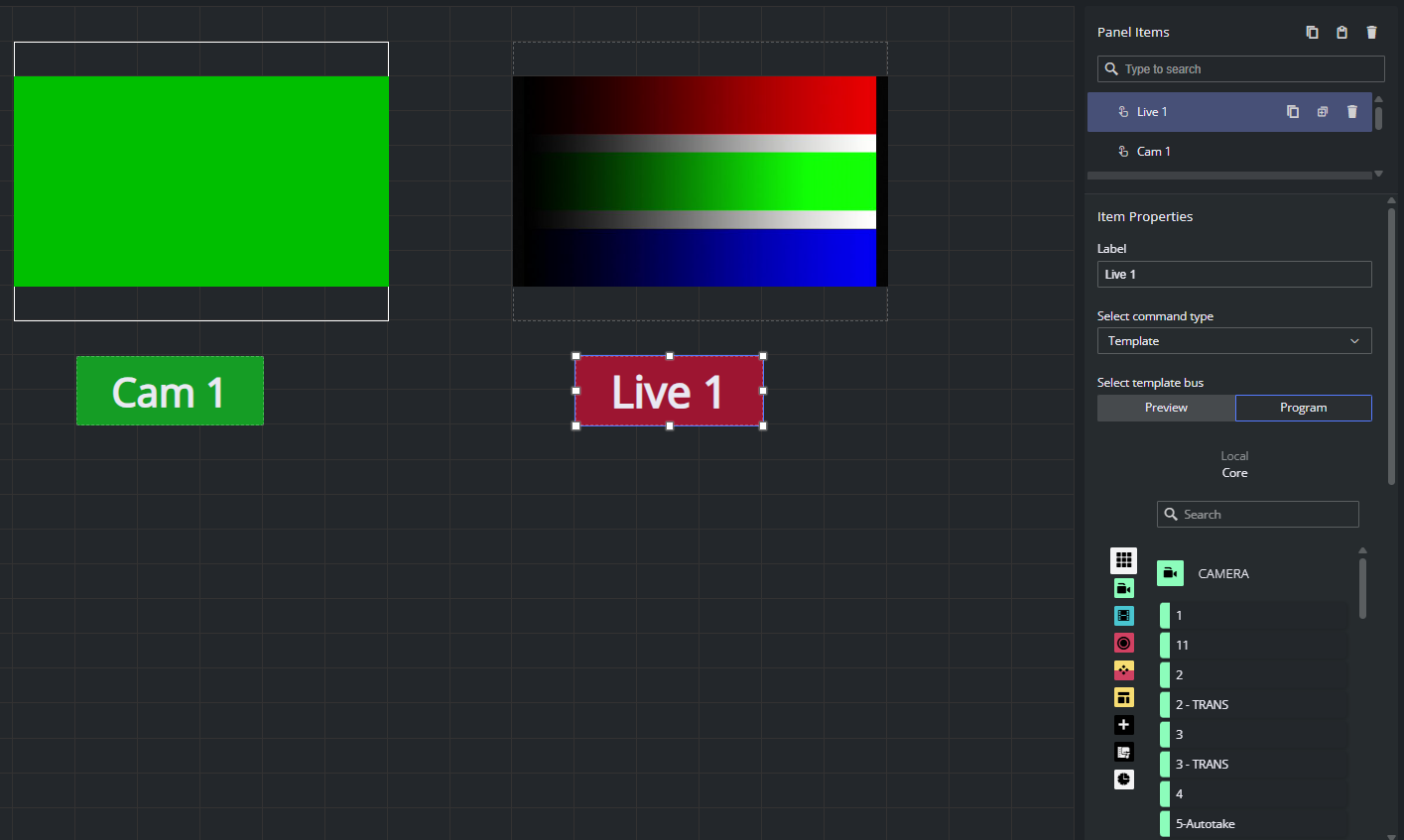

Panel items are the building blocks of a smart panel. The palette on the left border has eight item types (see Item Reference below). For all types, you work with them in the same way on the canvas.
Adding an item. Click the required item type from the palette. The cursor holds a preview. On the canvas, click an empty cell to drop the item. Smart Panel places the new item and displays its characteristics in the panel Item Properties.
Selecting an item. Click it on the canvas, or its entry in the Panel Items list, top right. The selected item displays its handles, and the Item Properties panel populates with individual details.
Moving and resizing an item. To move, drag the item body. To resize, drag a corner or edge handle. The item snaps to the grid, as defined in Panel properties.
Panel Items list. Every placed item appears in this searchable list. Use it when:
  • Added items overlap and you need to select one underneath another.
  • The panel is busy and you want to jump straight to a specific element by name.
  • You want to confirm at a glance what is on your panel.
Tip: Give your item a descriptive name in Item Properties (for example Take button, Story countdown). These names display under Panel Items, so naming as you go pays off quickly as the panel grows.
Deleting an item. Select, and press the Delete key, or the corresponding Delete icon in the Panel Items list (top right).

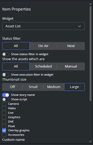

Widget
Category that hosts built-in Mosart sub-items (Timeline, Story Script, Current Item Type, Next Item Type, Connection Status, Iframe, Device Statuses, Audio Toggles, Asset List, Video Transition).

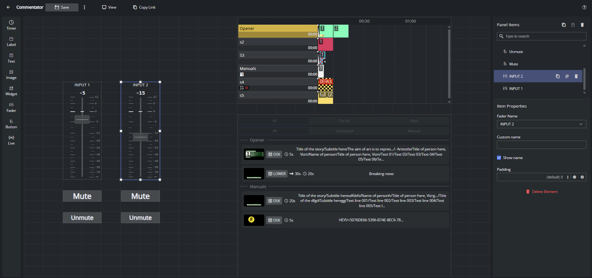

Fader
Audio fader bound to a Mosart audio source. Drag the bar to change on-air level.

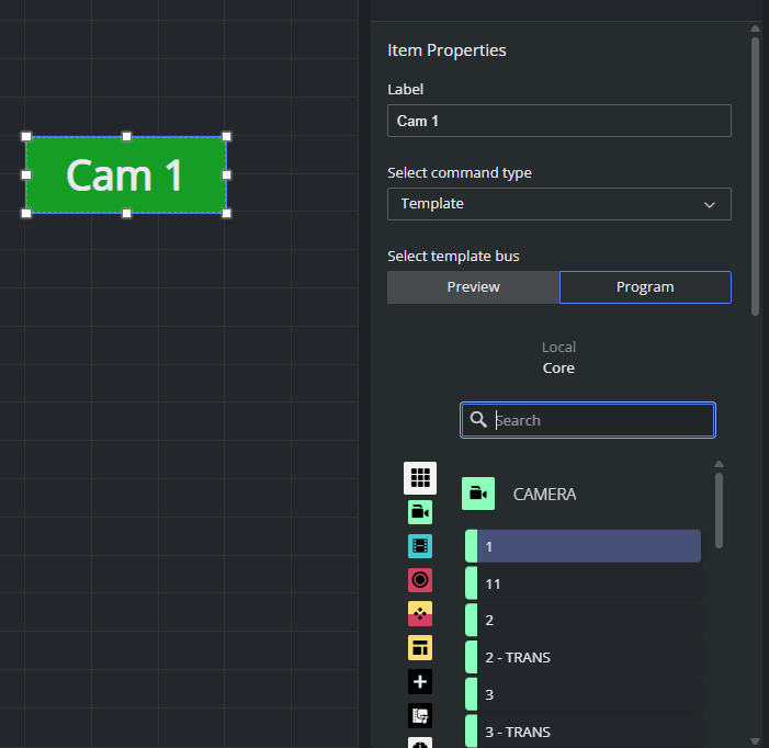

Binding Buttons to Viz Mosart Commands
Buttons are how operators drive Viz Mosart from a Smart Panel. Each button has a Command type that governs what it does when tapped.
Template buttons. A Template button takes a Mosart template (camera, graphic, package, etc.) on the chosen output.
  1. With the button selected, set Select command type to Template.
  2. Set Select template bus to Program (take on air immediately) or Preview (cue to preview).
  3. Open the template picker and choose a template that the button will fire. The picker lists all templates available to Viz Mosart.
Built-in command buttons. Built-in commands cover the standard Mosart actions that are not template takes, like cue, transition, audio toggle, overlay control, timeline control. Pick the command from the Command type drop-down. The properties pane shows the parameters that command needs.
Confirm before send (optional). For destructive or irreversible actions, enable the Confirm option in the button's properties. The operator sees a confirmation prompt before the command is sent.
Visual feedback. Use colors and label to make the button's purpose obvious at a glance.

Asset List
Filtered list of story assets (cameras, videos, graphics, etc.) for the on-air or upcoming stories, with thumbnails and rich filtering.

Example of a graphics playout panel with several Asset List widgets showing manual overlays, overlays on the current story, fullscreen graphics, and all graphics in the rundown:

Fader
Audio fader bound to a Mosart audio source. The operator drags the bar to change the level on air. Renders as a vertical bar with the source name at the top and the current level in dB at the bottom (shows -∞ when at the floor).
Use it for any audio source the operator needs continuous control over: presenter mic, music bed, remote feed level.
Here is an example of a Commentator panel: each commentator input has a vertical Fader widget with a live dB readout, plus Mute and Unmute buttons wired to the matching audio commands. Name each fader after its source (INPUT 1, INPUT 2, …) so operators can tell at a glance which channel they are riding.
Type-specific properties (in the order they appear in the pane):
  • Fader Name. drop-down populated from the live audio-channel list. The list contains exactly the channels Mosart Server is currently reporting (via onAudioChannels and onAudioLevel). In Offline Mode the drop-down is empty, so audio sources can only be bound when Mosart is reachable.
Plus the common properties

Button
The main interactive item. Sends a Viz Mosart command when tapped. Renders as a labelled button on the canvas, styled with the full color and font stack.
Use it for taking templates on Program or Preview, driving the timeline (reload, start, skip, start-from-top), and firing built-in Mosart control commands such as autotake, direct take, overlay graphics, audio actions, video-server goto, and the dozens of other commands the server exposes.
  • Label. The text shown on the button face. Defaults to Button. Keep it short and unambiguous (TAKE, CUE, CAM 1).
  • Select command type. Drop-down with exactly three values: Template (default), Timeline, Control Command. The fields below the drop-down change based on the choice.
  • Select template output (Template only). Radio: Preview or Program (default). Determines which output the template is taken on.
  • Template picker (Template only). A panel that lists every Mosart template by category (CAMERA, PACKAGE, VOICEOVER, OS, GRAPHICS, VIDEO EFFECT, JINGLE, PHONO, FLOAT, BREAK, VIDEOWALL, SOUND, ACCESSORIES) and lets you search and pick the template the button should fire. The picker reads the same template catalogue the rest of Mosart Web Apps uses.
  • Select timeline command (Timeline only). Drop-down with eight options: Toggle Rehearsal Mode, Reload (default), Start Continue, Skip Next, Unskip Next, Skip Next Sub Item, Unskip Next Sub Item, Start From Top.
  • Select control command (Control Command only). The full list of Mosart control commands, with Start from top as the default. Use it to bind the button to the operation you want.
  • Control command parameters (Control Command only). Free-form text field for command parameters in URL query format (param1=value1&param2=value2). Required by some commands (for example engine_switcher needs an engine name); leave blank for commands that take no parameters.
  • Test action. Button at the bottom of the command section. Fires the configured command from the editor without switching to display mode. Use it to confirm the binding works before going live.
  • Background color. Hex (#RRGGBB) text field with a Make transparent checkbox. Defaults to #464a4d (dark grey) with transparency off, so buttons are visible against any panel background out of the box.
  • Text color. Hex (#RRGGBB) text field. Default #000000.
  • Font weight. Radio: normal or bold (default). Button is the only type where bold is the default.
  • Text alignment. Radio: left, center (default), right.
  • Font size. Radio: S, M, L, Fit (default). Same Min/Max font size fields appear when Fit is selected.
  • Min font size / Max font size. Numeric, in px. Only relevant when Fit is selected.
Plus the common properties.

Embeds a live video preview on the panel. Supports three source types: NDI sources discovered from the Coder service, a TriCaster WebSocket feed (the video_notifications stream), or any HTML Video URL the browser can play.
Use it for camera previews, NDI source previews, TriCaster feeds, and any other low-latency picture the operator needs to glance at.
Here is an example of a simple Multiviewer-style panel: two Live widgets display the feeds from two TriCaster inputs (Cam 1 and Live 1) so the operator can preview both sources side by side, and the two Button widgets below them are bound to Template commands on the Program bus that take the matching source on air with a single click. Pair each Live preview with its own take button and label both with the same source name so the link between what you see and what you cut to is obvious.
  • Source type. Segmented control with three values: NDI (default), JPEG Stream, HTML Video. The field below the segmented control changes based on the choice.
  • Select live source (NDI only). Drop-down populated from Coder. Smart Panel calls Coder's web_preview/ endpoint, parses the XML, and lists every input whose URL starts with ndi://. If Coder is not configured or returns no NDI inputs, the placeholder reads No sources available and the drop-down is disabled.
  • Select TriCaster input (TriCaster only). Drop-down populated by Smart Panel from the TriCaster server configured in Mosart Web Config Tool. If the host is not configured the drop-down is empty and the pane shows a hint to configure it; if the host is set but unreachable or rejects authentication, the drop-down is empty and an error is shown.
  • HTML video source (HTML Video only). Free-form text field. Expects a URL pointing to a file the browser can play in a <video> element. Supported formats: .mp4.webm.ogg.ogv.
  • Enable click action. Checkbox. When on, the Live widget doubles as a button: the same Select command type / template bus / template picker / timeline command / control command / parameters / Test action sub-pane that the Button widget uses appears below the checkbox. When off, clicks on the preview do nothing.
