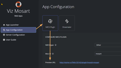

  2. You can check that the NRCS Plugin is accessible by either:
    1. In the Configuration Tool, click App Launcher > NRCS Plugin.
      or
    2. following the URL next to the Copy button.
The Plugin URL comprises the machine name, port number 55142, NRCS type and (when supported) Mos ID in the form:  http://machine-name:55142/plugin?nrcs={type}&mosid={mosid}

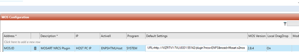

ENPS

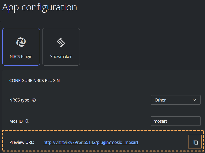

  1. In the Configuration Tool select App Configuration > NRCS Plugin and copy the value of Preview URL.
  2. On the ENPS machine, navigate to System Maintenance > MOS Configuration.
  3. Paste the NRCS Plugin's copied URL, similar to the example below:
Info: The URL comprises a combination of the Plugin's URL + a fixed port number and Viz Mosart's MosId value in the form:
http://machine-name:55142/plugin?nrcs=ENPS&mosid=xxxx
  • If you need to derive current MosId value, see the item To find your Mos ID.

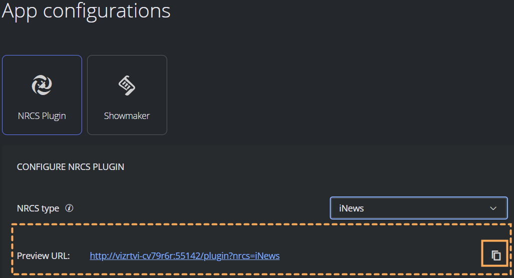

  2. From the Configuration Tool select App Configuration > NRCS Plugin and copy the value of Preview URL.
  3. In Mosart NRCS Plugin - iNEWS Client Addon, paste-in the URL of the Plugin.

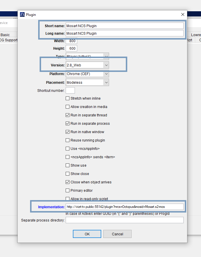

Octopus

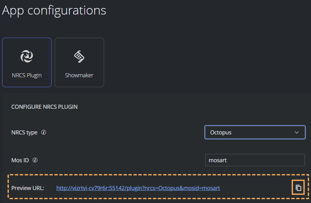

  1. From the Configuration Tool select App Configuration > NRCS Plugin and copy the value of Preview URL.

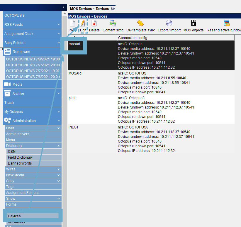

  2. Log-in to Octopus with Admin privileges.
  3. From the sidebar, navigate to MOS Devices > Devices, select mosart and click Edit.

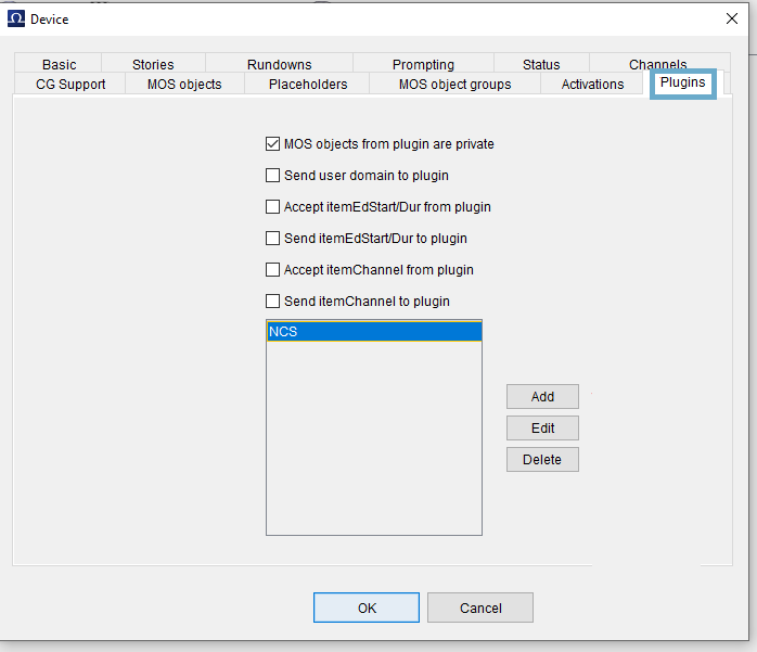

  4. Select the Plugins tab:
  5. Fill-in as below, and providing:
    1. A unique name
    2. Version
    3. The URL to the Viz Mosart NRCS Plugin (copied in step (1).
  6. Setup is complete.

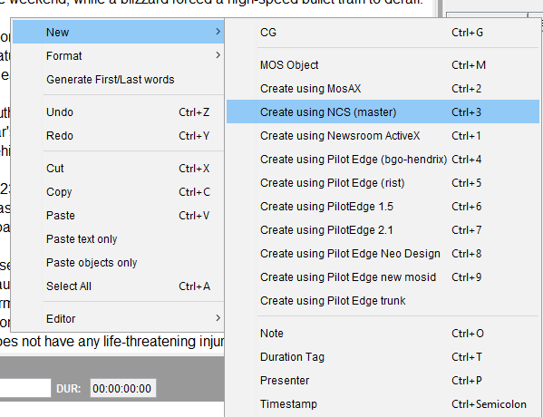

    When editing a selected rundown, the user right-clicks for New > Create using <given name of the Plugin>
