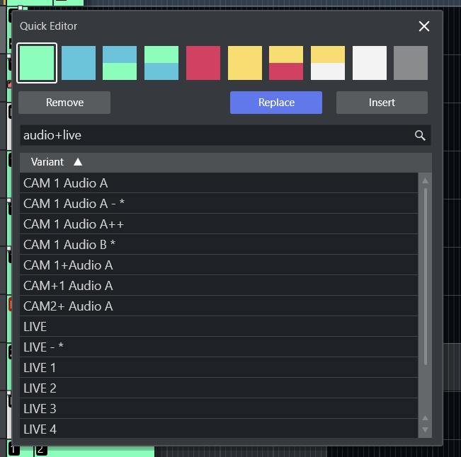

  • Double-click the information area of a story, on a template or to the right of the last element in a story.
    The Quick Editor opens:

  1. Select the new template
  2. Click Replace.
The previous template is replaced with the newly selected item.
To Insert a Story Item
  1. Select the new template for insertion
  2. Click Insert.
The new template is inserted after the selected item.
To Insert a Story Item at the end of the Story
  1. Double-click on the right side of the last item in any story
  2. Select a template type
  3. Choose a variant
  4. Click Insert.
To Search for a Template Variant
The Quick Editor Search field helps you locate a specific template. The search tool is not case sensitive. Some tips:
  • A space between keywords acts as a logical AND, enabling multiple keywords.
    For example:
    • CAM VIDEO: Lists variants with both CAM and VIDEO in their name.
    • CAM AUX 3: Lists variants with with all three namings  CAM, AUX and 3.
  • A + sign between keywords acts as a logical OR, enabling multiple keywords.
    For example:
    • CAM+VIDEO: Lists variants that have CAM or VIDEO in their name.
    • CAM+AUX+3: Lists variants with any of the namings CAM, AUX or 3.
  • Combination of space and + (+ sign has a lower priority).
    For example:
    • CAM+AUX 3: Lists variants that have CAM or AUX and 3 in the name.
    • CAM AUDIO+AUX 3: Lists variants that have CAM and Audio or AUX and 3 in the name.
