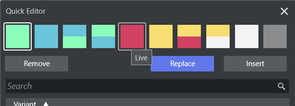

The Quick Editor provides a convenient method for modifying template characteristics in a rundown story. For example, when you decide to perform the next studio shot in Cam 2 instead of Cam 3.
Quick Editor Operations
After double-clicking a template you can:
  • Change the type: Delete, replace, and insert primary elements (for example, Camera)
  • Change the variant: Delete and replace accessories, delete lower thirds
  • Delete the entire template
  • Insert a new template directly after the current one.
Template types Camera, Package, Voice over, Float, Live, Graphics, DVE, Telephone, Break and Jingle are supported as primary story items in the Quick Editor.

  • Double-click the information area of a story, on a template or to the right of the last element in a story.
    The Quick Editor opens:

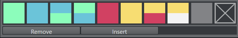

  • Double-click on the right side of the last item in any story.
    A minimized view of the Quick Editor opens:
    Using this view, you can insert a new item at the end of the story.
    See To Insert a Story Item at the end of the Story below.

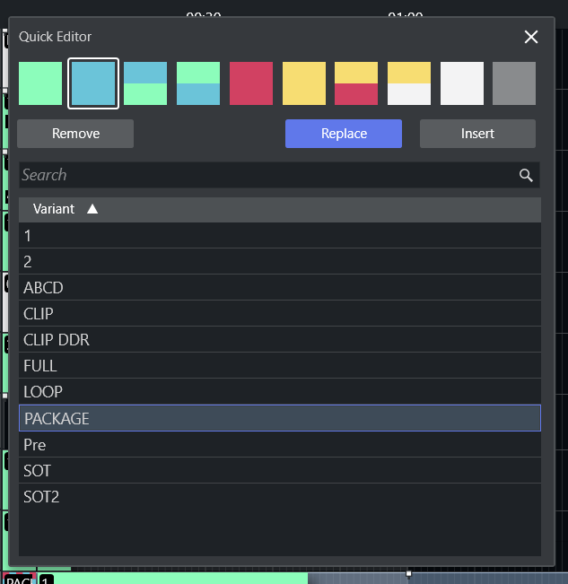

To Replace a Story Item
  1. Select the new template
  2. Click Replace.
The previous template is replaced with the newly selected item.
  1. Select the new template for insertion
  2. Click Insert.
The new template is inserted after the selected item.
  1. Double-click on the right side of the last item in any story
  2. Select a template type
  3. Choose a variant
  4. Click Insert.

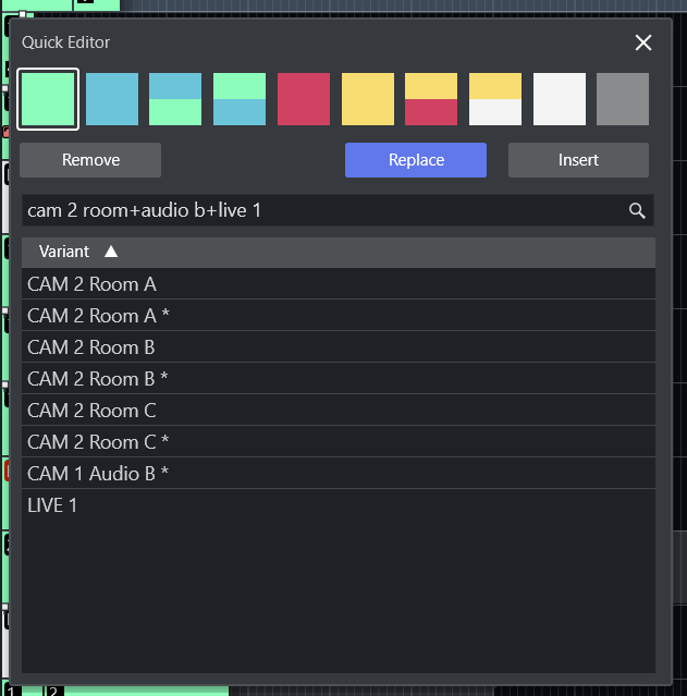

To Search for a Template Variant
The Quick Editor Search field helps you locate a specific template. The search tool is not case sensitive. Some tips:
  • A space between keywords acts as a logical AND, enabling multiple keywords.
    For example:
    • CAM VIDEO: Lists variants with both CAM and VIDEO in their name.
    • CAM AUX 3: Lists variants with with all three namings  CAM, AUX and 3.

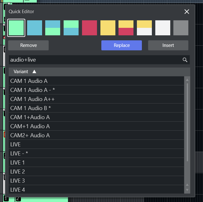

  • A + sign between keywords acts as a logical OR, enabling multiple keywords.
    For example:
    • CAM+VIDEO: Lists variants that have CAM or VIDEO in their name.
    • CAM+AUX+3: Lists variants with any of the namings CAM, AUX or 3.
  • Combination of space and + (+ sign has a lower priority).
    For example:
    • CAM+AUX 3: Lists variants that have CAM or AUX and 3 in the name.
    • CAM AUDIO+AUX 3: Lists variants that have CAM and Audio or AUX and 3 in the name.
