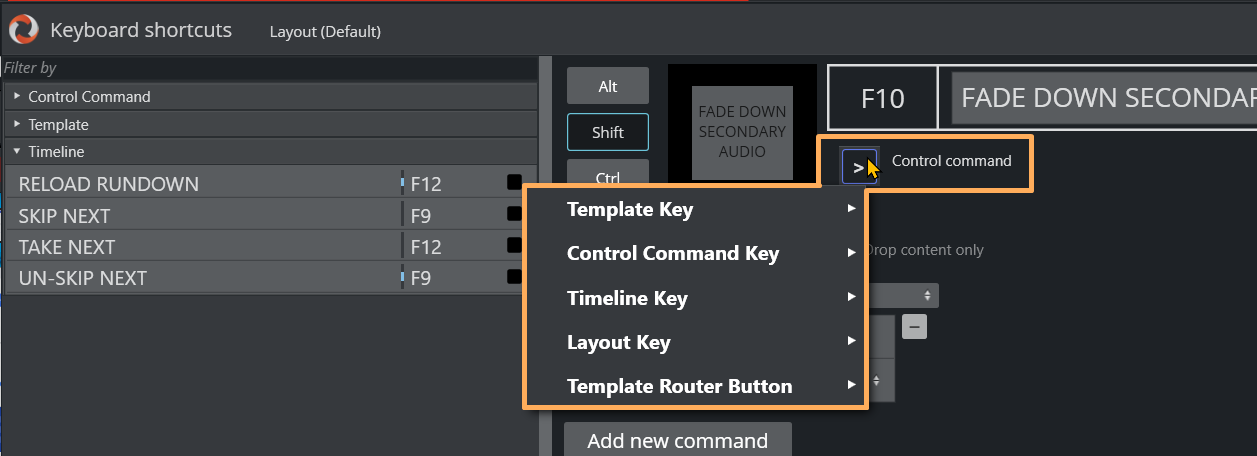

  • You access these settings from the menu bar: Tools > Keyboard shortcuts editor and then selecting Control Command Key from the panel on the right.
Working With Control Commands for a Keyboard

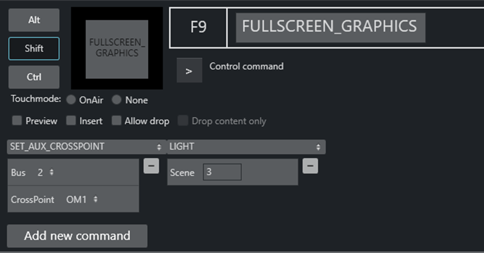

Adding a New Command
To add a new parameter
  1. Refer to the table Keyboard-based Control Command Categories
  2. From the menu bar select Tools > Keyboard shortcuts editor.
  3. Click Add new command to add multiple commands to a shortcut.
    In the figure above, two commands have been added: SET_AUX_CROSSPOINT and LIGHT.
    These commands are executed sequentially from left to right (in the example, first SET_AUX_CROSSPOINT, then LIGHT).

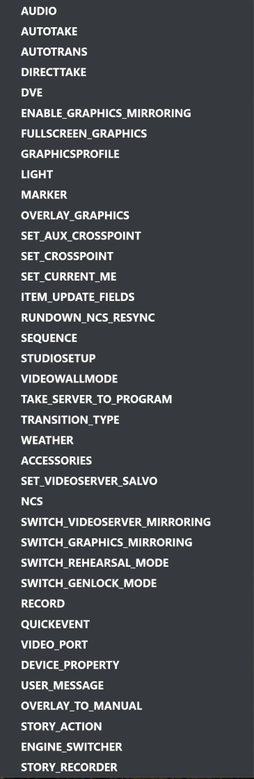

In the Viz Mosart UI, control commands are arranged in categories, based on the key.
The table below refers to commands available per category.
The table below presents the Parameters (command keys) that control what happens when the selected command (in column Command Category and Summary) is run as a keyboard shortcut.
Parameters
Default / Notes

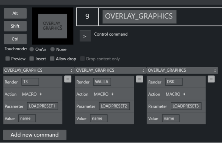

OVERLAY_GRAPHICS
The Overlay Graphics Interface (OGI) provides control and monitoring of overlay graphics for all Viz Mosart-approved graphic engines.
Render: All OVERLAY_GRAPHICS commands share the Render parameter. This parameter can be set to send the given command to a specific engine, or to engines which currently have active graphics On Air, to execute the specific command.
This value can also be non-numeric (Current) or the destination configured in the Overlay Graphics Interface.
In example below, Current was configured to clear the graphics from all the engines.
Alternatively, Engine 1:
For a detailed description, see section Overlay Graphics Interface of the Viz Mosart Administrator Guide.
Action: Below is a description for all available actions.

Parameter: The function of Parameter depends on the chosen command.
In the screenshot below, Parameter specifies which destination to clear the graphics.
Note: The value in the Parameter field has a higher precedence than the value in Render.
Value: This field is ignored.

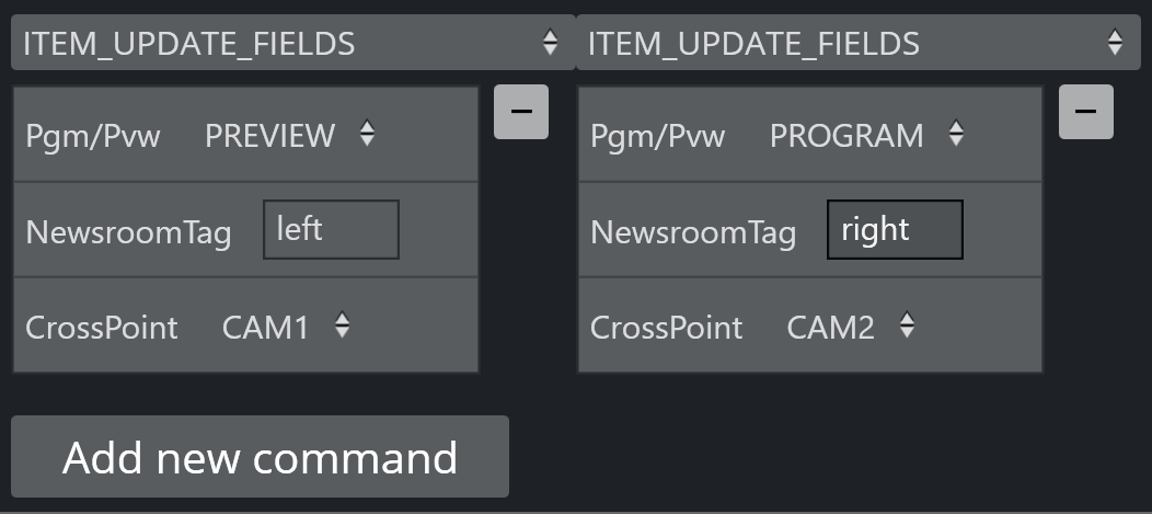

ITEM_UPDATE_FIELDS
Pgm/Pvw: Select PREVIEW or PROGRAM to define the template which will be affected.
NewsroomTag: The newsroom field name that will be affected in the DVE template/boxes.
CrossPoint: Select the crosspoint that will change.
Supports multiple commands of either preview or program, or a combination of preview and program on the same keyboard shortcut.

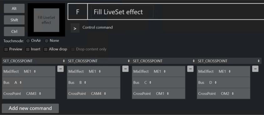

SET_CROSSPOINT
Sets a crosspoint on the vision mixer.
MixEffect:
PP
ME1
ME2
ME3
ME4
M_RIP
M_OTH
Bus: The ME, bus (A, B, C, D or keyers)
Buses C and D are used for video switchers supporting M/Es effects with 4 layers (for example, with vizrt-ips).
CrossPoint: INP1-6.

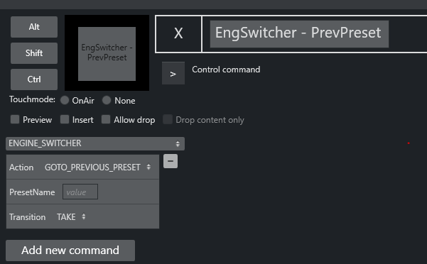

ENGINE_SWITCHER
Action:
INIT
Reset the Engine Switcher status. Typically used at rundown reload.
PRESET_STYLE
Jump back to the previous preset.
GOTO_PREVIOUS_PRESET
Toggle between the last preset applied and the previous one.
PresetName:
Name of Preset, created in Viz Engine.
Transition:
CUT
TAKE
