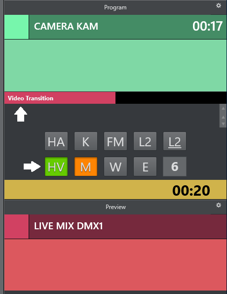

Hold Video Transition (HV)
Pressing Hold (HV) holds the video transition when the next template is called. Viz Mosart waits to do the video mixer crosspoint change until a new Take Next command is issued when the hold video transition is active.
In a situation where you have CAM 1 in program and a clip (PACKAGE) in preview and use the Take Next with Hold video transition, Viz Mosart handles all transitions between the two templates, except the vision mixer crosspoint change. Viz Mosart fades down the sound from the CAM element and fades up the sound from the clip. It starts to play the video on the assigned video port, and all secondary items with an in-time use the Take Next as the relative starting point.
The Viz Mosart GUI Program window notifies the user that the video transition is on hold,
and that the user needs to send a new Take Next to change the vision mixer crosspoint. This functionality can also be toggled to be auto-taken in a template or by a keyboard shortcut key.

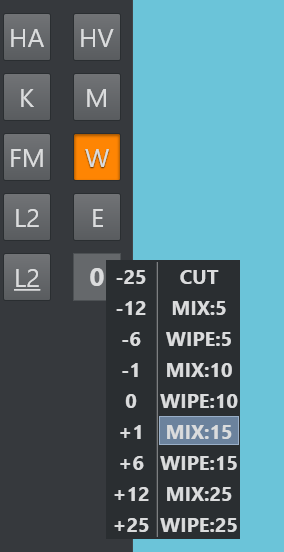

  • Right click the Transition number to show some suggestions.
    The left column lets you increase or decrease the number. The right column lists transitions listed you can choose.
  • For a touch screen, touch and hold the transition area. A similar menu displays, enabling transitions to be used on a touch-based interface.
