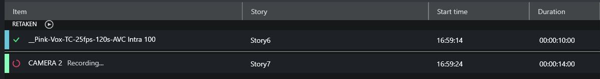

Pause-Fix-Retake Mode
The standard use of Story Recorder is where you wish to pause an ongoing show recording, make a correction to the production, then resume from the pause.
To record a show with pause-fix-retake
Initiate recording as described in the first 4 steps of To record a show as a single clip above.
Press PAUSE to interrupt recording as required.
In the Story Recorder panel, the current story item is marked as Paused.
In Rundown view above, the corresponding rundown story title is also blue.
In the Rundown view, on the story row, a pre-roll template is automatically inserted before the paused story item.
Make required changes and prepare to recommence recording, by clicking the button PAUSED.
A countdown timer cues for retake and recording resumes from the break point.
Continue as above till the last story line, where an information text warns that the show recording will soon be complete.
