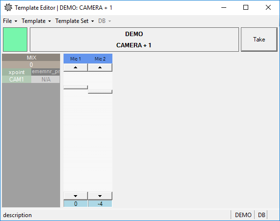

You create and edit individual templates and template sets (standalone and hierarchic) in the AV Automation application, Template Editor.

From the AV Automation console program (running on the Viz Mosart server), navigate to Main menu > Devices > Template editor.
Templates displayed in Template Editor provide detailed information about their origin, purpose and control settings.
