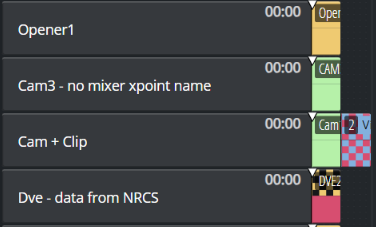

Story and Timeline
Each story line consists of a Story info area to the left and a representation of the Viz Mosart templates and secondary elements (extracted from Viz Mosart commands in the NRCS), in the Timeline view to the right.
Story Info
The left Titles and Timings area (also called Story Info area) displays the following details:
Top left hand corner: Estimated On Air time (11.53.23 in this example).
Timer in the middle of first line: When the story is on air, how long the story has been running.
Top right hand corner: The editorial duration of the entire story, as entered in the NRCS.
Second line: The story title as entered in the NRCS.
Red marking: The story currently on air.
Yellow marking: The next story that will be taken to air.

Camera
A Camera template is displayed as a green colored element in the GUI. The variant of the template type (often the camera number) appears in the top left hand corner. The duration of the template is automatically calculated based on the presenter's script as entered in the NRCS (see Story Editorial Time below).
Package
This template type is for playing (or recording) a video clip.
The package template type is displayed as a light blue element in the GUI. The variant identifier appears in the top left hand corner. The length of the package element is calculated from the actual clip length, if available on the video server.

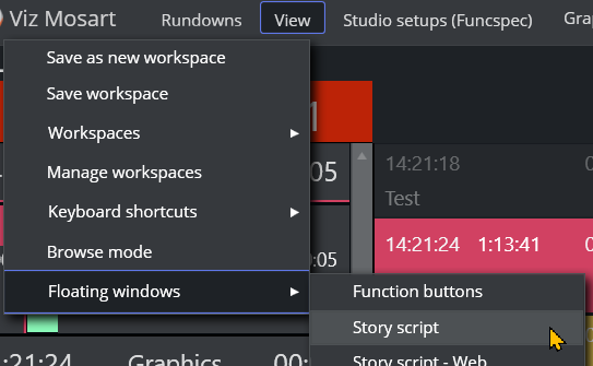

Story Info
You can open the Story Info floated as a separate fully operational window or as a read-only copy.
To float the Story script window
All operations are available from the floated window.
From the menu bar, select View > Floating windows > Story script.
Position the floating window by dragging its menu bar and adjustable frame handles.
To view the Story script in a web browser
You can display a read-only copy of the Story script, floating as a web-based window.
From the menu bar, select View > Floating windows > Story script - Web.
Tip: A superior, scalable read-only view, is offered by viewing story details in a separate web browser with the Mosart Web App Rundown Viewer. See Mosart Web Apps below.
