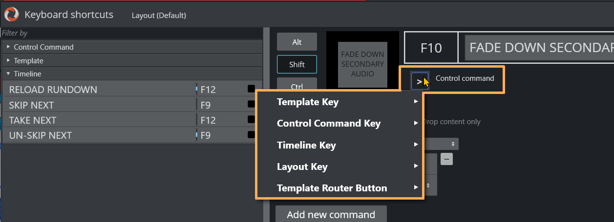

Adding a New Command
To add a new parameter
Refer to the table Keyboard-based Control Command Categories
From the menu bar select Tools > Keyboard shortcuts editor.
Click Add new command to add multiple commands to a shortcut.
In the figure above, two commands have been added: SET_AUX_CROSSPOINT and LIGHT.
These commands are executed sequentially from left to right (in the example, first SET_AUX_CROSSPOINT, then LIGHT).
