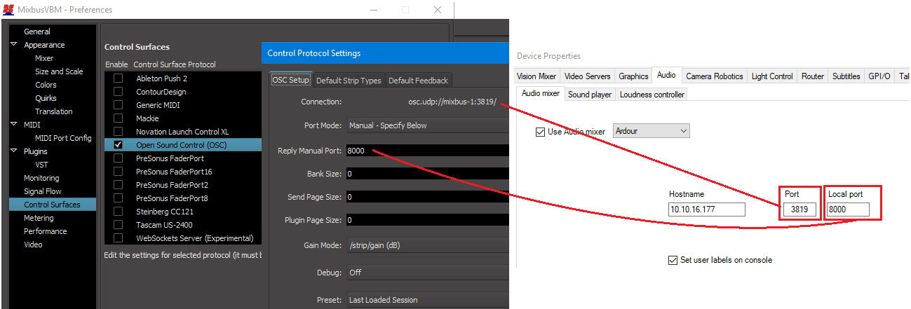

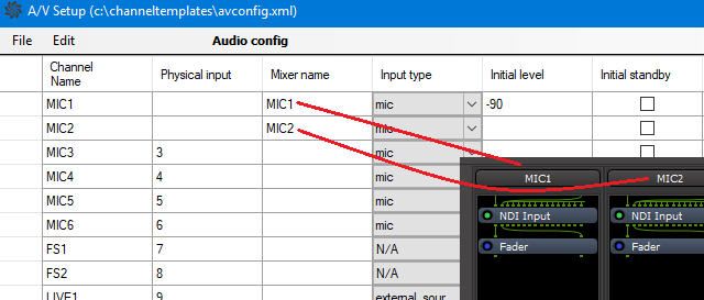

  • Ensure OSC is enabled in the Control Surface Protocol selector and that in the OSC Setup tab, Viz Mosart Audio mixer properties match:
    In the example above, where the port number (here 3819) match correctly.
  • The input field Port Mode must be: Manual - Specify Below.
  • The input field Reply Manual Port can be any value, including empty.
  • The Mixer name must match the input name, Physical Input is blank:

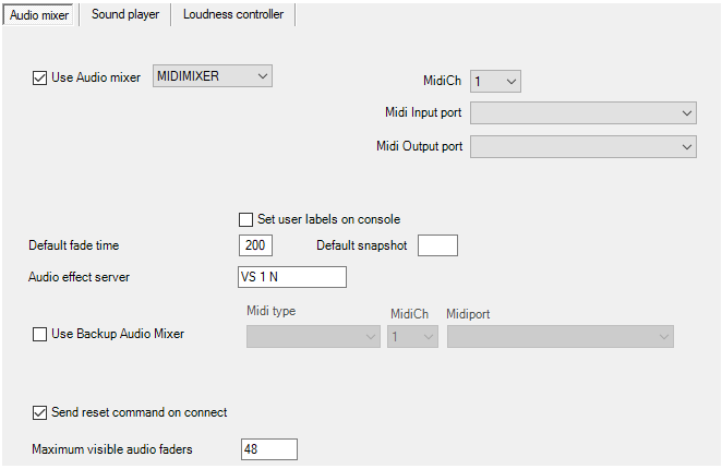

  • Serial (Calrec, Lawo, Studer, etc.): Serial port connected to the audio mixer, when Serial radio button is selected.
  • TCP/IP: Hostname or IP address and port to communicate with the audio mixer, when TCP/IP radio button is selected. Note that for Calrec it is possible to configure a main and backup audio mixer by specifying two comma separated hostname values and port values.
  • Hostname: Hostname or IP address of the audio mixer.
  • Port: Port on the audio mixer.
  • Local port: (Ardour only) The mixer will send messages to this port on the Mosart server. Use 8000 unless there is a good reason for choosing another port.
  • Backup hostname and port (LAWO RMNOPL): Hostname (or IP address) and port to the backup audio mixer console.
  • Set user labels on console: When selected, user labels on the (non-EMBER+) Lawo or Vista console are overwritten.
  • MidiCh (MIDIMIXER and YAMAHA_O2): MIDI channel assigned to the audio mixer. Depending on mixer model, this setting may have to correspond to settings on the mixer.
  • Midi Input port (MIDIMIXER and YAMAHA_O2): System MIDI input port to communicate with the audio mixer.
  • Midi Output port (MIDIMIXER and YAMAHA_O2): System MIDI output port to communicate with the audio mixer.
  • Default fade time: Time in frames for fading open faders with the manual fade function (CTRL+F).
  • Default snapshot: Snapshot to recall when starting the automation (MIDI parameter change).
  • Audio effect server: Name for the Audio effect fader. This fader will open if effect transitions are used.
  • Send reset command on connect: Used for STUDER3000 SW 2.2, or lower. Recalls a default setup for the Mixer panel.
  • Visible audio faders: Maximum visible faders in AV Automation.

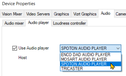

Audio Players
You select from available audio players at AV Automation > Devices > Properties > Audio tab > Audio Player sub-tab.

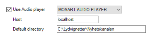

To set up the Mosart audio player
  1. On the machine that will be used for the audio player, open the Viz Mosart installation folder and locate the Audio Player installer file, named something like
    VizMosartAudioPlayer-5.13.2.32554.msi
  2. Install the audio player, ensuring to add a Desktop shortcut, for user convenience.
  3. Start the program from the Desktop.
  4. On the Viz Mosart server, open AV Automation.

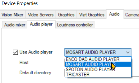

  5. Go to Devices > Preferences > Audio > Audio player.
  6. Check Use Audio player and choose from the players in the drop-down list.
  7. Under Host write the hostname or IP address of the computer where the audio player is running (the machine selected in step 1. above).
Info: To select alternative port usage, see Audio Player Port Numbering below.
  1. Under Default directory, write the folder path where the audio files are stored. This is specified by the setting Audio Directory in the Viz Mosart Audio Player.
  2. Restart AV Automation and check that the connection is green.

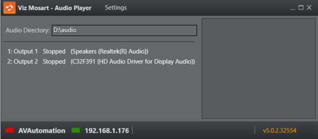

When the Viz Mosart Audio Player is configured, the user opens the UI from a desktop shortcut
or file location “%programfiles(x86)%\Mosart Medialab\Mosart Audio Player\Mosart Audio Player.exe”.
Info: User actions are described in section Playing Audio of the Viz Mosart User Guide.
Viz Mosart Audio Player UI
UI Element
Description
Settings
Open the Settings menu for configuring the Audio Player.
Audio Directory
Folder path to available audio files. All files in this folder are ready to be played
This location must be the same as is set as Default directory in AV Automation Devices > Properties > Audio > Audio Player.
Only files located in this directory are available to the Viz Mosart audio player.

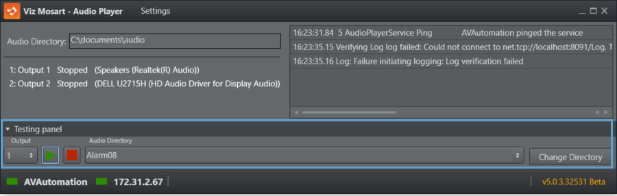

Log panel (right hand panel)
All log messages that the audio player creates.
AVAutomation (status)
Green: AV Automation is connected
Red: No AV Automation connection.
IP Address
IP address of the computer that the Audio Player is running on.
Version
Version number of the Audio Player.

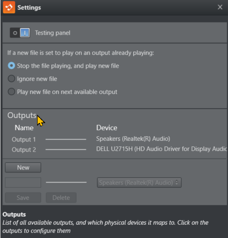

The Settings menu
Testing panel

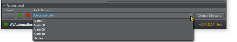

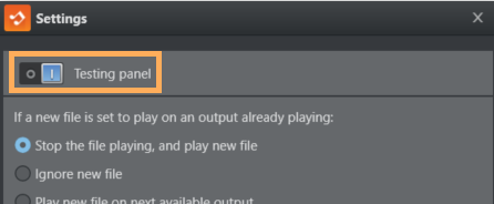

  • Select this option to display a player at the foot of the Audio Player panel.
To select the directory containing your audio files
  • Click Change Directory.
To select a file for playing
  • Click the double-arrow to list and select a file.

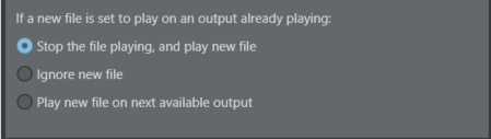

Behavior when file is already playing
  • In this panel, you can determine what action the Audio Player will take when a new file is played and a file is already playing.

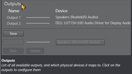

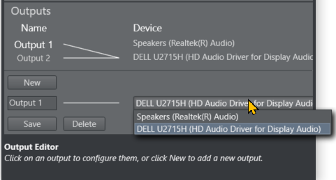

Outputs
The Name column shows all outputs. The Device column shows all available playback devices on the computer.
The line between them shows which playback device the output uses to play the audio file.
To select audio device for an output
  1. Click an Output. (In this case, Output 1 has been clicked.)
    The panel below displays a drop-down menu of available devices.
  2. Choose from the displayed devices to associate one of your computer's playback devices with the selected output.

By selecting TriCaster from the list of available audio player devices, you can control (access and play audio clips) the TriCaster onboard audio player from a Viz Mosart template.
To set up a TriCaster audio player
  1. Start the TriCaster on a host machine available to the Viz Mosart server.
  2. In AV Automation, navigate to Devices > Properties > Audio (tab) > Audio player (tab).
    1. From the drop-down menu to the right of Use Audio player, select TriCaster (previously called vizrt-ips).

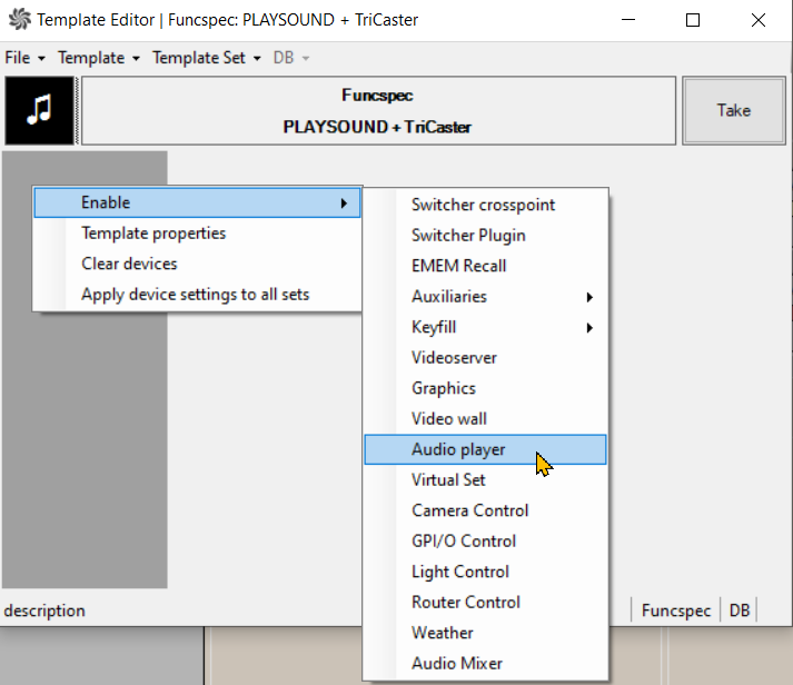

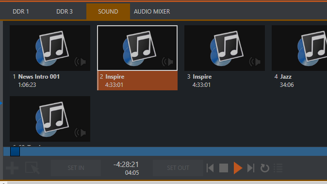

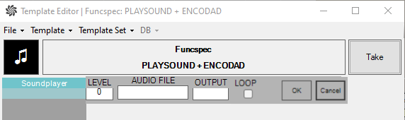

  4. In AV Automation, navigate to Template Editor > Template > Select or Template Editor > Template > New.
  5. Choose or create an appropriate template, right-click in the dark grey area to the left and select  Enable > Audio player.
  6. In AUDIO FILE, enter an existing file name.

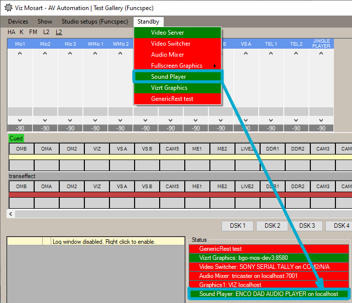

Info: Looping (selecting LOOP) is not currently available for TriCaster
These can be browsed in the SOUND tab on the TriCaster (in this example, Inspire.mp3).
  1. On the Soundplayer device, click OK.
See also: TriCaster and Viz Mosart.
Third Party Audio Players
ENCO DAD Audio Player
By selecting ENCO DAD Audio Player from the list of available devices, you can control (access and play audio clips) the ENCO DAD audio player from a Viz Mosart template.

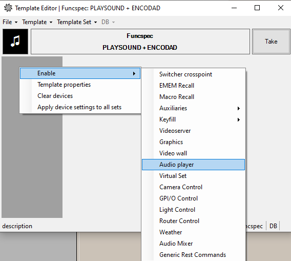

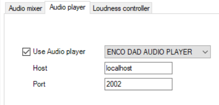

To set up an ENCO DAD audio player
  1. Start the ENCO DAD on a host machine available to the Viz Mosart server.
    1. Check Use Audio player.
    2. From the drop-down menu to the right of Use Audio player, select ENCO DAD AUDIO PLAYER.
    3. In the Host field, enter the hostname or IP address of the ENCO DAD host.
    4. In the Port field, enter the ENCO DAD monitors port. At clean installation, this value is initially preset as 2002, but if left empty, clears to 0.
    5. Click Save & Close.
  3. Restart AV Automation and make sure you have a green connection.
  4. In AV Automation, navigate to Template Editor > Template.
  5. Choose an appropriate template, right-click in the dark grey area to the left and select  Enable > Audio player.
Info: Looping (selecting LOOP) is not currently available for Third Party Audio Players.
  1. In AUDIO FILE, enter the name of a file in the ENCO DAD library.
  2. In OUTPUT, enter a valid machine number (in ENCO DAD).
  3. For Soundplayer device, click OK.

To set up a SpotOn audio player
  1. Download, install and start the device software to a host machine available to the Viz Mosart server.
  2. In AV Automation, go to Devices > Properties> Audio > Audio player.
    2. Choose SpotOn Audio Player from the players in the drop-down list.
    3. Under Host write the IP address to the machine where the SpotOn player is running.
    4. Click Save & Close.
  3. Restart AV Automation and check that the connection is green

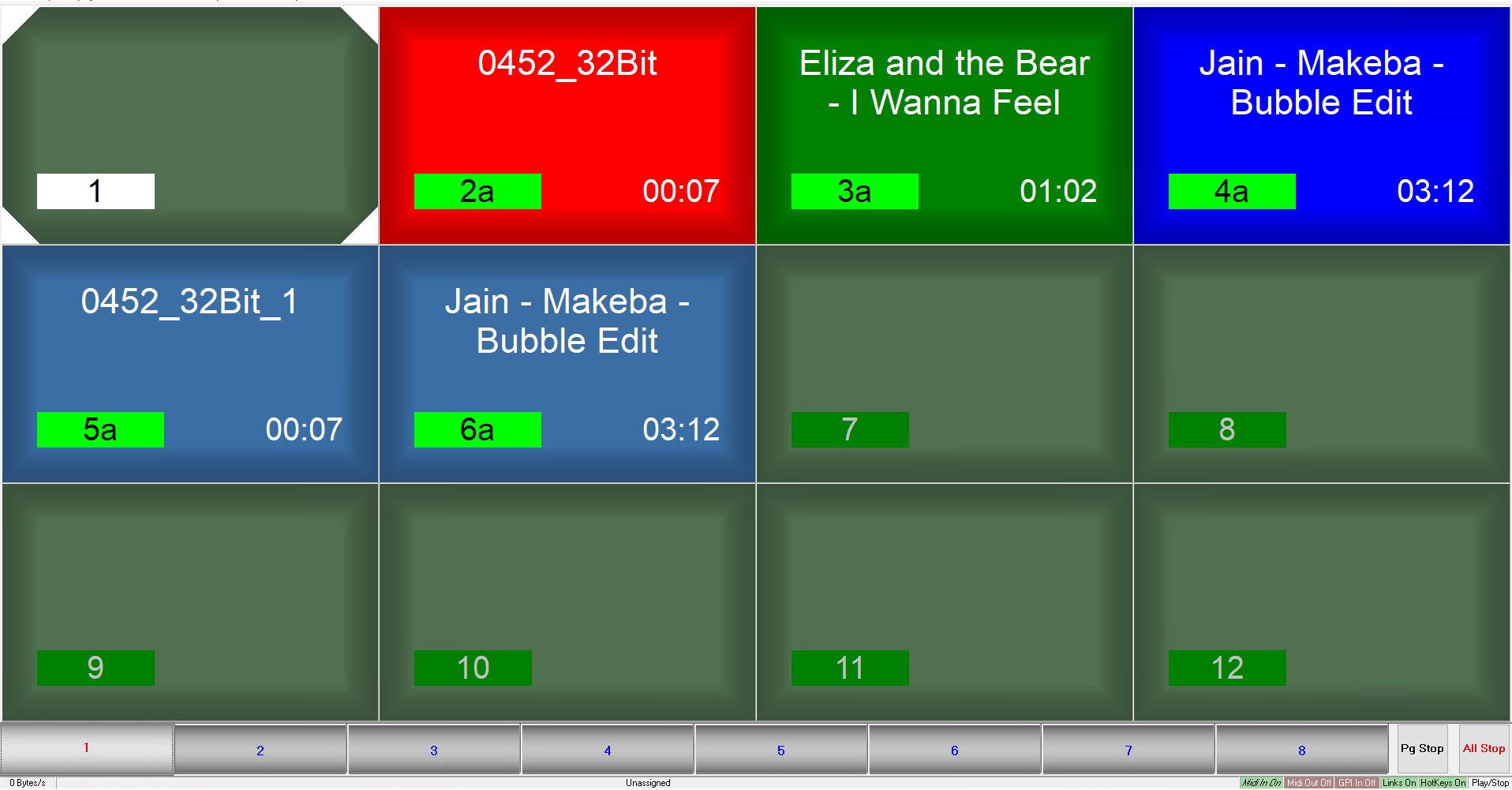

Addressing an audio file that is stored in a SpotOn client is similar to the default player method above, but the file identifier is different.
Info: Looping (selecting LOOP) is not currently available for the SpotOn player.
  • LEVEL: This value does not affect the audio fader that is taken to Program. Instead a special command option is offered. Set LEVEL to -90 to send a STOP (playing audio) command. All other values are ignored.
  • OUTPUT: Enter the panel button number to identify the associated audio file (in this sample screenshot below, 2a).
Tip: Use the button number (mapped to OUTPUT) as reference (instead of the audio file name). You can then replace the audio file assigned to a button (for example, when a show is rebranded and new music selected) and still keep the same template information.
This avoids having to change the file name.
  • AUDIO FILE: Enter the panel button name here (in this example 0452_32Bit).
Info:
  • Newsroom tag available. If a newsroom tag is added, and a value is provided by the NRCS, that value for the file name (with either AUDIO FIE or OUTPUT) is used.
  • When both panel button number and panel button name are used as file identifier, the value of panel button number takes precedence.

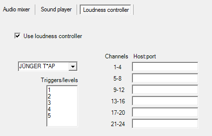

Viz Mosart can interact with a loudness controller from Junger.
To configure loudness control
  1. Navigate to AV Automation > Devices > Properties> Audio > Loudness controller
  2. Follow these setup guidelines:
    1. Use loudness controller: Check the box to enable loudness control.
    2. Loudness controller type: Dropdown menu selector. Choose JUNGER T*AP
    3. Triggers/levels: Name of triggers or loudness levels, one for each line. These appear in a tooltip menu of Template Editor, and must correspond to the configuration in the loudness controller(s)
    4. Channels: Fixed values. For Junger T*AP there are four stereo channels per host.
      Connections to the audio faders are configured in AV Automation > Devices > A/V Setup > Edit > Audio config > (Loudness channel)
    5. Host:port: Hostname or IP address and optional port number for each controller.
  3. Save & Close.
Info: If the root node name is different from T*AP the name must be set in the  AV Automation configuration property JungerRoot .
