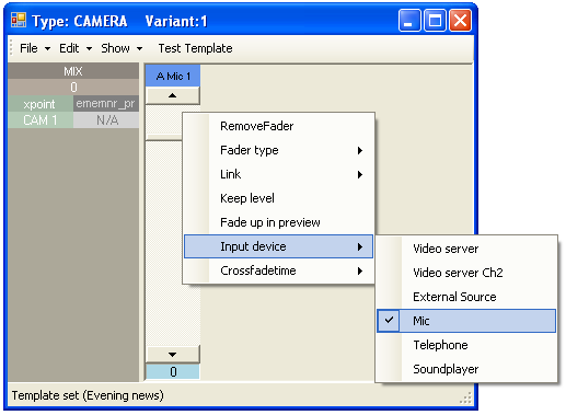

Studio Camera
The template for a typical studio camera is based on the CAMERA type. The example below defines a standard camera 1 variant. An entry named CAM 1 in the video setup is selected at the PP bus cross point. Transition duration is 0 frames (hard cut) and E-mem recall is disabled. There is only one studio microphone, which fader is called "A Mic 1" in this template. Audio level is set to 0 dB, and the input device is a microphone. The input device type is important for the handling of audio in an ad lib sequence of full camera, DVE and full external source.
For our standard camera 2 variant, the only difference in the above setup is the PP bus cross point which is called CAM 2.

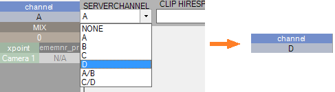

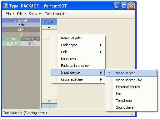

Package: Video Clip with Full Sound
As crosspoint on the vision mixer, we use a source called S_RIP, which means Viz Mosart uses the A/B roll and roll between the sources defined in the AV setup as videoserverA and videoserverB. We chose RIP_C1 as the audio source, but as long as A/B roll is enabled, any source defined as Video server follows the video source. The default transition is a three frame mix. The video channel control is also enabled and controls the clip. The server channel is automatically assigned within the automation.

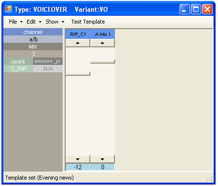

Voice-over
In this example, the variant VO is defined. Notice the difference from the two last examples and the two fader setups. A Mic 1 is microphone input type and RIP_C1 is video server type.
A second sound level can be set for each fader by using the SHIFT key over the fader to set the second level. This second sound level for all faders is used as the start level for the voice over sound bite type. The same special variant logic for video clip with full sound applies for the voice-over type.

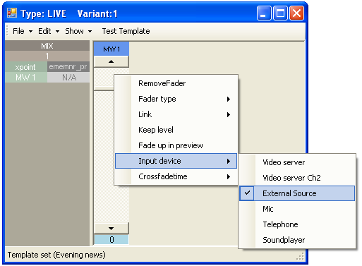

Live External Source
Live external source variants are typically defined by their corresponding vision and audio mixer inputs. In the example below, we define variant 1 as source MW 1 on both PP bus cross point and audio fader.
Additional variants 2 to 9 would typically use MW 2 to MW 9 as sources for both video and audio.

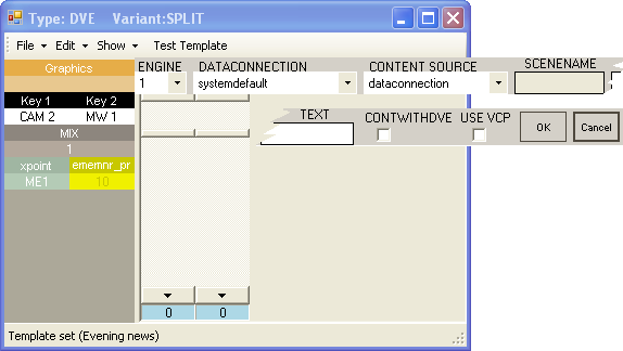

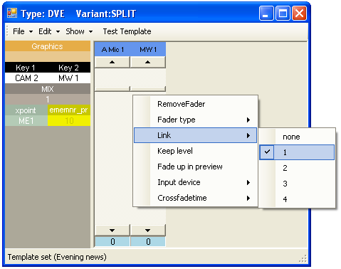

DVE

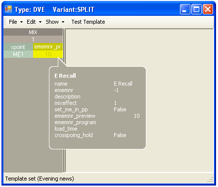

The example below describes four setup steps necessary to create a template that recalls a predefined E-mem (emem number 10) defining a split screen DVE on M/E 1 on the vision mixer.
1. E-mem Recall Definition
The vision mixer effect uses key 1 and key 2 on M/E 1 as left and right split windows.
The PP bus cross point is set to ME1 (program output of mixer effect). The E-mem recall control is defined to recall emem 10 when the template is taken to preview.

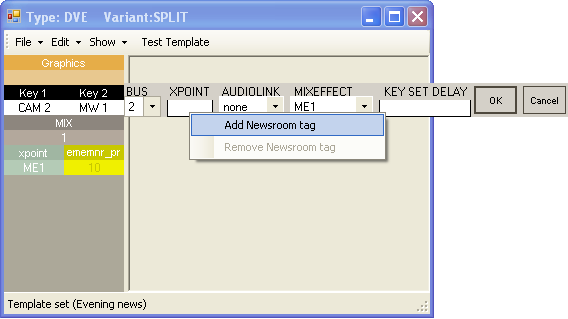

2. Key bus Delegation Setup
Default crosspoints are chosen (CAM 2 and MW 1) and since a newsroom tag has been added for both keys, the crosspoints can be set from the newsroom system.
Right click over the XPOINT window to add a newsroom tag. In addition, the template defines a recall of a graphics background.
The second key bus delegation is shown. As a default we assign CAM 2 to key bus 1 and MW 1 to key bus 2 on the ME1 mixer effect bus.
(This assignment can be overridden from the NRCS story element by using the newsroom tag).
3. Audio Linking
The audio link is set to 1 for both the key 2 delegation and the second fader (MW 1).
When using the newsroom tag to set key 2 to a different source (for example MW 3), both video and audio delegation will follow:
This leads to the key 2 source being set to MW 3 and the second audio fader being set to MW 3.
4. Graphics Engine Data Element Setup
Setup of the graphics controller is described in the next section.

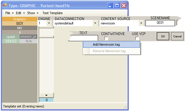

Graphic: Full Screen Graphics
The graphics controller in the Template Editor is vendor-specific, due to the lack of a generic control API. As a general feature, it can control multiple graphic engines. A typical controlled cluster could for example be, one for full screen graphics, one for studio wall graphics and additionally, an overlay graphics engine. For DVE effects, this can be a fixed element, while for telephone graphics or maps the element name and data are provided in the NCS story.
The controller's task is to cue graphics when taken to preview and run them when taken to program.

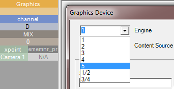

Graphics
  • To avoid conflict with other graphic elements, you may want the wall to run on its own engine. This can be changed in the accessory.
    A wall taken graphic element will then use this engine.

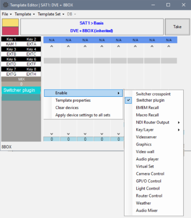

Switcher Plugin

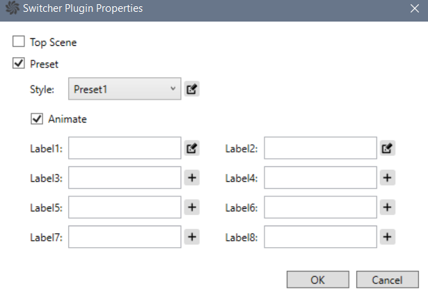

These are advanced configurations to a standard switcher where functionality is extended. The example in this section refers to extending Viz Engine functionality.

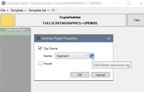

A Switcher plugin option is available in the list of devices to be enabled on the template.
The Switcher plugin view introduces two new configurable features, top scenes and presets.
Static values can be specified directly on the template. Newsroom tags can also be configured, enabling control from within the NRCS.

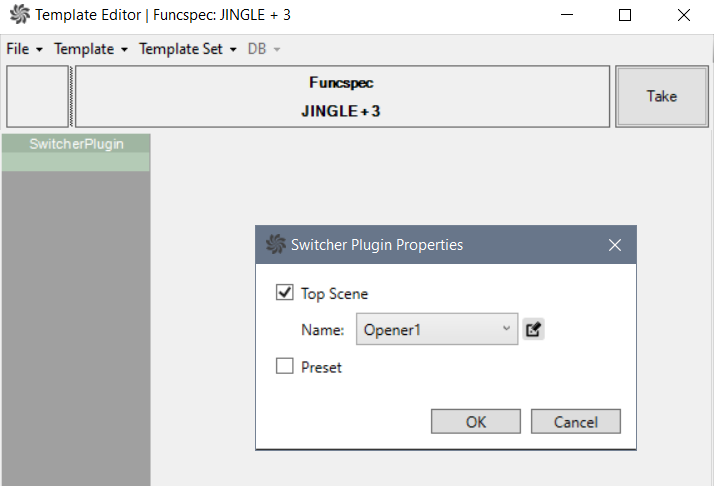

Top Scenes
Note: To work with top scenes, you must first perform the required setup, as described in the Configuration section of Viz Engine as a Switcher.
A typical use of top scenes is as an opener. For example, the top scene is played to introduce the 8 o’clock news show with many visual effects that fade to the following camera scene, and a news host taking over.
Tip: For an in-depth explanation of Top Scenes and their time-related configurations, refer to the section Viz Engine as a Switcher (Top Scenes).

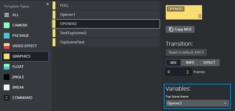

To create a template that plays a top scene
  1. Create (typically) a Jingle template.
  2. Enable Switcher plugin for the device.
  3. Specify the top scene name from the list with the following options:
    1. None (empty).
    2. A list of top scene pre-configured in the A/V Setup.
      Select the required top scene (this is the name of the scene in the associated Graphics Hub folder).

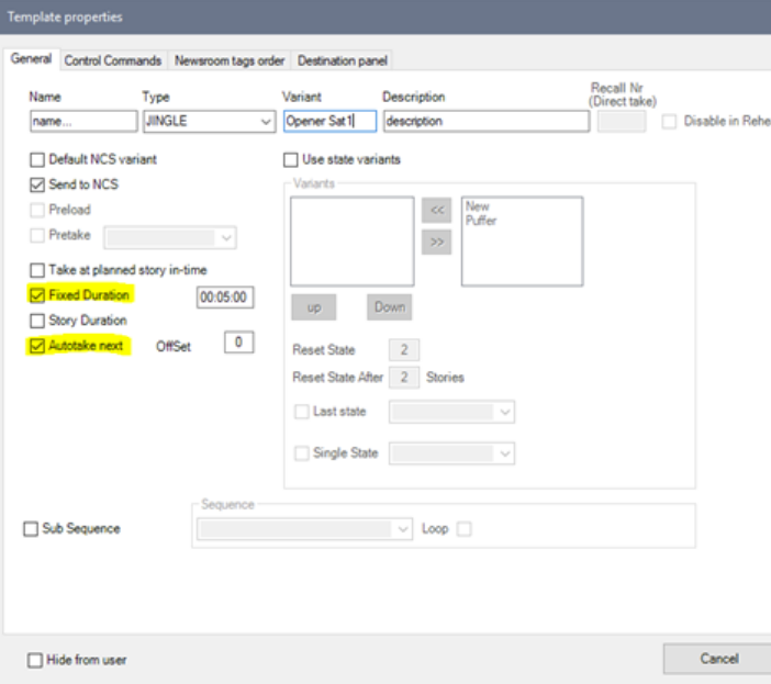

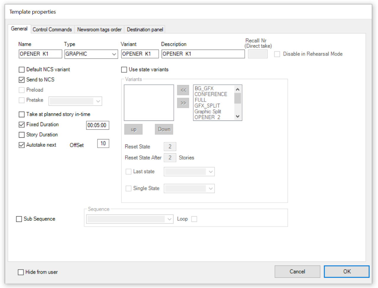

There are two time-related aspects when creating new templates for top scenes:
  1. The time it takes for the scene to load. This is handled automatically by Viz Mosart when cueing the story item.
  2. The time it takes for the scene to run. This is controlled with the Fixed Duration and Autotake configurations on the template.
Autotake
  • You can add an Auto Take to the template to jump to next story item automatically (switch underneath the Top Scene)

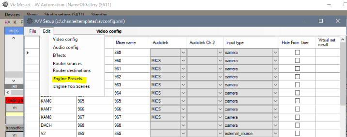

Presets
Select Engine Presets from Edit tab.
Use one of the following options:
  • None (empty).
  • A list of preset names pre-configured in A/V Setup (AvConfig.xml) file.

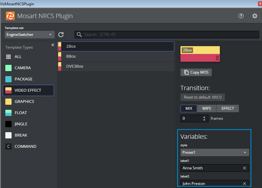

Transition Style

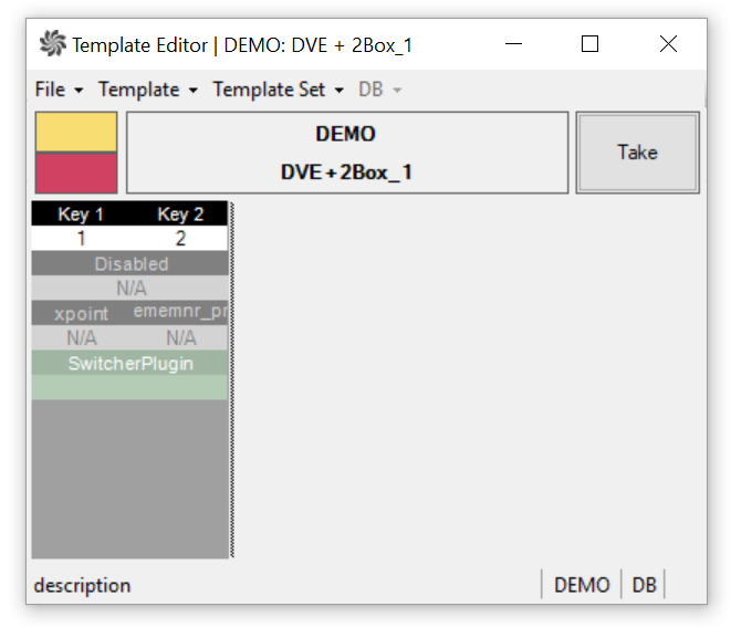

The transition style (hard-cut or animation), as well as several label values can be specified.
For example, on the DVE template above, where Switcher plugin for the device is available, the user can select the layout and looks of the DVE effect by specifying a preset style, the preset transition and the DVE window labels, as required:
Switcher Plugin Additional Features
DVE Boxes (in a Preset)
Simple 2-Box for Live sources
  • Keyfill 1
  • Keyfill 2
  • No XPOINT !
  • Switcherplugin
Switcher Plugin Settings
  • Select the required Top Scene.
  • Fill in any required labels.
  • Labels can be linked to an NRCS with a newsroom tag.
    Clicking the Edit/Delete newsroom tag icon, opens a mappings menu:

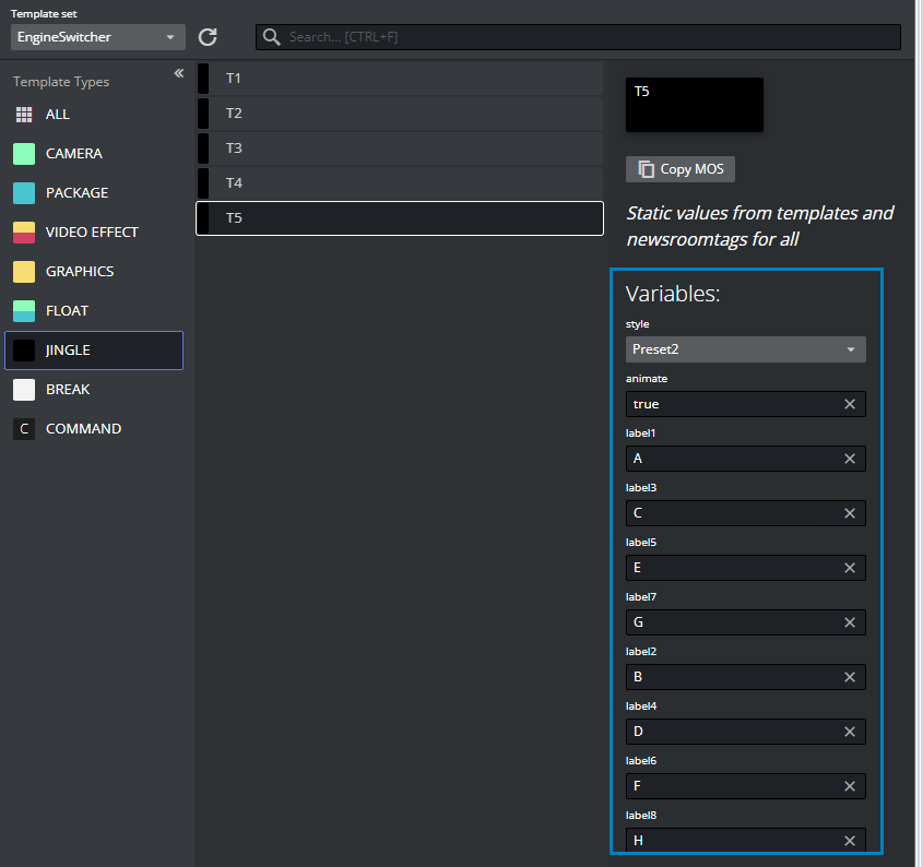

    Example 1: 2-Box Template
    Example 2: Jingle Template (to control a Preset)
    Note: To use the animate newsroom tag, set the animate dropdown option to true.

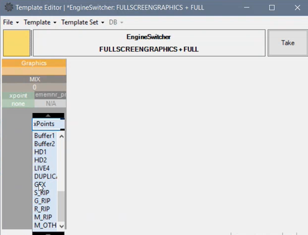

    Example 3: Full screen Graphics Template (to drive an Opener)
Graphics
Static values are set in the Viz Engine, so always choose GFX for the switcher crosspoint.
