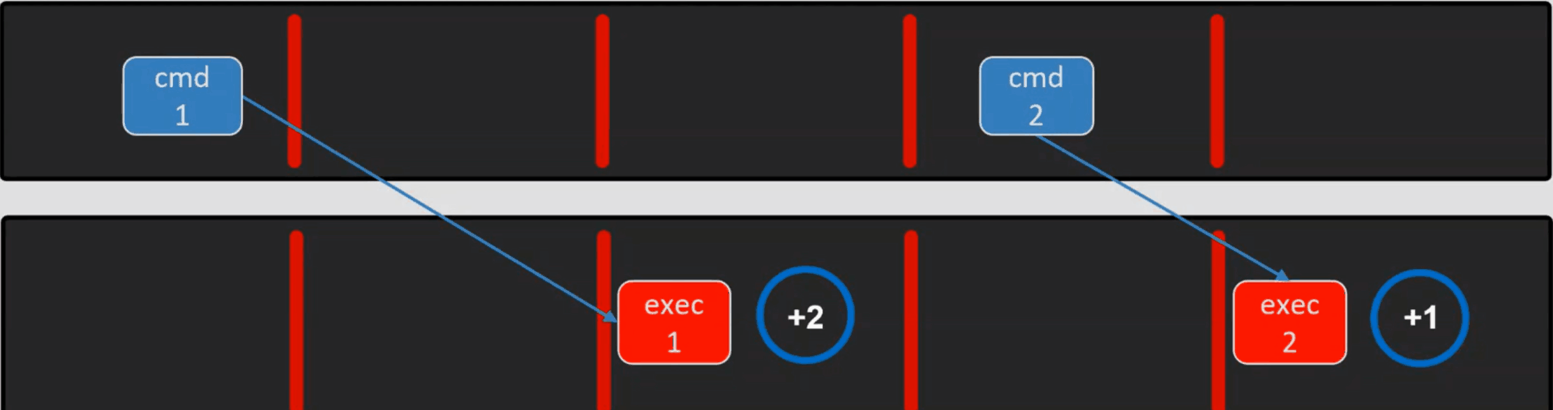

Predictable Behavior of Equipment
Unless it is known where in the frame the Viz Mosart command is issued, the response from the equipment will always be arbitrary.
In the figure below, the red bars represent the start of a frame. The outgoing Viz Mosart commands (cmd 1, cmd 2) are now aligned with the start of the frame grid (frame accurate).
Tip: The illustrations in this section are animated. If you are viewing a PDF, we recommend the online version.
This provides deterministic behavior from the controlled equipment, as the equipment is always given exactly the same amount of time to respond (in the above figure, after one frame).
Without frame accuracy, cmd 1 might be fired already somewhere in the first or second frame above, and the gear will not operate at the anticipated frame, giving unpredictable results.

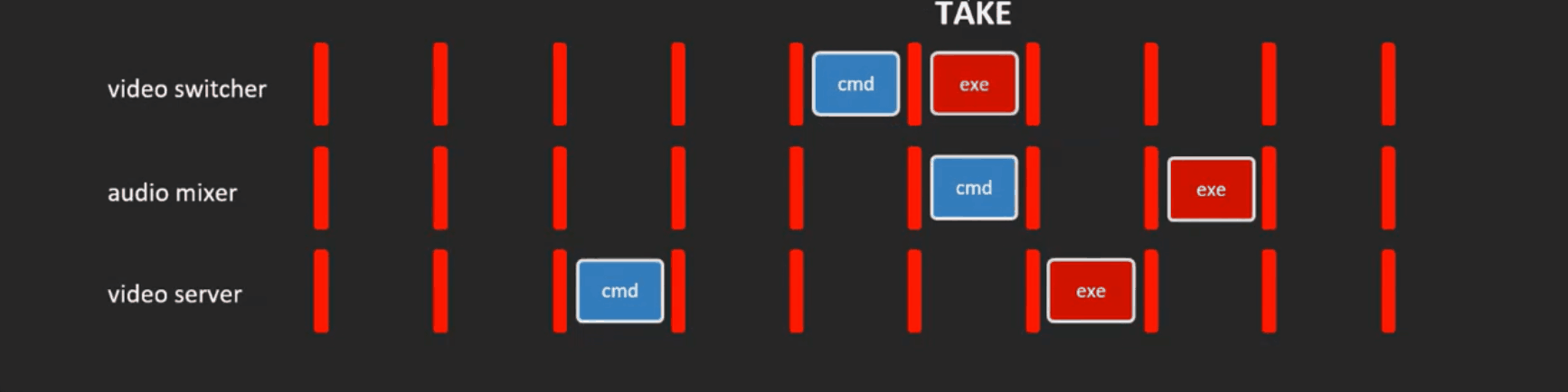

Latency Compensation
In non-frame accurate systems, Viz Mosart only compensates for delays in the behavior of the playout video server.
With frame accuracy, Viz Mosart can compensate for any latency of the controlled equipment.
As a pay-off of Predictable Behavior of Equipment, a calibration process can reveal the latency of each piece of gallery equipment.
Viz Mosart can then compensate for these delays, by always executing commands earlier.
In the figure above, the three devices (video switcher, audio mixer and video server) have millisecond latencies of 1, 2 and 3 frames respectively.
After compensating by executing each command specifically earlier, Viz Mosart can now successfully perform the TAKE command, synchronized for all three devices, from the same frame.

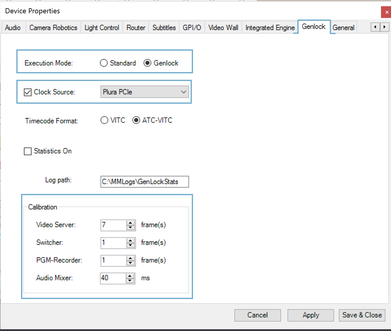

To activate frame accurate operations
Frame accuracy related settings and options are made in Av Automation.
  1. Navigate to Devices > Properties > Genlock tab.
  2. Select
    1. Execution Mode: Select Genlock mode.
    2. Clock Source: When checked, select which genlock / timecode card is installed, if any. By default, this is Plura timecode reader card (and for time being, the only option).
    3. Calibration: These are the individual latencies of the gear being controlled, as derived when calibrating the system.
  3. Click Apply, then Save & Close.

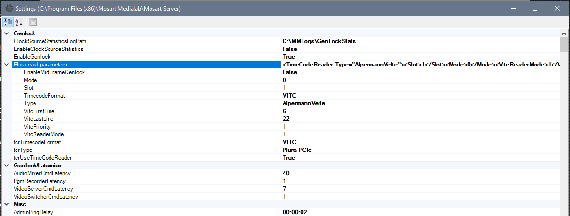

In Av Automation, you can change properties related to the Plura timecode reader card.
To configure the Plura timecode reader card
  1. Open the AV Automation Settings (user.config file).
    Use keyboard shortcut Ctrl+Shift+S in AV Automation.
  2. If any changes have been done on the Genlock tab in AV Automation properties (see To activate frame accurate operations above),
    click the Apply button or close the Properties window and enter Ctrl+Shift+Q for the changes to take effect.

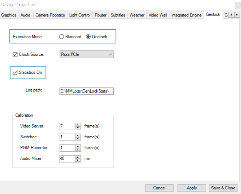

To start clock source statistic gathering
  1. You start/stop statistics in AV Automation.
    2. Execution Mode: Genlock
    3. Clock source checked and a clock source selected.
    4. Statistics On: Selected
  2. Specify the location where you wish to save the stats in field Log path.

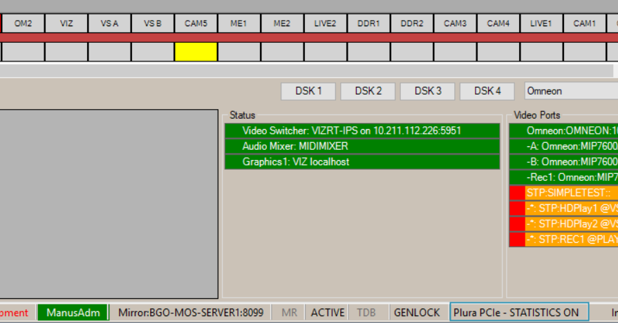

  4. the configured external clock source, if available. The file generated
  5. Check the indicator in the AV Automation status bar at the bottom of the screen, that statistics are on:
  6. Measurements will be performed for about 8-10 minutes
    You can stop the statistic measurements earlier by unselecting Statistics On, as described in step (1) above.

  • To enable the genlock logging, copy the configuration file GenLogRepositoryConfig.xml from the Viz Mosart installation folder/Mosart Server/ConfigurationFiles to your working folder (Channeltemplates or ProgramData).
  • Open GenLogRepositoryConfig.xml in an editor and configure it in a similar way as the other type of logging (refer to System Logging). These configurations also include settings about when the logging files shall be purged.
  • The genlock logging is by default generated in C:\MMLogs\Genlock every time a new show is run in Mosart (whether Story Recorder mode is enabled or not).
  • A new genlock logging file is generated when a rundown is (re)loaded in Viz Mosart or when the show is paused whilst Story Recorder is enabled.
