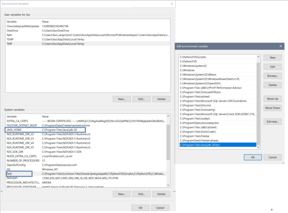

Set the JAVA_HOME environment variable and the path to the bin folder in the PATH variable:

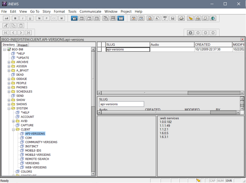

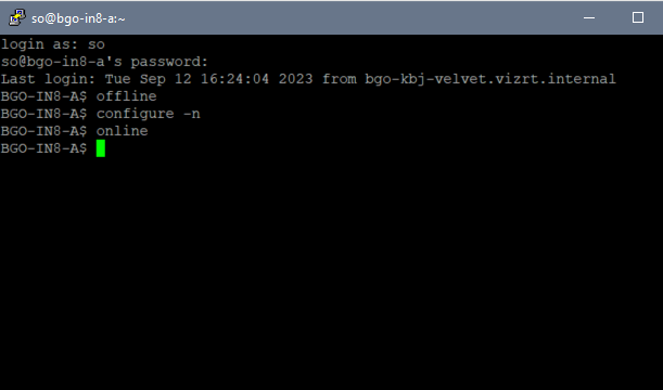

Open iNEWS client and add the Avid iNEWS Web Service version in first story of rundown SYSTEM.CLIENT.API-VERSIONS.
The version number should match the version of Avid iNEWS web service you are running (see section Confirming the Version of iNEWS Web Service).
For example:;web services1.0.0.1821.1.1.491.1.2.11.6.0.5; run offline; configure -n; online after doing changes in iNews server consoleOn the iNews server console, execute the following commands one by one:
offline
configure –n
online

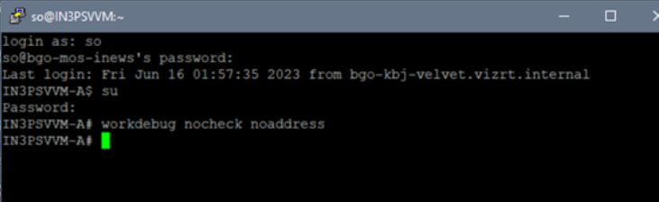

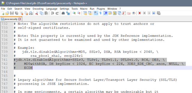

For iNews Web Service version >= 1.6.3 (i.e. Mosart Server version >= 5.4.0), disable the version check on the iNews server
Execute the following command at the console:workdebug nocheck noaddress.Enable Refresh for the rundown used for receiving status updates.

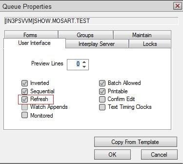

Click on the rundown name, choose Properties > User Interface.
Info: From the iNEWS Setup and Configuration Guide: Use the Refresh trait only on important queues, like rundown queues that are often modified by multiple users simultaneously.
To automatically refresh a queue, your system must spend a lot of time monitoring workstations where users are viewing that queue.
Assigning the refresh trait to too many queues that are often accessed at the same time greatly increases the amount of work your system has to do and may severely degrade its overall performance.

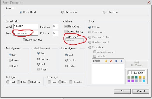

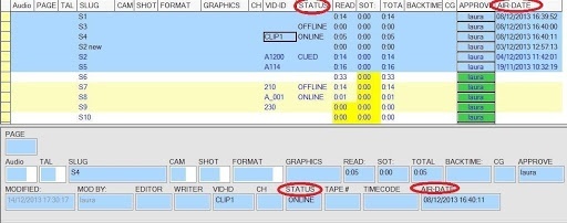

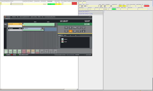

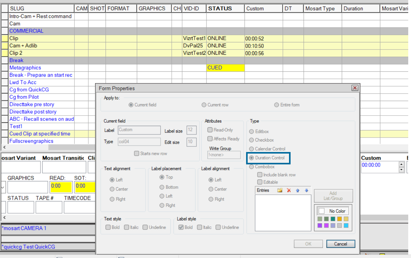

Configure the columns to receive status and air-date updates from Viz Mosart.
By default, Viz Mosart uses the field types “event-status” (STATUS) and “air-date“ (AIR-DATE) for this purpose.To enable the feature that allows Viz Mosart to send clip durations, configure a designated column in iNEWS to receive this information.
If the column type is set to 'Duration,' then iNEWS will be responsible for controlling the timecode format displayed in that column.
Alternatively, if the column type is 'Editbox,' Viz Mosart will send the clip duration in the timecode format specified within its own settings, calculated based on the frame rate configured in Viz Mosart.

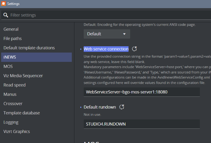

To configure web services
You perform all configurations in one place, from the common Viz Mosart Settings menu.
From the Manus Admin Console, type settings.
From the Settings menu, in the left-hand panel, select iNEWS.
In the Web service connection field enter a connection string in the following format param1=value1;param2=value2;... to establish a connection with the Avid iNEWS Web Services.
Leave the field blank if you do not wish to connect to any web service.
Required parameters are:
WebServiceServer = host:port, where the host is the machine where the iNews Web Service was installed (see the iNews Web Service Installation section above). The host can only be provided if the default port (8080) is used.
Optional parameters are:
iNewsServer Only one iNEWS server can be used by the Web Service. Specify which iNEWS server the Web Service should connect through. This field is optional if only one iNEWS server is set in the iNEWS configuration.
iNewsUsername Optional as it can be taken from iNEWS Configuration.
iNewsPassword Optional as it can be taken from iNEWS Configuration.
Type Valid values are 'iNEWS' and 'MosiNEWS
Additional configurations can be made in the AvidInewsWebServiceConfig.xml file, located in the Mosart installation folder under Mosart Server/ConfigurationFiles.

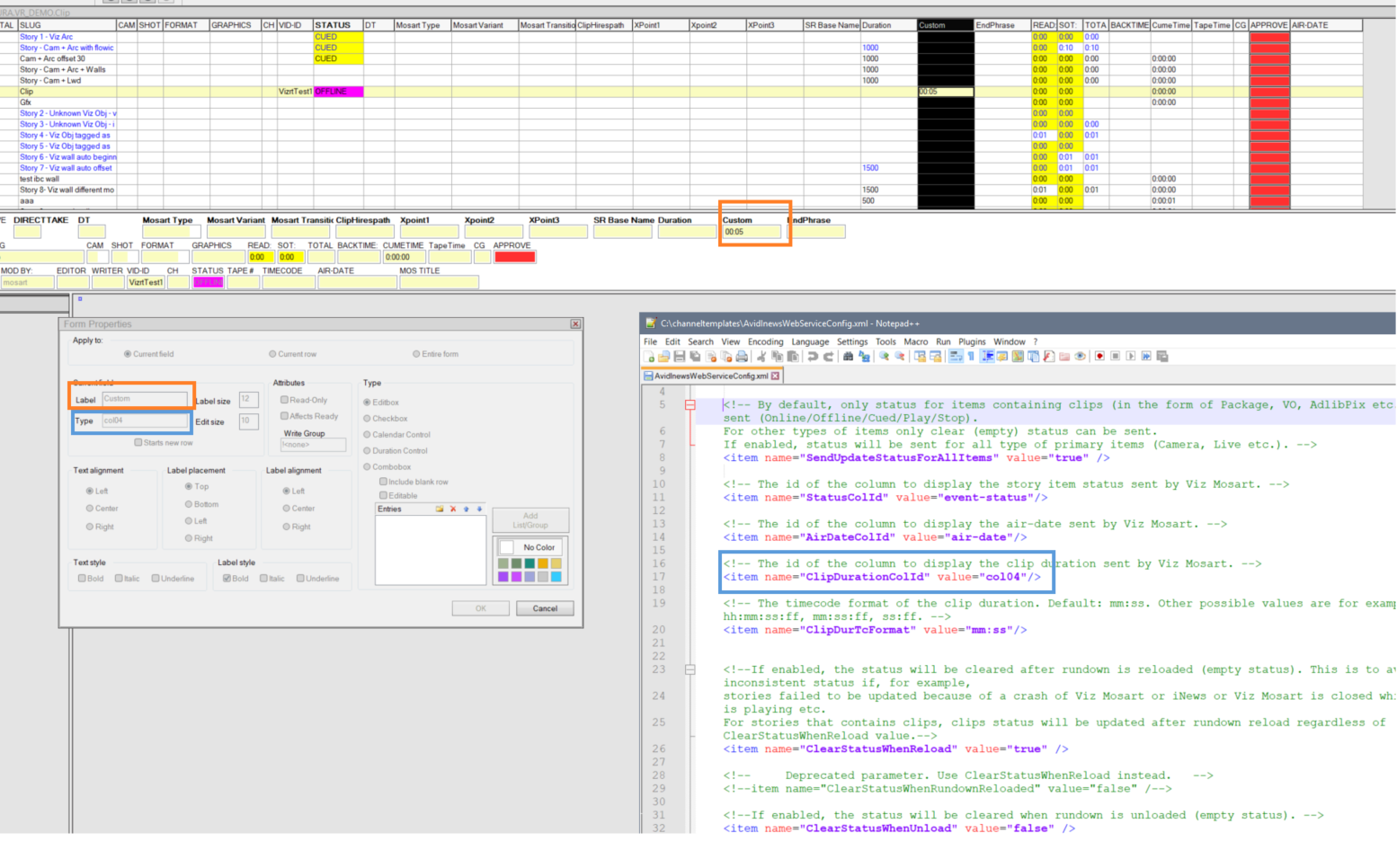

Copy the configuration file from in Mosart Installation folder\Mosart Server\ConfigurationFiles to the ChannelTemplates folder on C:\.
SendUpdateStatusForAllItems (Default: false)
By default, only status of items containing clips will be sent (Online/Offline/Cued/Play/Stop).
Not only clips given through Package or Voiceover are taken into consideration, but also Adlibpix or other ways to insert clip into a story. So for example if a story contains a Camera and an Adlibpix, than the story gets status.StatusColId (Default: event-status) The id of the column to display the story item status sent by Viz Mosart.
AirDateColId (Default: air-date) The id of the column to display the air-date sent by Viz Mosart.
ClipDurationColId (default: empty) The id of the column to display the clip duration sent by Viz Mosart.
ClipDurTcFormat This setting determines the timecode format used for displaying clip durations in the column specified by "ClipDurationColId". If the iNEWS column is not of type 'duration', the default format is 'mm:ss'. Other available formats include: 'ff', 'ss', 'hh:mm:ss:ff', 'mm:ss:ff', and 'ss:ff'. When the iNEWS column is of type 'duration', Mosart will transmit the duration in seconds. Conversion from frames to the selected timecode format is carried out based on the frame rate configured in the Manus Administrator settings.

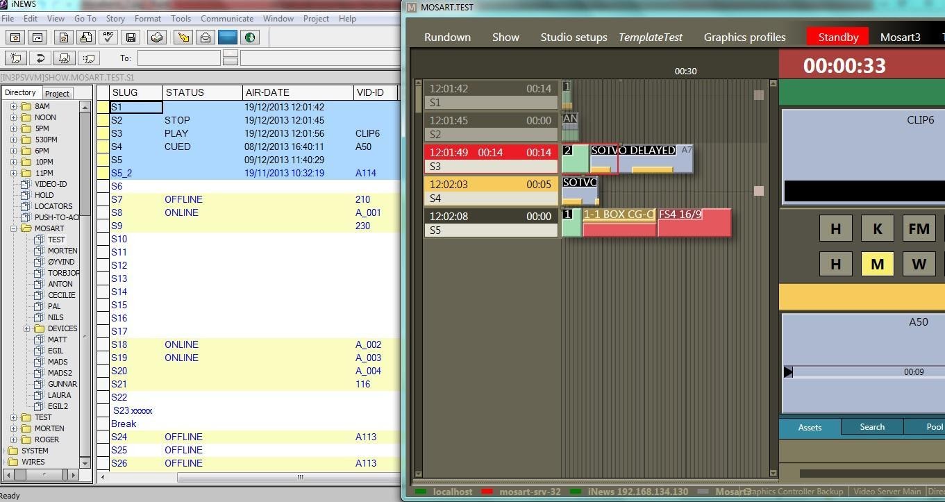

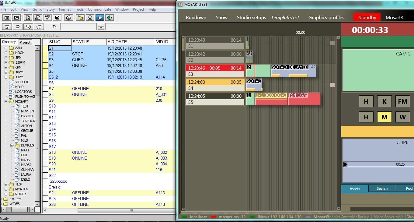

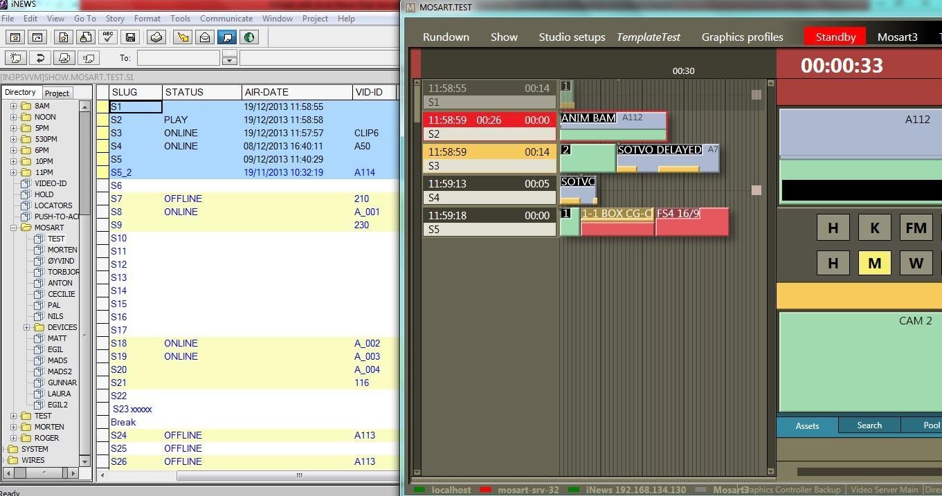

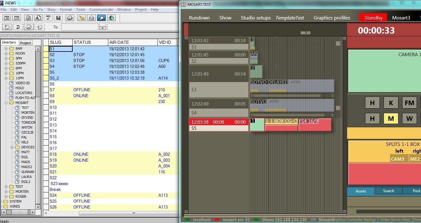

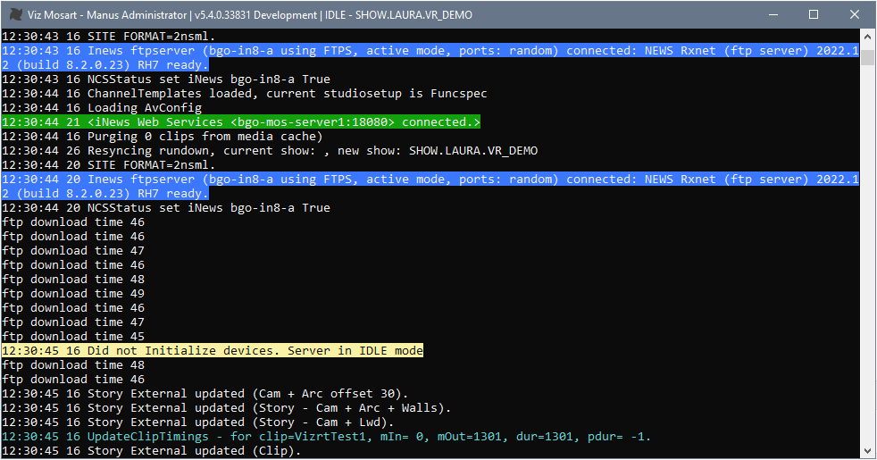

When the connection to the Avid Web Service is successful, the following message will appear in Manus Admin console:
<iNews Web Services <host:port> connected>.
The connection will be made after loading a rundown in the GUI.

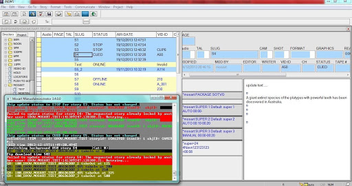

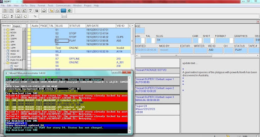

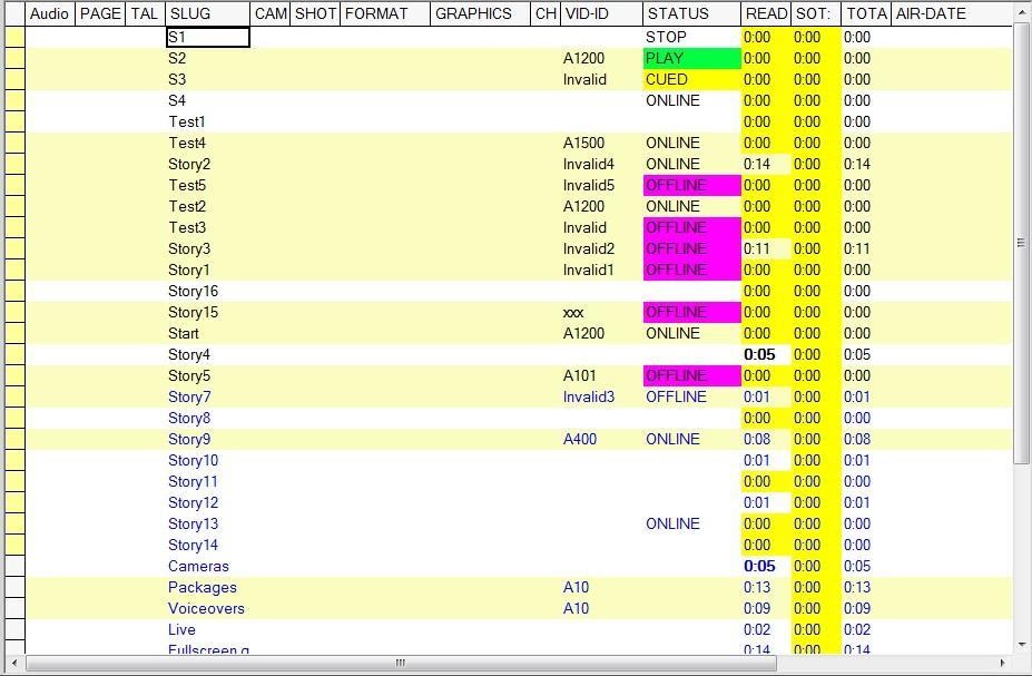

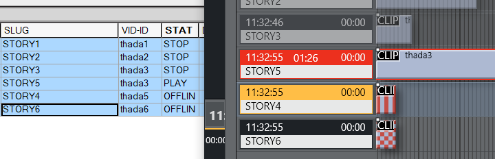

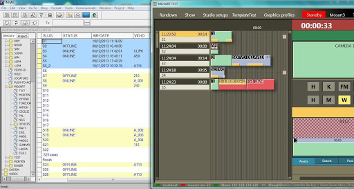

The following statuses will be shown in iNEWS:
Cued, Play, Stop, Online and Offline.
Info: Offline status also will be assigned for a clip that is to be cued but will fails cuing.
Users can move stories in iNEWS up or down. If rundown is on-air and user has been changed a position of On-Air or Next stories statuses of clips will also be changed according to status.
Note: If an iNEWS story with status OFFLINE due to "cue failed" is moved in the iNEWS playlist (even if it will be the Next story), it will be still OFFLINE and the status should stay as OFFLINE.
Check iNEWS server settings (MCS dictionary located at /site/dict/mcs) to translate the statuses shown in the iNEWS client to local statuses.
Info: No status is sent for overlay graphics.

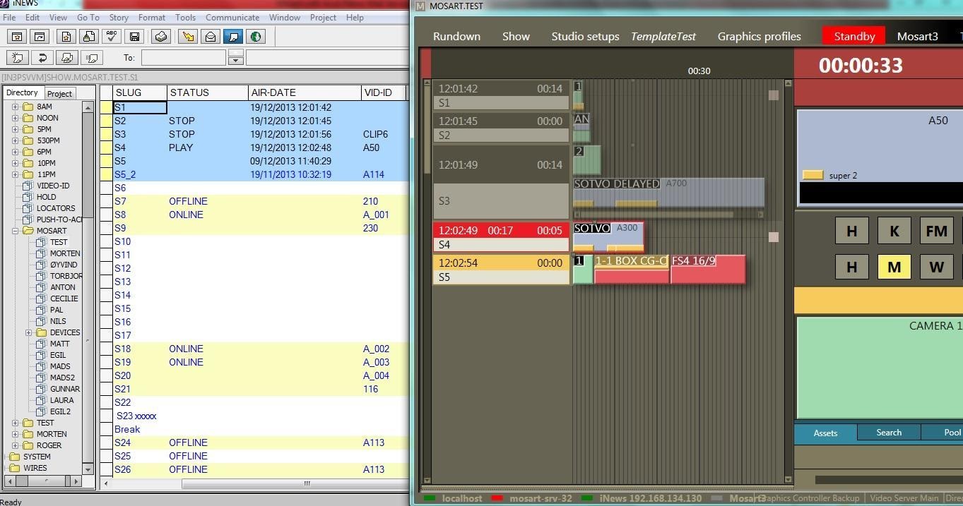

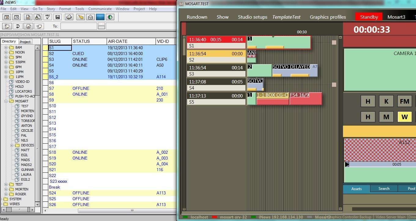

Operational Status

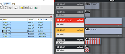

The table below shows examples of status behavior for setting SendUpdateStatusForAllItems.
If SendUpdateStatusForAllItems is false, the entire column “Story without video clips” will be cleared (no status sent for these stories).
ClearStatusWhenReload should be set to true to clean up old history.
The last row (Story has been On air) means that after the story has been run but the rundown is still on-air, the clip is no longer monitored.
If the clip subsequently becomes available or unavailable, this is not reflected in iNEWS.
Only after the rundown is reloaded, is clip status updated.
Time sequence | Story with video clips | Story without video clips (SendUpdateStatusForAllItems = true) | Story without video clips (SendUpdateStatusForAllItems = false) |
Before On air | ONLINE/OFFLINE | ||
Next story | CUED | CUED | |
Story On air | PLAY | PLAY | |
Story just taken Off air | STOP | STOP | |
Story has been On air | STOP | STOP |
Air-date is also updated to the NRCS if the parameter SetStoryAirDate is set to true in the AvidInewsWebServiceConfig.xml file.
When the parameter for SendUpdateStatusForAllItems is false, only air-date for stories that do not contain any clips will be updated.
Below are examples of status behavior:
Above, the rundown is off-air. Stories S2, S3 and S4 were updated with status of the clip it contains.
Above, the rundown is on-air. Story S1 is currently playing, but the status was not sent to the NRCS. Since S2 contains a clip, its status is set to “CUED”.
In the illustration above, Story S2 is playing and S3 is “CUED”. Since the first item in S3 is a camera the “CUED” status is not sent unless SendUpdateStatusForAllItems is set to true.
Above, Story 3 is now playing and Story 5 is “CUED”. Clip thada5 for Story 4 is broken and will be failed during cuing
And finally, Story 5 is playing and clip from Story 4 should be cued. Zebra stripes in the Viz Mosart GUI indicate an issue with availability and Story 4 is marked as OFFLINE in iNEWS

Story S4 containing only a clip, is playing. No “CUED” status has been sent for next story since SendUpdateStatusForAllItems is set to false.
Example 2
Story S5 is playing and since the story does not contain any clips, no status will be seen for this unless SendUpdateStatusForAllItems is set to true.
Only the “AIR-DATE” field shows that this story is on-air.

Play status could not be sent for story S4.
When Viz Mosart is performing the updates, it locks the form of the story or the entire story depending on the value for LockFormSectionOnly parameter and unlocks the story after the update is performed.
If the story form is locked by an iNEWS user, a message in the Manus Admin console warns the user that the status could not be sent because the story form is locked. Once the story form is unlocked, the status is updated (see Example 4).
Example 4
Story S4 is now unlocked in iNEWS and “PLAY” status has been sent.

A column must be configured in iNEWS to show the duration of a clip found in the story. A column id must also be configured in Viz Mosart, in the file AvidInewsWebServiceConfig.xml.
For status and air date, the default iNEWS columns have been used, but from Mosart 5.1.1, any column can be configured to show the status or the airdate.
When a rundown is loaded/reloaded in Mosart, Mosart will update all the stories in iNEWS with the duration of the first clip found in each story, in addition to the already existing clip availability status.

If the iNEWS server logs contain "SSL_access failed", check what version of Java you are using. SSLv3 is disabled in Java 8 by default.
A default Java 8 installation disables the SSLv3 algorithm, preventing WSAPI from connecting to the Newsroom Management Server.
To re-enable SSLv3 algorithm, open as administrator the file java.security located in the lib/security or conf\security in your JRE or JDK installation folder
/user/lib/jvm/java-.1.8.0-openjdk-1.8.0.xxxxx/jre/lib/security
C:\Program Files\Java\jdk-20\conf\security\java.security
and comment out the lines that disables SSLv3. Restarting the Apache Tomcat service once the modifications are done.

If after setting up everything as described in the document, no status is written in the Status field,
check the following:
The Status field has write permissions for the user that connects Viz Mosart to the iNEWS system.
The type of the Status field is “event-status”.
The queue must not be monitored with the iNEWS Monitor tool.
Verify also the Mosart logs or the iNEWS Web service logs located under C:\Program Files\Apache Software Foundation\Tomcat 9.0\logs\iNEWS_WS for any error related to status feedback to iNEWS.
If in the logs you encounter the error message "The Web Service version is not allowed to connect to…”, see the next section.
The Web Service version is not allowed to connect to iNEWS Server
If you encounter the issue “The Web Service version is not allowed to connect to…” in the logs, disable the version check on the iNEWS server by executing workdebug nocheck noaddress on the iNEWS server.
This issue is common with Mosart version 5.4.0 and above, where the iNEWS Web Service has been upgraded to version 1.6.3. Avid support recommends running this command after every iNEWS server reboot, following the standard connect and startup commands.
