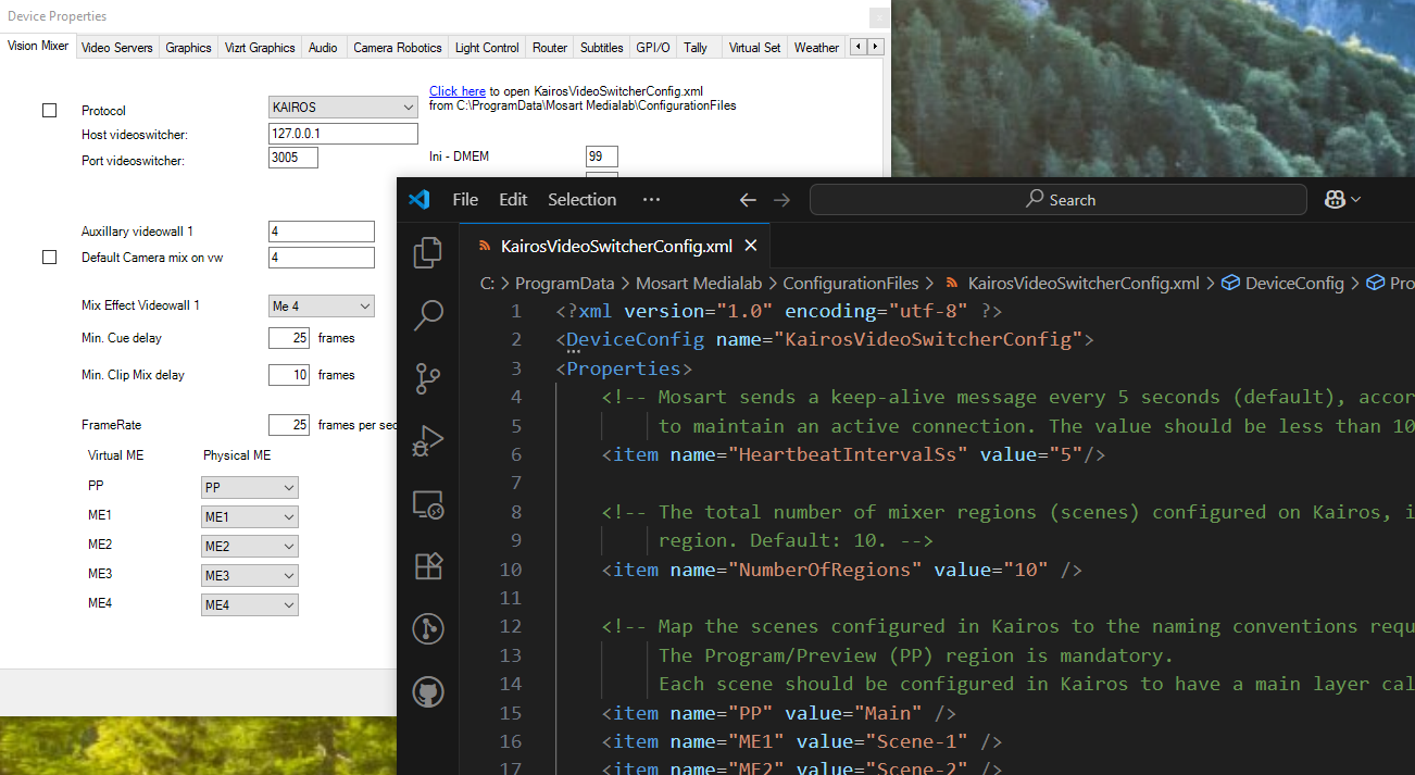

When configuring a vision mixer, the Vision Mixer tab in the Device Properties window links to any additional configuration file used by the driver.
To modify a vision mixer configuration file
  1. Open AV Automation, navigate to Device Properties > Vision Mixer tab > [Select Protocol].
  2. When a device is selected, either

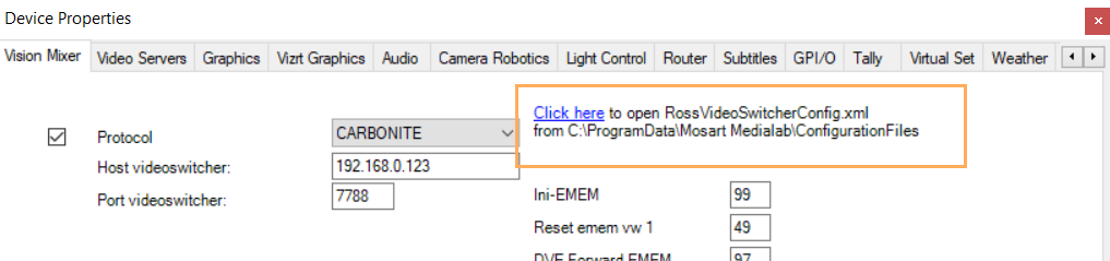

    1. There is a corresponding configurations file that contains additional settings:
      1. This is indicated by the text Click here to open xxx.
        In the example below, a Ross settings file is already located at C:\ProgramData\Mosart Medialab\ConfigurationFiles.
      2. Follow Click here to edit the configurations file.
    2. There is no corresponding configurations file:

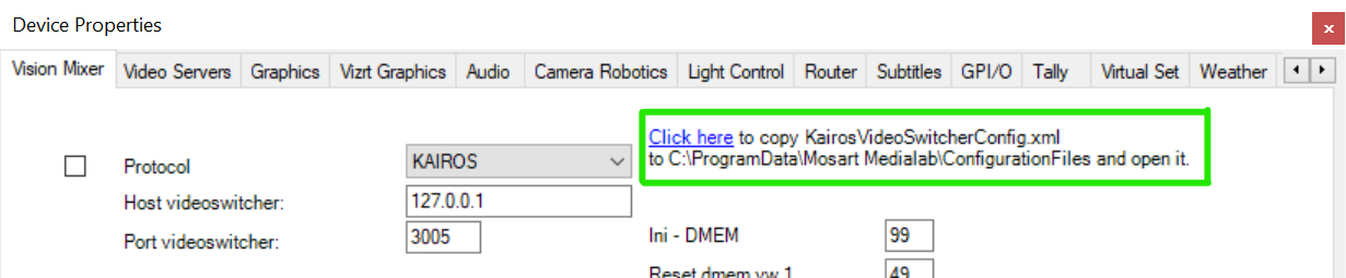

      1. You can copy an unused default file from the Installation folder.
        This is indicated by the text Click here to copy xxx.
      2. Follow Click here.

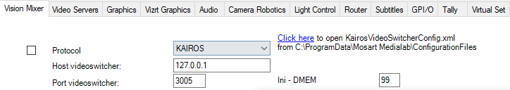

      3. The information text changes to Click here to open xxx, as the file now exists for editing, in a standard configuration file folder.
      4. Follow Click here to edit the configurations file.
  3. The configuration file opens in your default XML file editor.

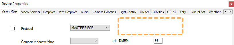

  • Information about any configuration file will not appear if the device does not require a configuration file.

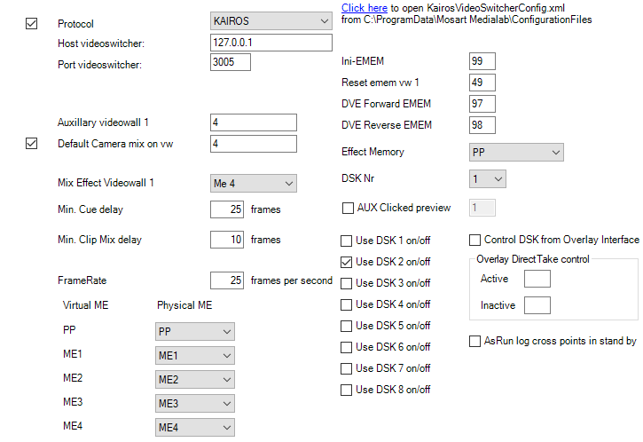

    • KAIROS

KAIROS
Port video switcher: 3005

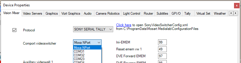

To use a Moxa NPort device as the COM port

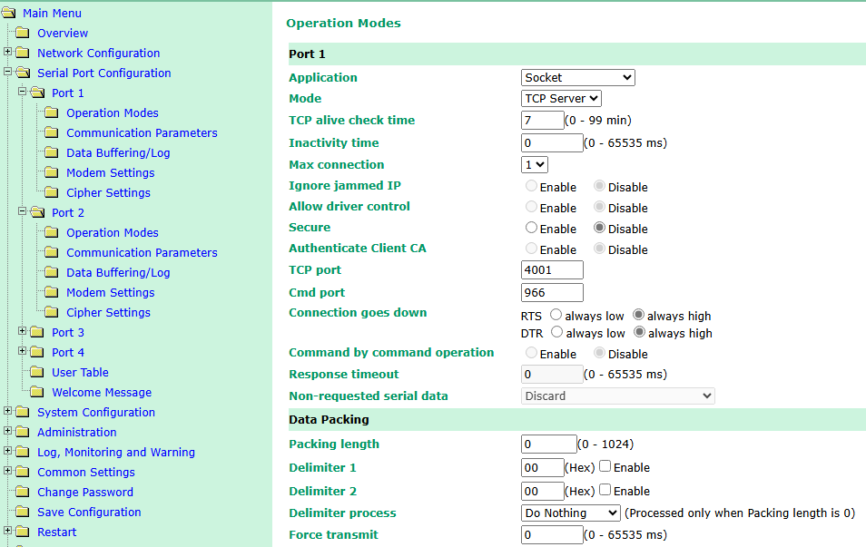

Configure the Moxa NPort device:
  1. Open the administration panel of the device and for the given serial port (Port 1 in this example) navigate to the Operation Modes section:
  2. From the Application dropdown menu, select Socket.
  3. From the Mode dropdown menu, select TCP Server.
  4. Leave all other settings with their default values, but see Info below.
  5. Note down:
    1. The value of TCP port.
    2. The value of Cmd port.
    3. The device’s hostname/IP address.
Info: In the Operation Modes panel, if the value of Max Connection is more than 1, then set Allow driver control to Enable.
In a setup with Viz Mosart main and backup Server using the same Moxa NPort device to connect to the vision mixer, Max Connection must be set to 2, allowing both Viz Mosart Servers to connect
Configure AV Automation:

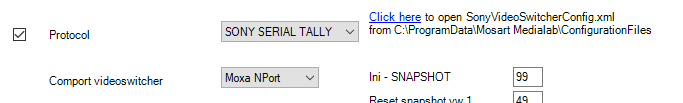

  1. From the AV Automation menubar, select Devices > Properties > Device Properties > Vision Mixer tab.
  2. On the Vision Mixer tab, from the Protocol dropdown menu, select one of the supported protocols.
  3. From Comport videoswitcher, select Moxa NPort.

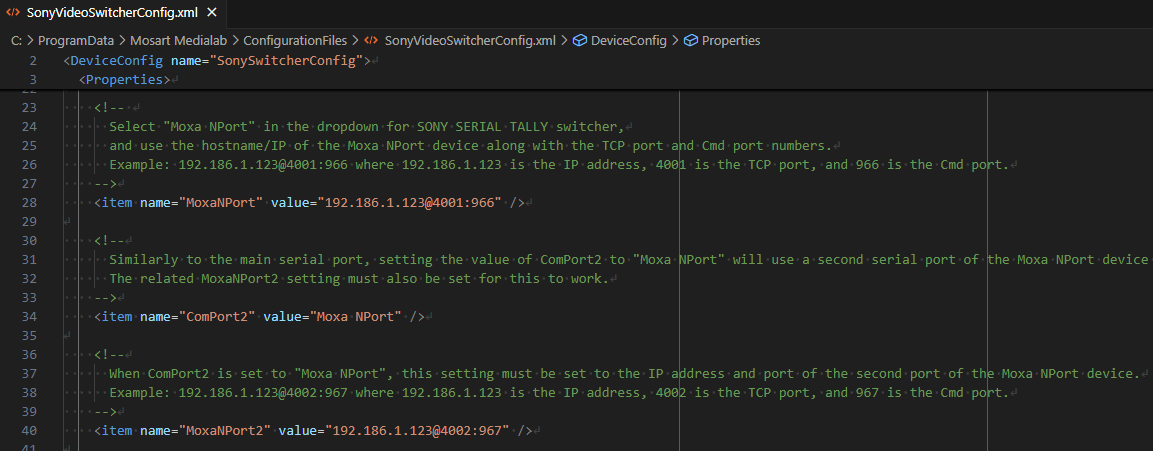

  4. Open the configuration file SonyVideoSwitcherConfig.xml by following the Click here link (next to Protocol).
    The configuration file opens in your default text editor.
  5. Modify the following settings in SonyVideoSwitcherConfig.xml, using the values you noted down earlier:
    1. MoxaNPort: value="<hostname_or_ip>@<tcp_port>:<cmd_port>"
      1. hostname_or_ip is the hostname/IP address of the Moxa NPort device.
      2. tcp_port and cmd_port are the two ports configured above for Port 1, for example: 192.186.1.123@4001:966.
    2. ComPort2: value="Moxa NPort"
      1. This is used to set up the second serial port for the SCU connection, when needed by the switcher.
    3. MoxaNPort2: value="<hostname_or_ip>@<tcp_port>:<cmd_port>"
      This is used to set up a second serial port for the SCU connection when needed by the switcher:
      2. tcp_port and cmd_port are the two ports configured above for Port 2, for example: 192.186.1.123@4002:967.
