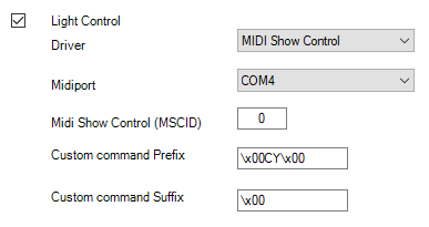

MIDI Show Control
MIDI Show Control settings
  • Midiport: System MIDI port to communicate with the light board.
  • Midi Show Control (MSCID): The MIDI Show Control ID used for communicating with the light board.
    Default: 0.
  • Custom command Prefix: The prefix test sent with the MIDI Show Control command. Characters can be escaped using the x00 where 00 is replaced by the numeric value of the character.
    Default: \x00CY\x00.
  • Custom command Suffix: The suffix sent with the MIDI Show Control command. Characters can be escaped using the x00, where 00 is replaced by the numeric value of the character.
    Default: \x00.

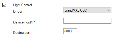

grandMA3 OSC
Info: The grandMA3 driver is implemented for the console’s software version 2.3.
  • Device host/IP: Host name or IP address of the console.
  • Device port: The port number that grandMA3 uses to receive OSC messages.
In a simple setup, one OSC In&Out configuration should be created on grandMA3 that enables receiving commands from Viz Mosart.
For redundant Mosart Server setups, it is possible to create two OSC In&Out configurations on the device, matching IP addresses to main and backup.
Viz Mosart supports OSC 1.0 via TCP.
