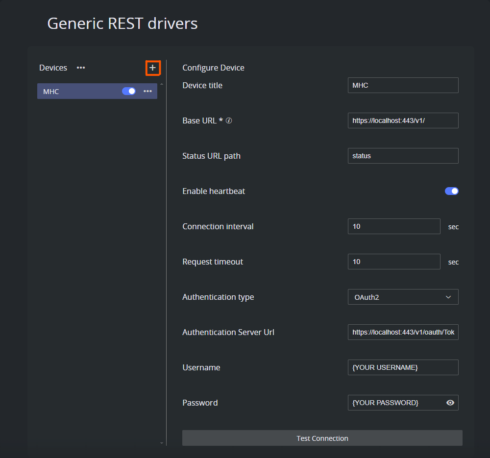

Prerequisites
MHC installed on a machine and set up with at least 1 robotic camera.
To configure REST API control of a robotic camera
Open AV Automation and from the menu bar, navigate to Devices > Settings.
Scroll down the Settings menu to Generic REST drivers.
Add a new driver by clicking the Plus (+) sign.
Fill in required details, following the example below:
Note: Base URL and Authentication Server URL are the machine running MHC, not localhost.
Click Save and close the menu.

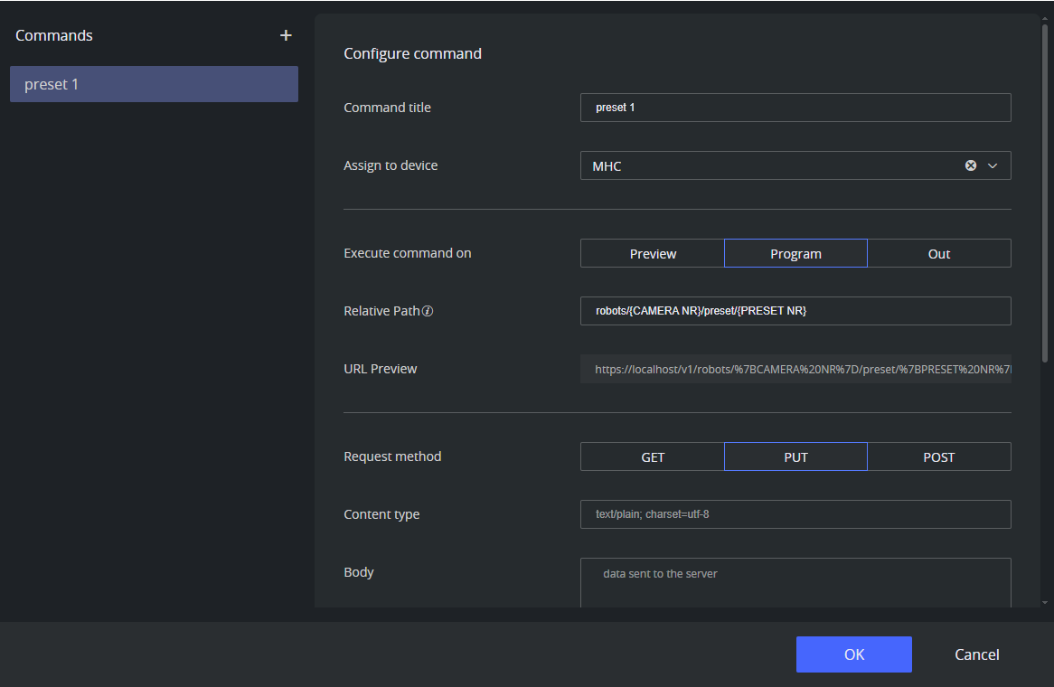

Open Template Editor.
(AV Automation > Devices > Template editor).Select File > New to create a new template.
Right-click in the template’s dark gray area then Enable > Generic Rest Commands.
Add a command by clicking the Plus (+) sign in the left-side Commands panel.
Note:
{CAMERA NR} is the index of the camera you want to use (starting at 0), and {CAMERA NR} is the index of the preset you want to load (starting at 0).
If you want to load preset 3 of camera 2, you would do robots/1/preset/2.Set Execute command on to your requirement, it need not be Program as shown in the sample screenshot.
Click OK.
Save the template.
Add this template to a Mosart rundown.
Whenever it is taken, it triggers MHC to move the selected robotic camera to the selected preset position.
