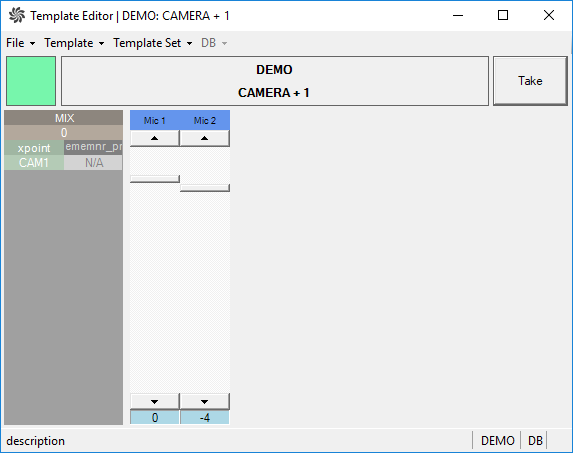

You create and edit individual templates and template sets (standalone and hierarchic) in the AV Automation application, Template Editor.

Templates in the AV Automation Application
To create and modify show templates
With a combination of mouse-over and contextual menus, an administrator can create and modify the templates that comprise a Viz Mosart-driven show.
This is presented in more detail later in this section.
To browse your show templates
From the AV Automation console program (running on the Viz Mosart server), navigate to Main menu > Devices > Template editor.
Templates displayed in Template Editor provide detailed information about their origin, purpose and control settings.
