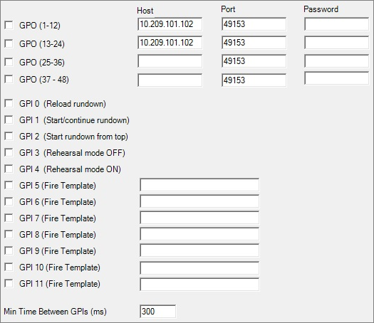

GPO
GPO (1-12) (check box): Enables a Web-IO box for the first group of 12 GPOs. Note that this has to be configured for GPI 0-11 to be enabled.
GPO (13-24) (check box): Enables a Web-IO box for the second group of 12 GPOs.
GPO (25-36) (check box): Enables a Web-IO box for the third group of 12 GPOs.
GPO (37-48) (check box): Enables a Web-IO box for the fourth group of 12 GPOs.
Host: Hostname or IP address to the Web-IO GPI/O box.
Port: Port on the Web-IO GPI/O box.
If configured as 80, Mosart will use the HTTP Web-IO protocol, while for other Port values Mosart will use the Binary Web-IO protocol.Password: Defines the password, if needed.
Note: In Template Editor for the GPIO device, you enter n for GPO n+1. For example, with 0 for GPO 1 … 47 for GPO 48.
GPI
Twelve GPI signals can be assigned in Viz Mosart. These GPI signals are received on the GPI/O device configured in the GPO (1-12), see above.
The first 5 GPI signals, GPI 0-4, are connected to fixed Viz Mosart commands. The GPI signals 5-11 can be configured to an arbitrary selection of operations.
GPI 0 (check box): Reload rundown. The timeline is stopped and the current rundown is reloaded.
GPI 1 (check box): Start/continue rundown. Will trigger the TAKE-NEXT event and with that start the timeline or advance to the next timeline element.
GPI 2 (check box): Start rundown from top. Will start the rundown from the first story..
GPI 3 (check box): Disable rehearsal mode.
GPI 4 (check box): Enable rehearsal mode.
GPI 5-11 (check boxes/text boxes): Enables firing of the template or command given in the text box - see below.
Min Time Between GPIs (ms): Threshold time before a new trigger command will be processed.

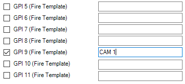

Each of the GPI signals 5-11 may be assigned to either trigger a Viz Mosart control command, trigger an arbitrary template from the active template set or trigger a direct take, as follows.
Triggering a Template
Taking a template using one of GPIs 5 to 11 (Fire Template) adds the corresponding template to the timeline.
To Trigger a Mosart Template
This can be used to trigger a Mosart template from the active template set:
Syntax: [TemplateType]|[Variant]
Example: Camera|1
