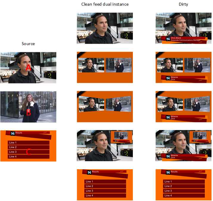

Clean and dirty feed
A video signal that does not have any graphics or effects embedded, is called a clean feed.
A video signal that has graphics or effects enabled is called a dirty feed.

Working with Clean and Dirty Feed
Engine Switcher Terminology
Clean Feed
The clean feed provides:
Full screen video live sources
Full screen clip sources
Full screen GFX elements
Butterfly effects (PiP effects)
Dirty Feed
The dirty feed adds overlay graphics on top of the clean feed output.
Clean Feed Engine | Dirty Feed Engine | |
Front Layer | Transition Effects | Overlay scenes |
Main Layer | Full screen GFX | Overlay scenes |
Back Layer | Not used |
Example: Output of clean and dirty feed.

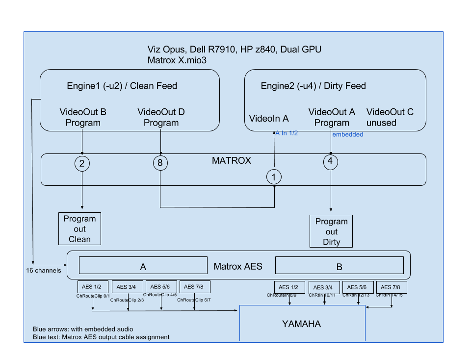

Hardware Configuration
The current clean feed solution needs a hardware wiring using a short SDI cable from the SDI OUT D (pin 8 on the X.mio3) to SDI IN A (Pin 1). Engine Switcher is using the "Zero Frame Delay" option within Viz Engine 5.1. This provides a direct signal copy from Input A to Output A without introducing an additional delay. Therefore there is no need to load a keyer scene to the dirty feed engine.
To configure the Matrox board
Matrox Pin Out for Engine Switcher clean and dirty feed setup (Zero Frame delay):
Routing of video signal on the Matrox board.

To configure dual GPU dual engine setup
Typically the Engine Switcher's dual engine setup comes with two GPUs. The first card is used for connecting the monitor, the second for actual rendering purposes.
Config files and desktop shortcuts will have to be named as follows:
Engine 1: Clean feed
<machinename>-1.cfg
Desktop shortcut uses "-u2"
Engine 2: Dirty feed
- <machinename>-3.cfg
- Desktop shortcut uses "-u4"
Note:
The digit behind the "u" depends on how the graphics board is installed in the machine.
If there are 2 GFX boards, the weaker one is used for the monitor, not for rendering. This weaker board is typically not addressed.
So the second video boards gets -u2 (clean) and -u4 (dirty).Since Viz Artist always runs on the first GPU, a third config file named <machinename>-0.cfg must be employed, in case changes in the scene have to be performed on this particular scene.
As Viz Artist will run on the weaker GPU, performance of the scene while being loading on this Engine will be limited.

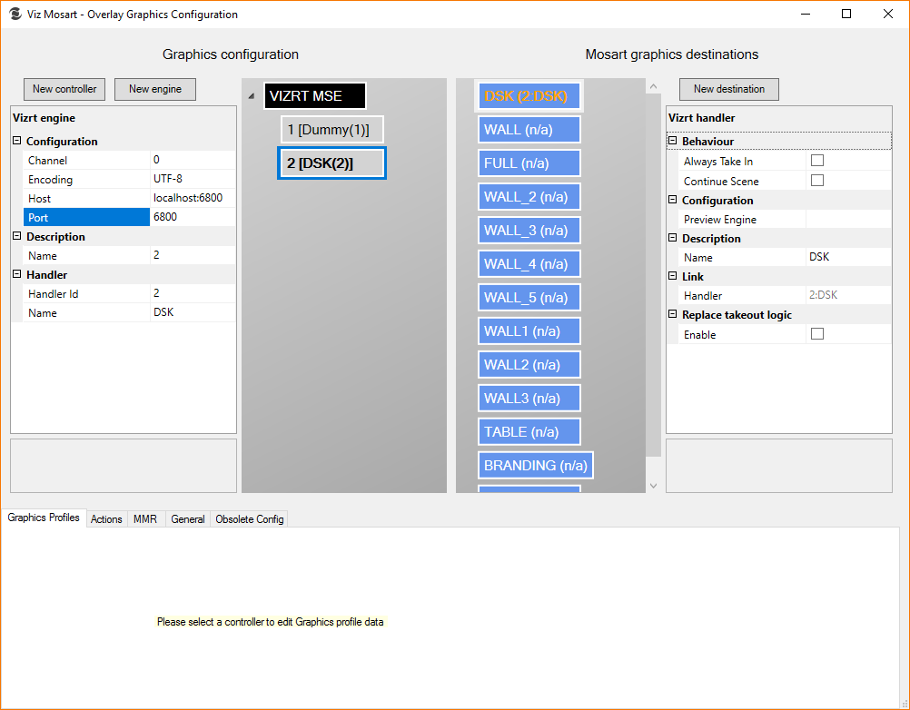

Viz Mosart Overlay Graphics Configuration
To set up Overlay Graphics configuration
The Overlay Graphics applications configuration needs modifying, to send Overlay scenes to the dirty feed on Port 6800 (instead of the default port 6100).
From the Viz Mosart server machine, open the Mosart Graphics Interface application (MMOverLayGraphicsInterface.exe).
From the menu bar, select Settings > Properties.
Fill-in as illustrated:
Restart the applications to save changes.

To configure clean feed
The clean feed configuration should be based on the file provided in the bundle installer.
Configure Program and Contains Alpha to Inactive.
See Video out documentation to configure the program output of the engine to output program (fill) on VideoOutB and VideoOutD assigned by setting the Map to Viz channel t for reference.Configure the video inputs.
Start by disabling video 1 by setting VideoInA to Unused.
Set all other to the corresponding Video number
(VideoInB to Video2, VideoInC to Video3 etc).
Changes done with the configuration tool are stored in
<machinename>-1-0.cfg.Video (Matrox board configuration)
Mapping Live Outputs:
Set Out B and Out D to Program
Set Out A and Out C to U unused
Set In A to unused
Mapping Live Inputs:
In A set to unused
In B set to Live 1
In C set to Live 2
...In H set to Live 7
Activate Live 1 to Live 7 in Input config.

To configure dirty feed
See the Viz Engine Guide, section Software Configuring Viz > Video Output for reference.
Changes should be done uses the Configuration Tool.
Configure the program output of the engine to output program (fill) on VideoOutA assigned:
Set Map to Viz channel to Program
Set Contains Alpha to active.
Configure the video inputs by setting all of them to Unused.
If not already set by the preloaded dual channel profiles, set communication General communication port on this engine to 6800.
Verify that the changes are stored in
<machinename>-3-0.cfg.Video (Matrox board configuration)
Set Out A to Program
Set Out B, Out C and Out D to Unused
Mapping Live Inputs
Set all Inputs to Unused
Audio
Audio on the dirty feed is not supported by default.
Routing of the AES channels is performed manually in the Viz Engine's configuration file.Additional settings
- Turn on Zero Frame Delay option.
