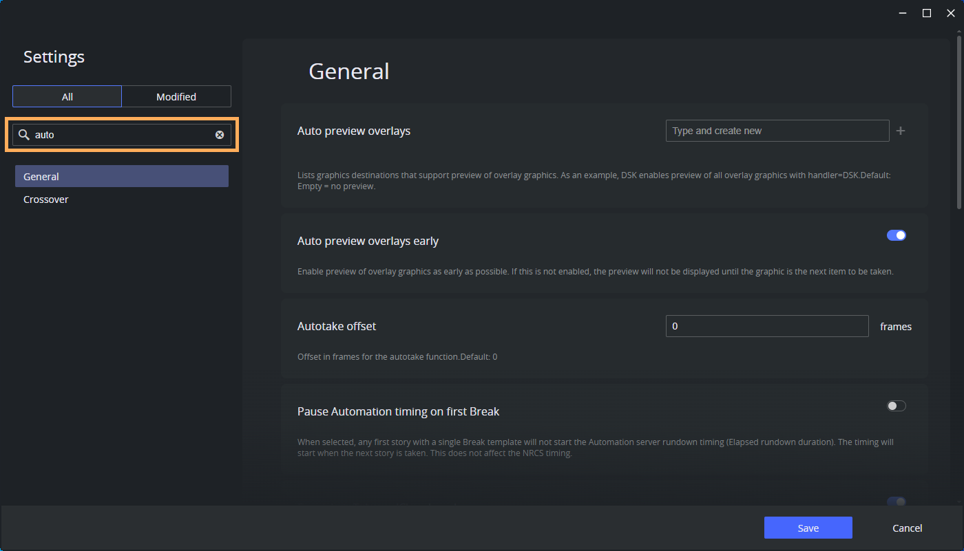

To simplify setting up the connection to a MOS-based NRCS, the Manus Admin console includes a Settings utility.
  1. Open the Settings utility by typing settings followed by ENTER.
  2. From the General settings section, under NCS Type, select the flavor of MOS that the NRCS uses.
Tip:You can search for a specific value from the Search box.
The editor comprises several sections, each dedicated to a collection of settings:
