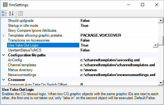

Enabling Take Out Logic
  • Take out logic is enabled via setting Use Take Out Logic in Manus Administrator as shown in the figure below:
Note: Enabling take out logic applies to non-Vizrt graphics only.
