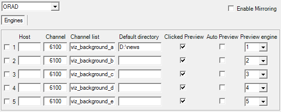

Orad Settings
  • Engines: Check to enable the connections to the Orad engines. Viz Mosart supports five graphics engine connections.
  • Host: Hostname or IP address to the Orad engine. Include the IP port number, for example 172.20.51.55:10001.
  • Channel: Output channel from the Orad engine. Use 0 for default channel.
  • Channel list: Output channel(s) to be cleared when Channel is set to 0.
  • Default directory: The folder on the Orad engine that contains the graphics templates.
  • Clicked Preview: Click on full-screen graphic element to send to the Preview engine.
  • Auto Preview: Automatically send full-screen graphic element to the Preview engine.
  • Preview engine: Defines the Orad engine number.
