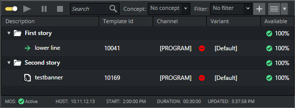

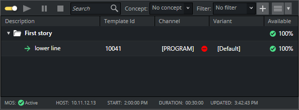

  3. Select the playlist and click OK. The MOS playlist for the running order should open.
  4. Verify that MOS status in the lower left is Active and has a green checkmark, indicating the playlist is MOS active.
    If not and status is indicated in red as Inactive, right-click on the icon and select Request.
  5. Add a new story and see that Viz Trio receives the update.
