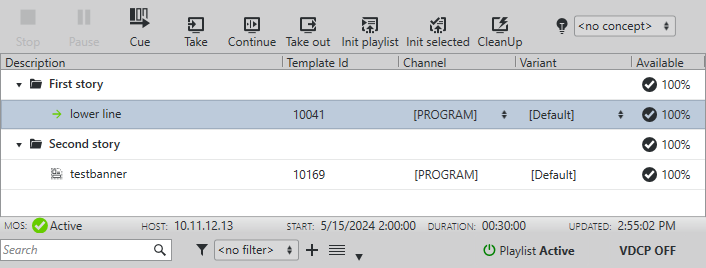

  1. Select the newsroom system, and then select one of its running orders. Double-click the running order to open and monitor it.

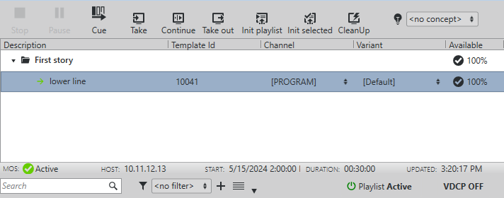

  2. Verify that MOS status in the lower left says Active and has a green checkmark, indicating the playlist is MOS active.
    If Inactive (and is red), right-click on the icon and select Request.
  3. Check that the playlist has the same story and items as the one created in the NCS.
  4. Add a new story and see that Viz Pilot receives the update.
Info: All items in a running order need a MOS Object, created in the NCS client, to be visible in the Viz Pilot playlist.
