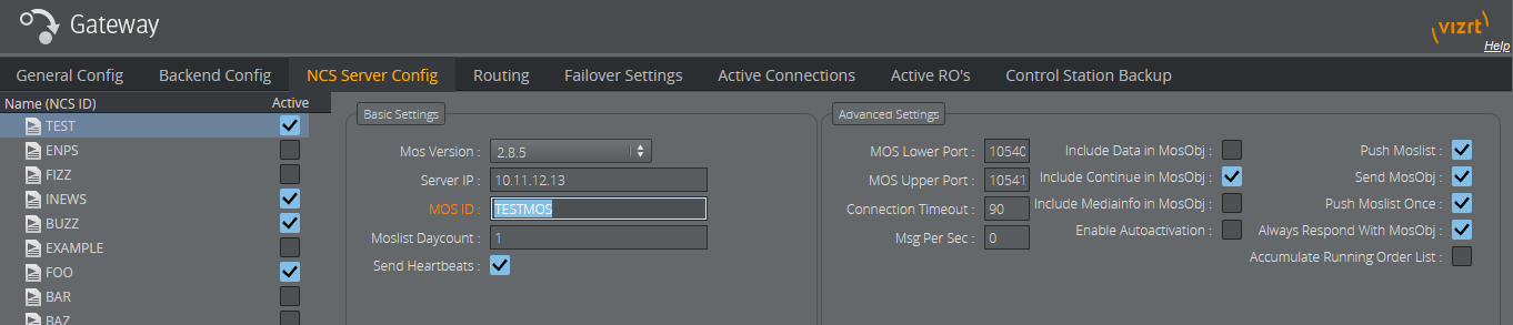

The NCS Server Config tab has three panels: Name (NCS ID), Basic Settings and Advanced Settings.
Tip: Whenever a setting is changed, click the Apply Settings button to enable the new settings. This also requires the Gateway server to be restarted. All settings are individual settings for each Newsroom Computer System.

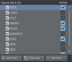

Name (NCS ID) Panel
The Name (NCS ID) panel contains the list of NCS servers that are configured to be handled by the Gateway. The Gateway is able to connect to multiple NCSs from different vendors.
Active NCSs
Click the Active checkbox to decide which NCS configurations take effect.
If an NCS is inactive:
  • No connections are established to this NCS.
  • Any messages the NCS sends to the Gateway are not recognized.
To add a new NCS
  1. Click the + Add New button.
  2. Enter the newsroom system’s ID (NCS ID).
  3. Click OK.
To create a duplicate NCS
Create a new entry based on the settings of an existing entry.
  1. Select the NCS you want to duplicate.
  2. Click the Duplicate button.
  3. Enter the NCS ID.
  4. Click OK.
To remove an NCS
  1. Select an item from the NCS Server list.
  2. Click the Remove button.
  3. Click OK to confirm the removal of the NCS.
Note: You must restart the Gateway server for changes on the NCS Server list to take effect.

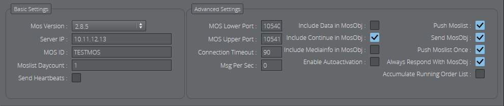

Basic Settings
The basic settings depend on which MOS version is used for the communication between the Gateway and an NCS server. Two examples, i.e., one for MOS 2.6.0 - 2.8.5 and one for MOS 4.0.0, are shown below.

NCS Server Settings MOS 2.6.0 - 2.8.5

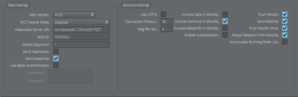

NCS Server Settings MOS 4.0.0
