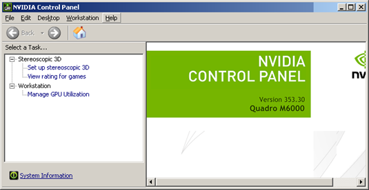

Missing NVIDIA Control Panel Settings
Please perform a re-installation of the NVIDIA driver as mentioned in section Steps to recover from severe NVIDIA Mosaic driver related issues. A known cause for this behavior are physical changes to an existing video-wall setup, for instance adding or removing monitors, while operating in Mosaic mode.
NVIDIA Control Panel Crashes
There is a possibility that the NVIDIA Control Panel crashes during Mosaic configuration, although this is not considered a reliable indicator on whether a driver re-installation is required or not. Sometimes the NVIDIA Control Panel can be restarted manually, and usually rebooting the machine should suffice.
Please refer to section Steps to recover from severe NVIDIA Mosaic driver related issues if the issue persists.
