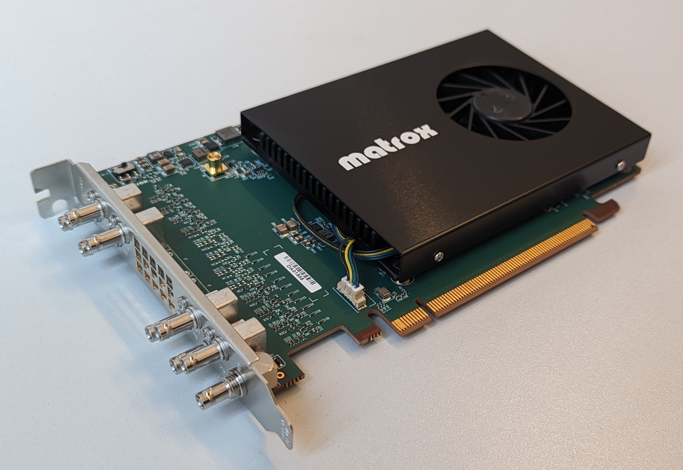

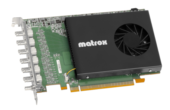

Matrox X.mio5 and DSX LE5 are two closely related series of PCI Express video boards with configurable SDI connectors. All connectors support HD and 3G SDI signals, and some support 12G as well. The main difference between the two series is that X.mio5 cards have an onboard video mixer to perform DVE effects, which DSX LE5 cards lack. The cards use either 8 or 16 PCI Express Gen 3 lanes.

Viz Engine only supports a few cards from this series: X.mio5 X2, X.mio5/8, and DSX LE5/4 LP.

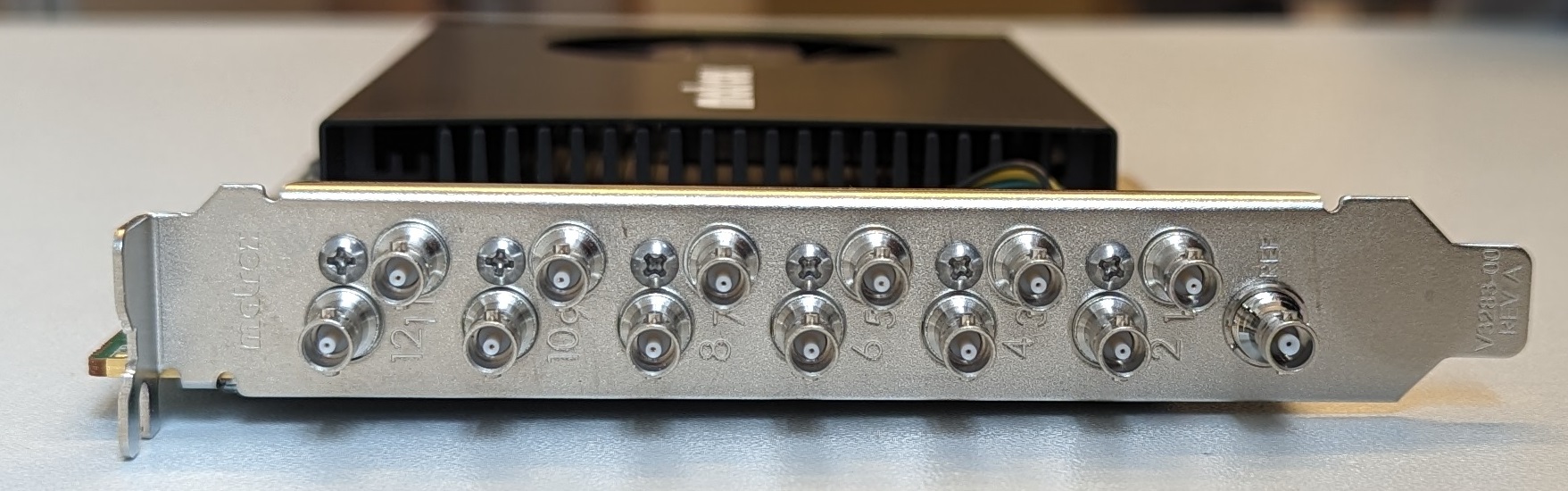

X.mio5 X2
The Matrox X.mio5 X2 is the strongest card of the series with 12 SDI connectors, one Genlock and a powerful onboard compositor.
This card requires Viz Engine 4.4 or newer.

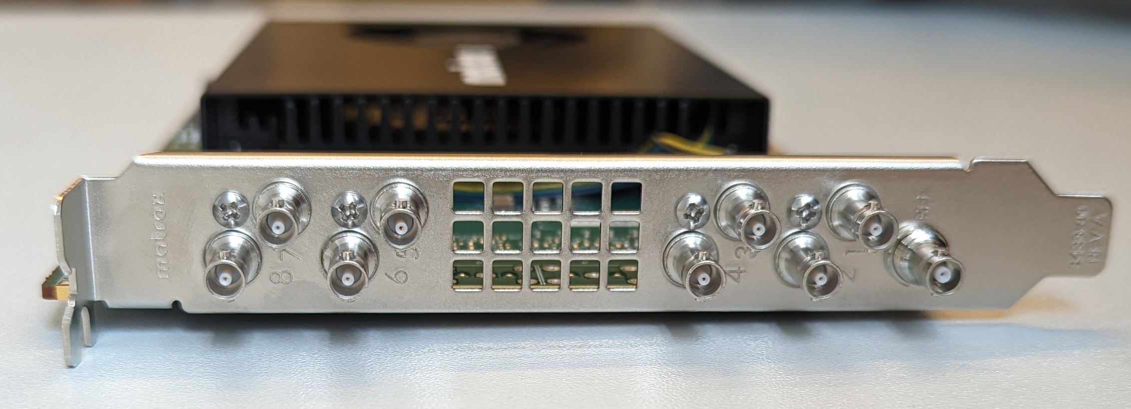

X.mio5/8
The Matrox X.mio/8 has eight SDI connectors, one Genlock and an onboard compositor.
This card requires Viz Engine 5.0 or newer.

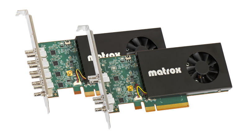

DSX LE5/4 Low Profile
The Matrox DSX LE5 LP/4 is a low profile card with four I/O SDI connectors and one Genlock.
This card requires Viz Engine version 5.0.0 or later.
