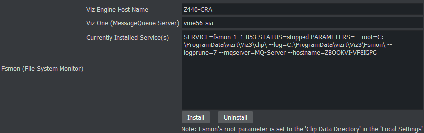

  4. Fsmon (service only):
    1. Enter the host name of the localhost.
    2. Enter the host name of the Viz One Message Queue Server.
IMPORTANT! The localhost name must be exactly the same string that was entered in the Viz One as host name for the Viz Engine (it must be the exact same string as seen beside Host on the Servers page).

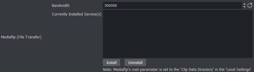

  1. MediaFTP (service only): Set the transfer bandwidth (Kbits per second), as required.
Note: Mediaftp is installed with the -a flag. This assumes that the default Viz One user/password combination is: vtrsync/vtrsync. Mediaftp installs, but does not work, if the user/password combination is different (see Adding a Viz Engine in the Viz One Administrators Guide).

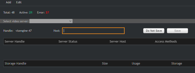

To Configure Viz One
Viz Engines are configured a video server with local storage on Viz One side. For detailed information, please refer to the Viz One documentation. Before adding any Viz Engine to Viz One, make sure that FSMon and MediaFTP are running on Viz Engine.
  • Login to Viz One Studio.
  • Switch to Administration.
  • Click on VideoServers.
    • Choose Add - VizEngine.
    • Enter the Viz Engine host name. Be aware that this is case sensitive.
  • Click on Servers
    • Verify the Credentials for the FTP/ARDFTP access are correct.
Once configured correctly, Viz Engine must show up as Active in the Servers Dashboard.
