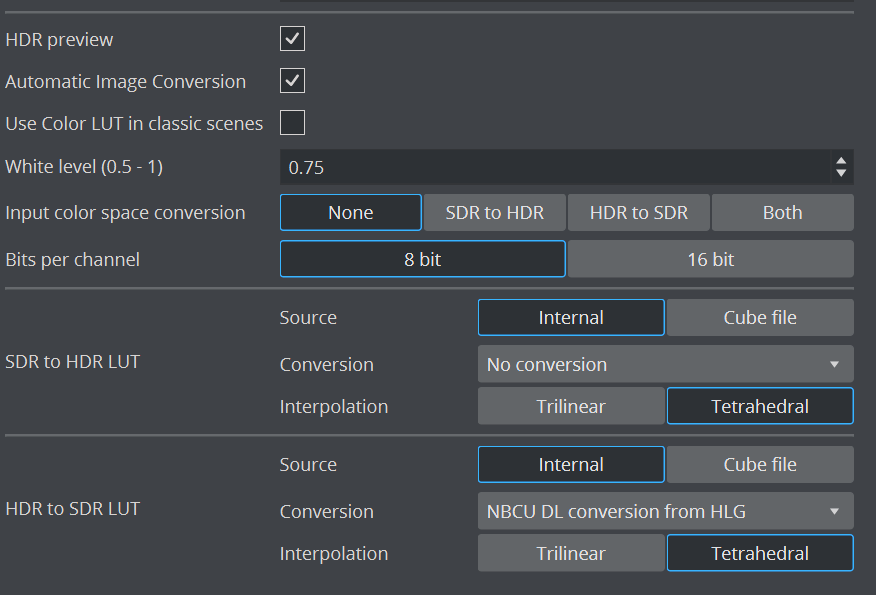

Render Options
General Settings
  • HDR preview: Enables the OS support for HDR preview windows.
  • Automatic Image Conversion: Viz Engine tries to adjust the color space for any image source.
  • Use Color LUT in classic scenes: Enable this setting if the engine output is HDR, and classic scenes are being used. Viz Engine pipeline automatically handles this.
  • White Level: Used to scale between the linear scene color space, and the output HLG signal. The scene light value 1.0 is scaled to the white level on the HLG output. The default value is 75%. 100% white selected in sRGB in the color picker, is scaled to the same value.
  • Input color space conversion: If enabled, Live and Clip input textures are converted between SDR and HDR. The renderer then picks the appropriate version of the texture, depending on where it is used. It is recommended to use Both, for any setup with HDR.
  • Bits per channel: Using 16 bits per channel avoids banding.

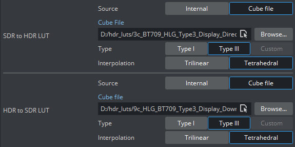

Color Conversion LUTs
Viz Engine uses lookup tables (LUTs) to convert between SDR and HDR. Some LUTs are built-in, while LUTs from third parties can be imported from cube files. For most workflows two LUTs are required, one to convert from SDR to HDR, and another to convert from HDR to SDR. Using a matching pair of LUTs reduces round trip conversion losses.
Interpolation: Lookup tables contain the converted colors for a relatively small set of input colors. For other colors, the output is interpolated. Trilinear and tetrahedral interpolation are two different mathematical approaches. Tetrahedral interpolation is generally recommended, especially for HDR to SDR conversions.
Built-in LUTs
There are three built-in LUTs: An SDR to HDR conversion based on ITU BT.2048-8, and a pair of LUTs developed by NBCUniversal Media, LLC. All three encode display light conversions between SDR and HLG, and support extended video range.
External LUTs
HDR conversion LUTs are available from several third parties, notably the BBC and NBCU. To import an external LUT, select Cube file as the Source, and set the file path.
The BBC established a nomenclature of different LUT types, depending on the processing range. Viz Engine supports Type I LUTs (which are limited to nominal range), and Type III LUTs (which support extended range). Configure the type that matches the used cube file.

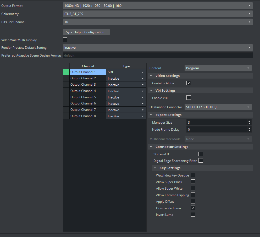

Video Output
  • HDR is supported in 1080p or higher.
  • Set the output colorimetry to HLG or S-Log3.
  • Use 10 bits per channel to avoid banding.
  • Enable Allow Super Black and Super White, to enable extended range video signals.

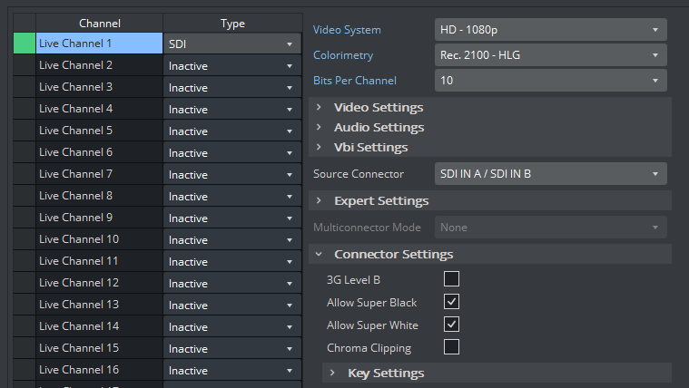

Live Inputs
  • Configure the resolution, frame rate, and colorimetry of the input signal.
  • It is recommended to use at least ten bits per channel.

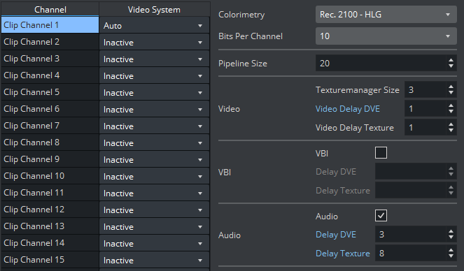

Clip inputs
Similar to live configuration, select the format and colorimetry of the clips that should be used in the channel. The Matrox clip player assumes that any loaded clip has the configured colorimetry, while VML uses the metadata of the clip. Using 10 bits per channel is recommended.
