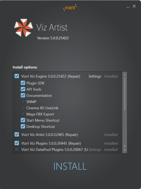

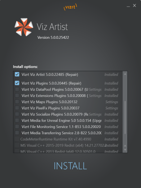

Run the installer. The bundle installer provides an overview of all required dependencies that need to be installed in addition to the main application. Already installed dependencies are listed as Installed. You can collapse the selection list by clicking Settings.
Note: The bundle installer selects most features by default. Check the feature list and add or remove features as required.
Scroll further down to select a custom installation location, if required.
Click INSTALL to complete the installation wizard. The various dependencies are installed as required.

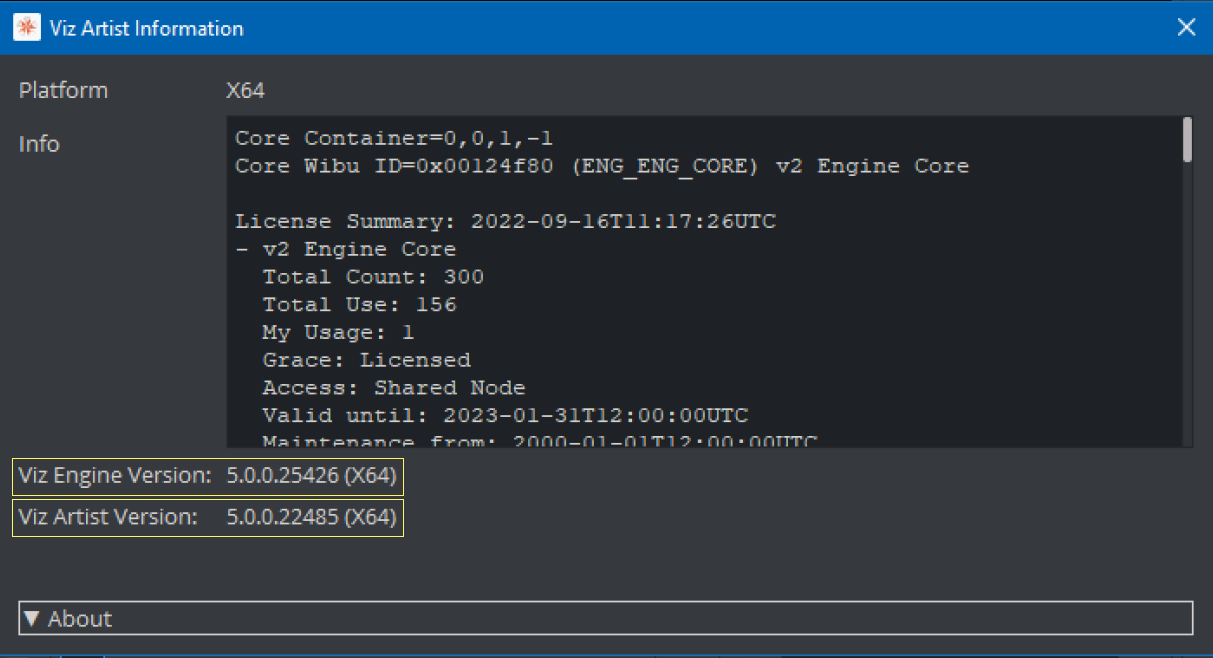

To Identify Installed Version
To check the installed version of Viz Artist and Viz Engine, click on the Viz Artist Information button:
In the Information window, the version numbers show as:
