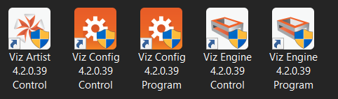

Create the necessary shortcuts similar to the examples in the table.
Shortcut Name | Shortcut Target Parameters |
Viz Artist Control |
Viz Config Control |
Viz Config Program |
Viz Engine Control |
Viz Engine Program |

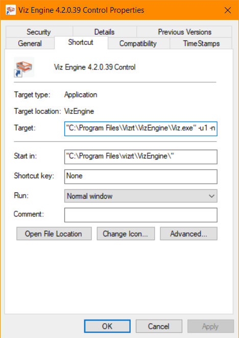

Make sure that all shortcuts have the field Start in: set to your Engine installation directory.
The picture shows an example for the Viz Engine Control shortcut.
