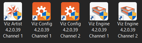

Create the necessary shortcuts according to the table.
Shortcut Name | Shortcut Target Parameters |
Viz Artist Channel 1 |
Viz Config Channel 1 |
Viz Config Channel 2 |
Viz Engine Channel 1 |
Viz Engine Channel 2 |
Note: Viz Artist can only operate on the first Viz Engine instance.

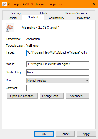

Make sure that all shortcuts have the field Start in: set to your Engine installation directory. The picture shows an example for the Viz Engine 4.2.0.39 Channel 1 shortcut.
