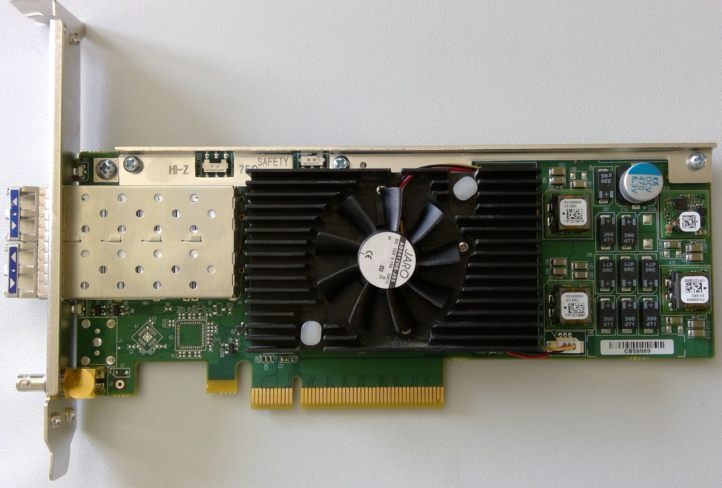

The Matrox X.mio3 IP video board was designed to help broadcast equipment manufacturers meet the challenges of the SDI to IP transition. It is a half-height, half-length PCIe card that offers multi-channel video I/O over 10 GbE with IP encapsulation of HD and 3G video. The card offers a total of four IP inputs and four IP outputs. The stream content conforms to the SMPTE ST 2110 specification. SMPTE ST 2022-7 is supported in both modes.
DSX LE 4 IP cards have the same capabilities as their X.mio3 counterparts, but lack an onboard video mixer, so DVE is not usable on those boards. Whenever X.mio3 IP is mentioned in this document, the same is true for DSX LE 4 IP.
The card contains two enhanced small form-factor pluggable (SFP+) slots, or "bays". In the lower bay is SFP A, and hosts input and output channels 1 through 4. The upper bay houses SFP B, which hosts all of the redundant channels used with SMPTE ST 2022-7. The board does not have any SDI inputs or outputs. There is one Mini-BNC connector used to connect the card to the house genlock signal. However, the card can also be locked to a SMPTE ST 2059 conform time signal, sent via the SFPs.
Be aware that SFPs come in two flavors:
  • Short range (SR, 850 nm), and
  • Long range (LR, 1310 nm).
In general, a cable may only connect two SFPs of the same type. In addition, please be aware that the SFP should not be constantly switched in and out of the X.mio3 IP card, as the warranty on the card may be voided if this occurs more than 40 times.
IMPORTANT! X.mio3 and DSX LE 4 boards must be installed in a PCIe Gen 4 or Gen 3 slot. The boards will not work in PCIe Gen 5 or higher slots.
Key Features
  • Dual SFP+ cages for a total of four video inputs and four video outputs.
  • IP (SMPTE ST 2059 PTP) and analog blackburst timing reference.
  • X.mio3 IP and DSX LE 4 are narrow senders as per SMPTE ST 2110-21.
  • Both cards are narrow receivers as per SMPTE ST 2110-21, and thus can only receive narrow flows.
  • Onboard multi-channel Up/Down/Cross scaler.
  • Onboard multi-layer compositor.
