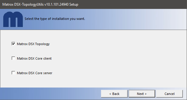

Open the downloaded DSX-TopologyUtils.exe file. This file automatically extracts the installation files and launches the installation wizard.
Select Matrox DSX Topology and follow the on screen instructions.

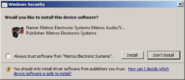

In case the Windows Security window pops up, tick the Always trust software from Matrox Electronic Systems check-box. This allows for a faster installation procedure in any subsequent driver installations. If left un-checked, each required driver needs explicit permission to be installed.
Click Install to start the installation. The installation can take several minutes.

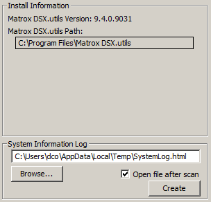

Click the Matrox system tray icon.
Select Open X.info.

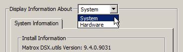

In the Display Information About drop-down, select System.
Check that the correct driver version was installed.

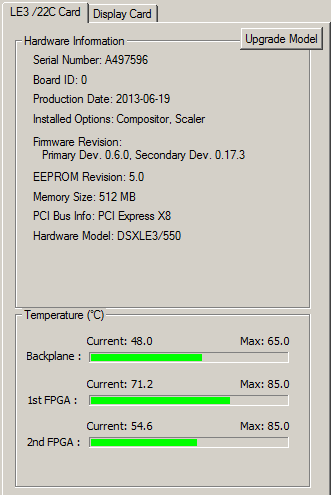

In the Display Information About drop-down, select Hardware and click on the installed card tab, for example LE3/22C.
Note: The information shown in the panel can look different depending on the installed Matrox card.
Check the these details:
Under Hardware Information, check the Installed Options for Compositor, to confirm that the board is taking advantage of the on-board compositor. Some boards do not have an on-board compositor. The Matrox X.mio2 Plus does have an on-board compositor, even though this is not listed.
See PCI Bus Info and check that the board was put into a PCIe slot operating at the right frequency.
See Hardware Model, for example, X.mio2 Plus 8500, to check for Mixed Mode Video Support.

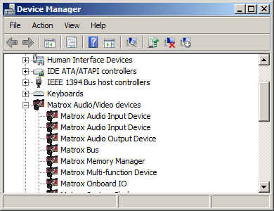

To Check the Installation with Windows Device Manager
Start the Device Manager, by either:
Click Start, then Run, and type
devmgmt.msc, orRight-click My Computer, select Manage and then Device Manager, or
Right-click My Computer, select Properties and click the Hardware tab, then click Device Manager, or
Run the command star
devmgmt.mscfrom the Command Prompt
Expand the Matrox Audio/Video devices node to see the devices that are installed.
