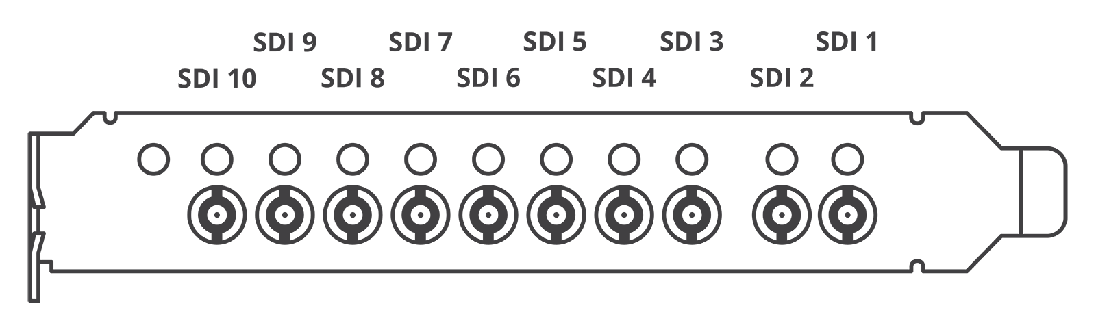

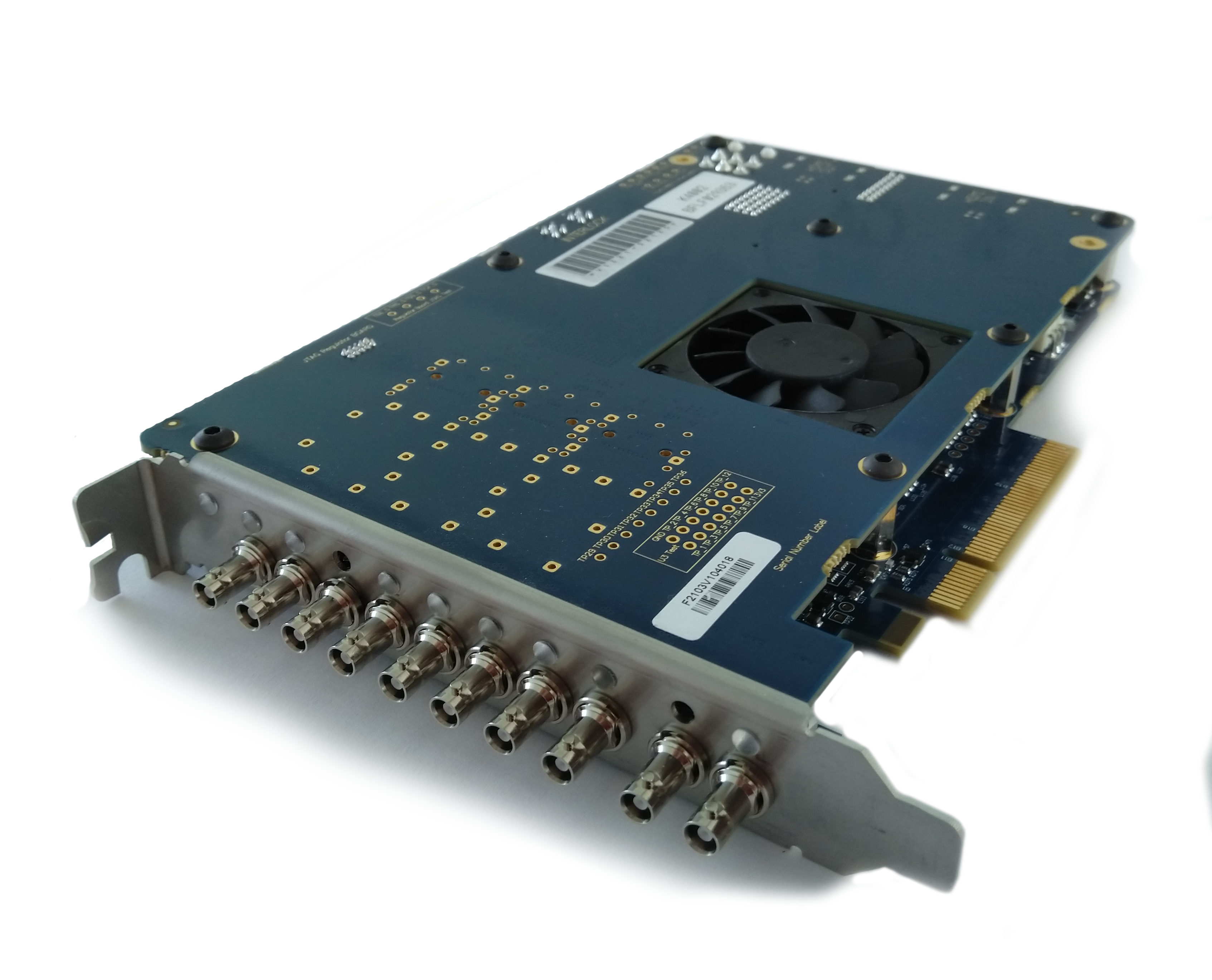

The Kronos K8 is a full-length PCIe card with ten HDBNC connectors. Eight of those are used for SDI IO, the other two are reference connectors. For use with Viz Engine, the card needs to be configured with four inputs and four outputs. The connectors support SD, HD 1.5G, 3G, ASI, AES and LTC as either input or output. In addition the card has a reference input and a reference output connector.
Kronos K8 Connectors
SDI Connector | Function |
1 | Reference In |
2 | Reference Out |
3 | Output Fill |
4 | Input 1 |
5 | Output Key |
6 | Input 2 |
7 | - |
8 | Input 3 |
9 | - |
10 | Input 4 |
