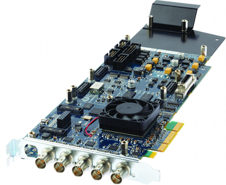

Viz Engine supports the following BlueFish444 video boards:
Epoch | 4K Supernova
Epoch | 4K Supernova S+
Epoch | Neutron (introduced in Viz version 3.7.0)
Kronos | K8 (introduced in Viz version 5.0.0)
