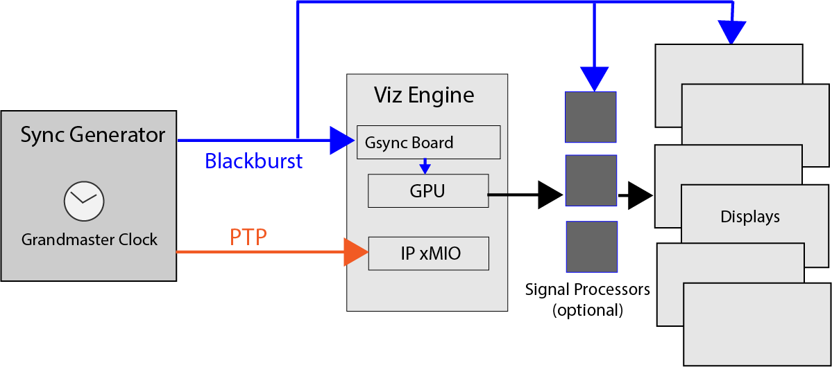

X.mio5 based topology boards do not have a genlock connector anymore, they only synced using PTP (older X.mio3 IP boards still have a Genlock connector). To correctly synchronize a videowall using X.mio5 boards, you need:
A valid PTP signal.
A blackburst signal to synchronize the NVIDIA gSync board.
A blackburst signal for any additional device (for example, Signal processors or the displays).
All of these signals need to be driven from the same source. Therefore, it is highly recommended to use a system generating PTP and Genlock sources from the same clock.
The following diagram illustrates a basic synchronization flow:
