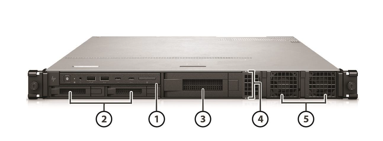

Connectors
Front Connectors
Front I/O module power button, 2 USB-A 3.1 G1, 2 USB-C 3.1 G2, Headset audio
2 x 2.5” external drive bays
Optional 1 x 3.5” or 2 x 2.5” drive bay
Locator LED
2 x external 675W PSU bays

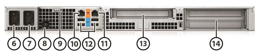

Back Connectors
6. Primary PSU connector
7. Secondary PSU connector
8. Rear power button
9. Padlock loop
10. 1GbE RJ-45 (AMT)
11. 1/2.5/5/10GbE RJ-45
12. 4x USB 3.1 G1 Type-A
13. Single Slot Riser (1 PCIe G3 x16)
14. Dual Slot Riser
1 x PCIe G3 x16*
1 xPCIe G3 x16 wired as x8
Info: Slot 2 runs at Gen3 x8 Speed, if Slot 3 is loaded.
