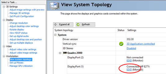

In the NVIDIA Control Panel, expand the Workstation section of the Select a Task... menu and click View system topology:
Click the EDID link on one monitor, and select the Load tab.

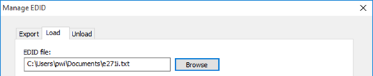

Click the Browse button and select the EDID file to be loaded. This file is usually included on the CD or DVD containing drivers, utilities and documentation for the display. If not, please contact the display manufacturer to obtain the required file.
In the Select Connector to force EDID panel, check all connected displays, then click Load EDID.

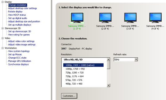

Enter the Change resolution section of the NVIDIA control panel.
In the first section, Select the display you would like to change, select display number 1 and click the Customize... button:

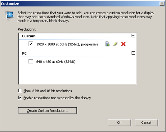

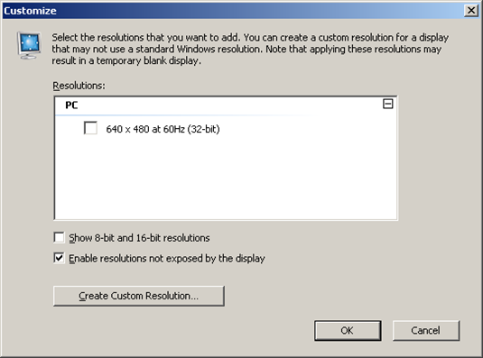

In the upcoming dialog, tick the Enable resolutions not exposed by the display check box, and click Create Custom Resolution....

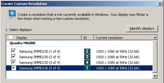

Select all displays in the upcoming dialog:

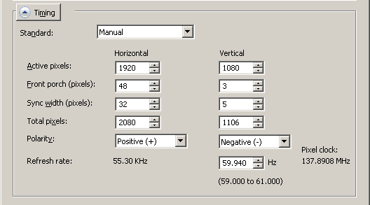

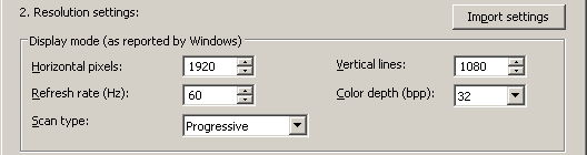

Enter a Refresh rate (Hz) of
60Hz and leave all other settings to their default values:In the Timing panel, select
Manualtiming adjustment from the Standard drop-down list. Set the Refresh rate to59.940Hz, and leave all other settings to their respective default values:Click the Test button. The connected monitors might go black for several seconds while adjusting to the new refresh rate. Do not press any key on the keyboard or buttons on the mouse while this goes on. When the screens returns to normal, acknowledge the new settings by pressing Yes in the upcoming dialog.
The newly created resolution now shows up as illustrated below and has been applied to all displays.
