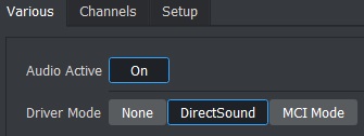

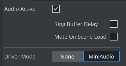

  • Audio Active: Toggles audio in Viz Engine on/off.
On videoboard enabled system the following settings are also available:
  • Ring Buffer Delay: Makes the audio system compensate for the ringbuffer delay during clip playout. Ringbuffer is ignored when disabled.
  • Mute On Scene Load: Mutes audio before any scene load commands are executed when set to On. This is necessary for video cards which do not mute the audio automatically, or when no video refresh happens.
Note: Additional commands to mute audio can be added in the Viz Config file.
  • Driver Mode: Affects playback of sound on the computer running Viz Engine, for audio monitoring purposes.
    • None: Prohibits Viz Engine from playing out sound on the local system.
    • MiniAudio: Default OS Audio mode.

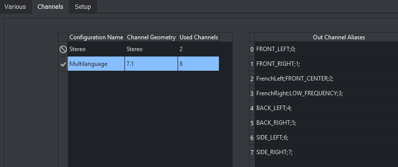

Channels Tab
  • Configurations: Shows a list of channel configurations.
  • Add: Adds a new channel configuration to the Configurations list.
  • Delete: Deletes the selected channel configuration from the Configurations list.
  • Name: Sets the name of the selected channel configuration.
  • Channel Geometry: Sets the channel geometry. Options are:
    • Mono
    • Stereo
    • 5.1
    • 7.1
    • Quad
  • Used Channels: Sets the number of configurable channel alias fields that can be mixed by the internal channels in Viz Engine (software). On a Matrox system this number must be equal to the number of configured input channels (hardware). This setting is independent of the Channel Geometry setting.
  • Reset Aliases: Sets the channel aliases to the default option (the custom entry is not removed).
  • Out Channel 0-15: The Out Channels represent the internal Viz audio channels, which are mixed to the output device one by one. Alias names are useful to create multilingual systems, and also to define the channel geometry for the Default and FX audio clip mix modes. Aliases are separated by a semicolon. The Audio plug-in only uses the channel aliases to find the correct speakers for Pan and 3D sound effects in FX mode. With this functionality any of the 16 internal audio channels can be used to play any audio geometry.

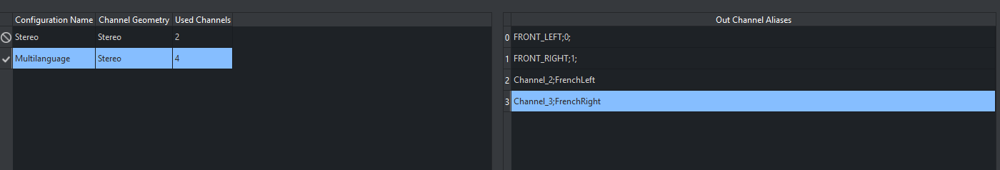

To Add Multi-language Audio Channels
  1. From the Channels tab, click Insert.
  2. Enter the new name in the Name field.
  3. Set the Channel Geometry to Stereo.
  4. Set the number of Used Channels to, for example, 4
  5. In the Channel 2 field, add the alias FrenchLeft.
  6. In the Channel 3 field, add the alias FrenchRight. Add the same configuration for English (EnglishLeft, EnglishRight) and German (GermanLeft, GermanRight) on the other machines.
  7. Click Save.

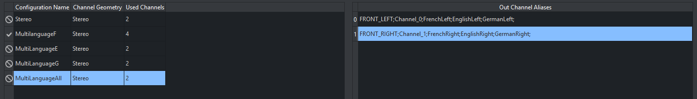

To Add Multiple Audio Channel Configurations
  1. Repeat To Add Multi-language Audio Channels to add three more Multi-language Audio Channels.
    Name the configurations the following way:
    • Multi-languageF
    • Multi-languageE
    • Multi-languageG
  2. Add a Multi-languageAll configuration.
  3. In the Channel 1 field, add the aliases FrenchLeft, EnglishLeft and GermanLeft.
    FRONT_LEFT;
    Channel_0;FrenchLeft;EnglishLeft;GermanLeft;
    FRONT_RIGHT;
    Channel_0;FrenchRight;EnglishRight;GermanRight;
  4. In the Channel 2 field, add the aliases FrenchRightEnglishRight and GermanRight.
  5. Click Save.

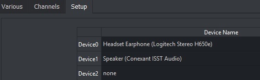

Setup Tab
The Setup tab lists all available audio devices available to the Viz Engine audio mixer (see Audio in Viz). All devices listed with Device0 are DirectSound compatible devices installed on the system. Device0 is always the default playback device, configurable through Sound options in the Windows system Control Panel.

  • Device n : Shows the name of the audio card.
