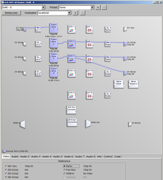

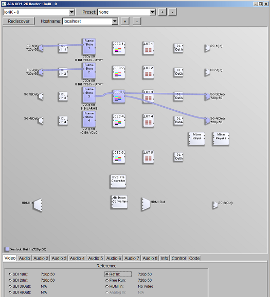

cables.exe: This utility shows the current topology running: Inputs, outputs, color space conversion, fill and key paths. Firmware and driver version information are also accessible. Screen-shots of cables.exe use showing two typical topologies (two video inputs and one video and one preview) are shown below:
Example: Topology using two video inputs:
Example: One video input, one preview:
