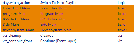

  1. Click the Actions menu on the Main Menu.
  2. Select Ticker > Import.
  3. Select the file to import and click Open.
    Ticker actions are displayed in the left pane.
IMPORTANT! The Ticker actions that are read from the imported Ticker XML-file need to include ON or OFF (capital or lowercase will both work) in the ticker button name for the action to be imported correctly. For example, ticker buttons named All ON, All off and Command ON will all import correctly, while buttons named Engine IN or Engine OUT will not import correctly.

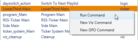

To manually play tickers
  1. Select your channel.
  2. Click the Actions button.
  3. Right-click the command you want to play and select Run Command.
